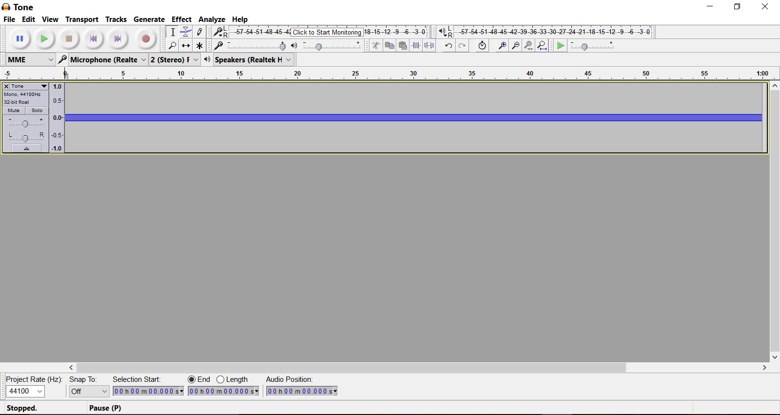

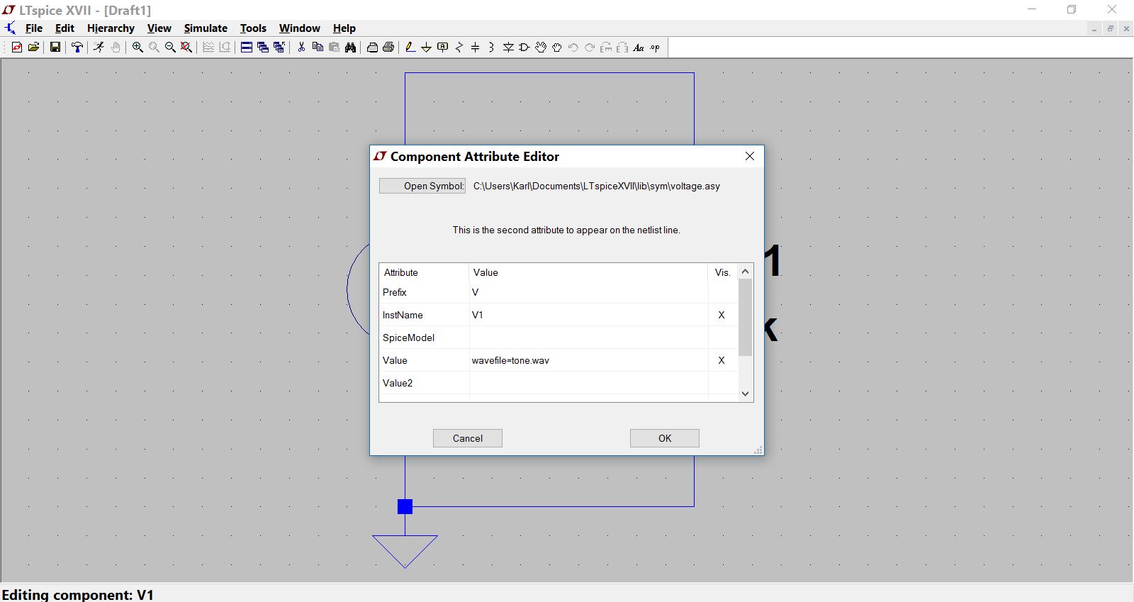

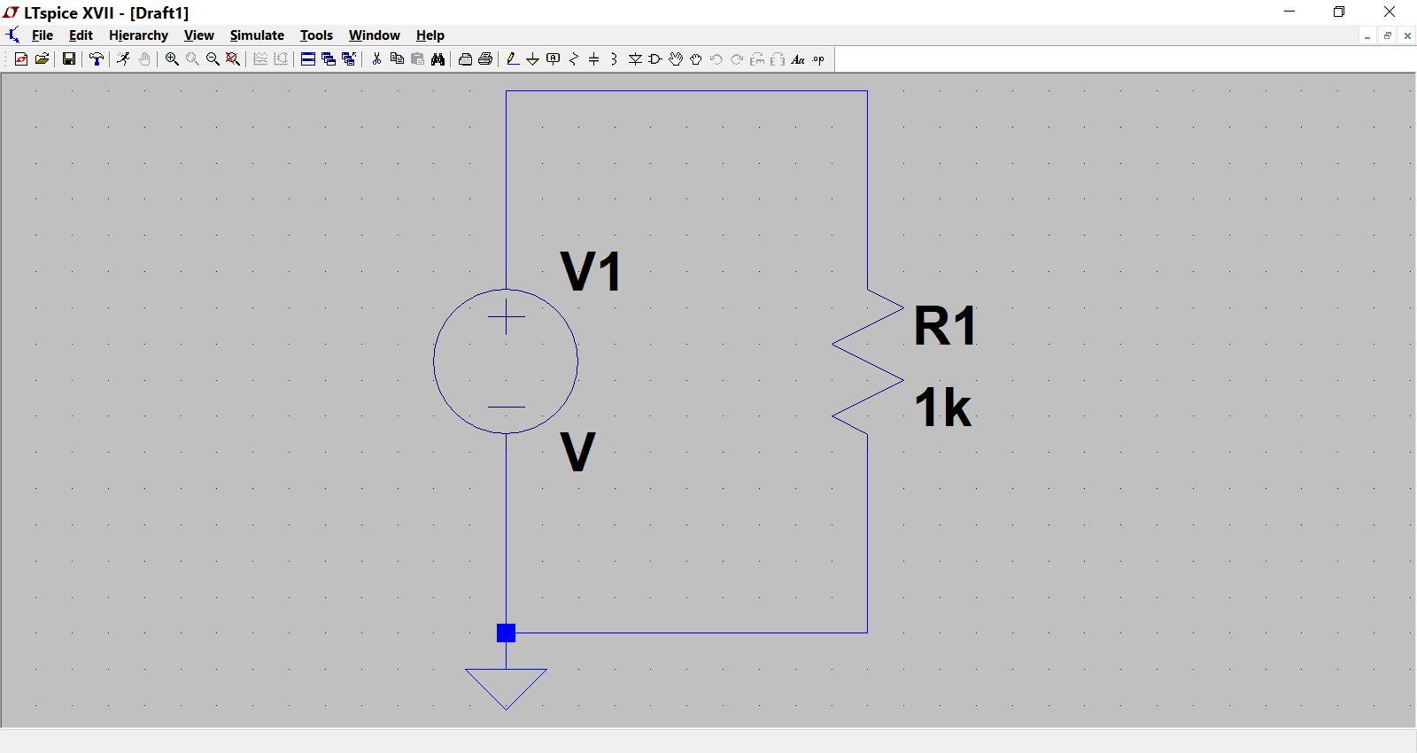

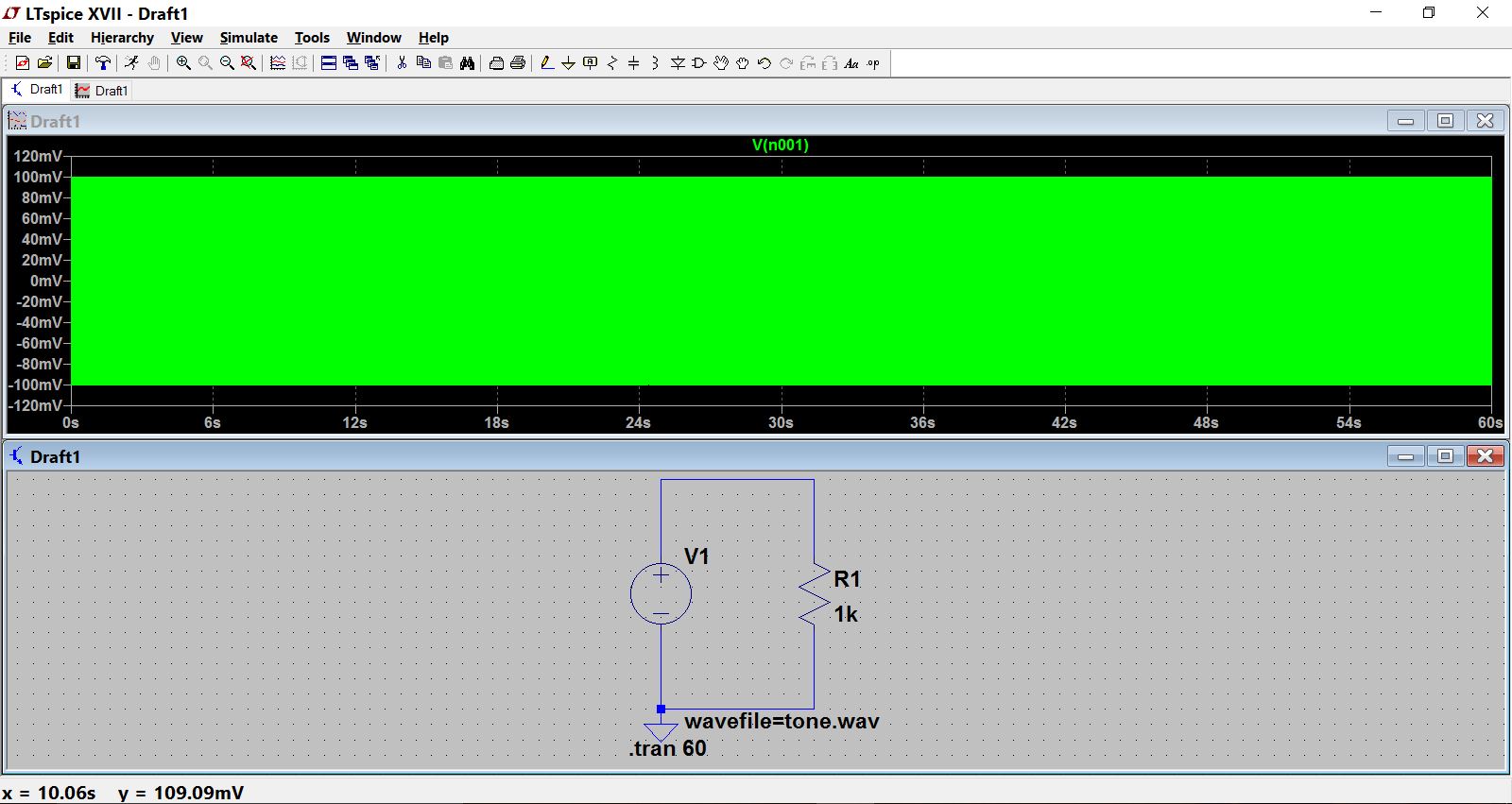

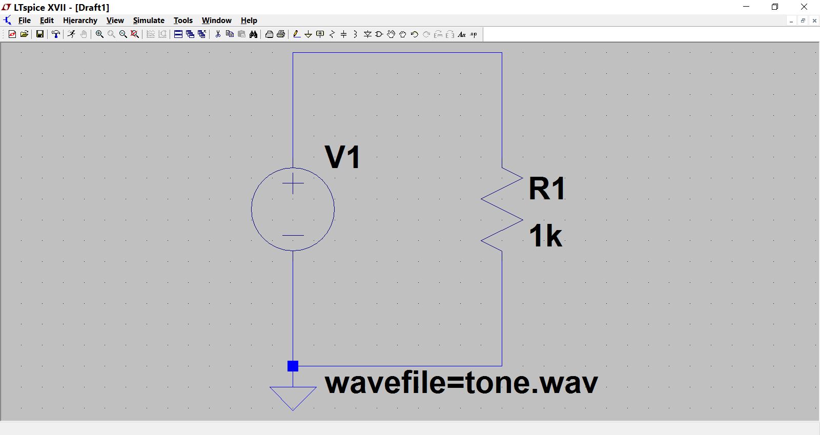

Problems trying to use .wav files or PWL files.
This is something I have never tried before and tbh the problems I seem to be having made me wonder if anyone has any practical experience of all this.
I've followed the LT tutorial on using wave files as a signal source and found I had mixed results in that it either worked straight off or 'froze' with an 'initializing matrix' message.
So the circuit is as simple as possible consisting of a voltage source and a 1k load.
The .wav file is a 60 second mono track of a sine wave created in Audacity, the audio exported as a .wav Microsoft Signed 16 bit 44.1kHz file. Standard stuff.
I hold down 'CTRL' and right click the voltage source adding the .wav file.
When I run the sim it all works. Yea
The problem is that if I add any complications to the .wav file (such as a fade in or a few seconds silence) then the sim appears not to run, I just get the initializing matrix message. The LT example shows a complex music waveform being added with no issues so I'm a little lost at this point why the slightly altered wav file wont run.
The Audacity screenshot just shows confirmation of the single tone. It when I alter this that LT will not run, for example by adding a fade in at the start or silence part way through.
