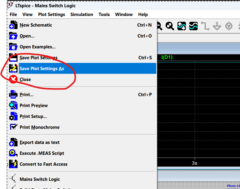

Do you mean saving the 'plot settings'?
Click the graph tab to bring it into focus and a new set of options appear when you go to save the file.
Administrator
Joined 2007
It doesn't work here, but maybe because I save the .raw files separate from the project folder.
I'll play a bit with it.
Thanks for the hint.
Jan
Try saving the Plot Settings first, save them under the same name as the .asc and then save the sim and all must be in the same folder. You should end up with the .asc, the .raw, the .plt and the .net file all together in the same place.
