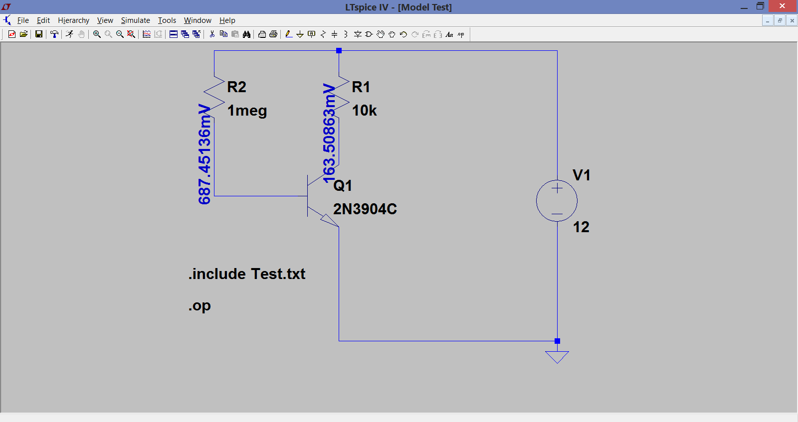

The first line of your Cordell models file looks like this:
Cordell Models - 04/20/2011
It's missing the * in front to indicate it as a remark line, and the rest of the file won't be parsed following this error.

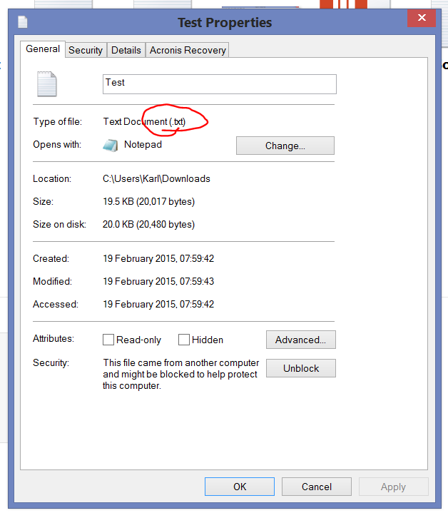

This is Alans text model file. I renamed it Test just get rid of the long file name the forum puts on it.
And it works. Make sure your model file really is a .txt by right clicking it and checking the file extension.

LTspice throws up
Code:
Error on line 616 : cordell models - 04/20/2011
Unknown parameter "/20/2011"
WARNING: Node MODELS is floating.
WARNING: Node - is floating.
WARNING: Less than two connections to node MODELS. This node is used by CORDELL.
WARNING: Less than two connections to node -. This node is used by CORDELL.
Direct Newton iteration for .op point succeeded.
Singular matrix: Check node models
Iteration No. 1
Fatal Error: Singular matrix: check node models
Iteration No. 1

Yes you are right. I dropped Alans file into a more complex sim and I see the error you posted.
I added that and it does indeed run perfectly.

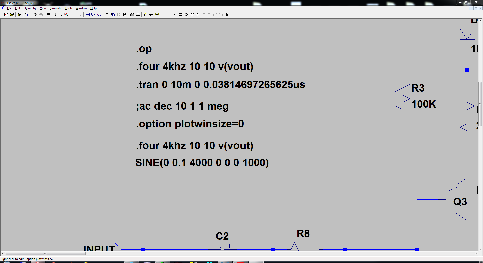

Thanks for your post. I am no expert, but I sure learn enough to add models and run FFT. That's about all I need for the moment. Only thing I would like is to make it faster and still give the same resolution. In order to get narrow and accurate peak, I have to run 50 cycles with fine steps. I have to use 0.005uS for 1KHz and 0.0005uS for 20KHz. Takes two hours to run one FFT simulation.

If a sim is taking hours to run then something is wrong and its struggling to find the operating point or whatever. Sometimes even adding something like a 10 or 100meg resistor from some node to ground etc can instantly fix it and allow it to run.
Very sim specific.
If you want to run a long FFT and the laptop is struggling heat wise then set up a power plan (such as the battery power saver one) that holds the processor at say 40% of max. Takes longer to run but keeps cool. Or make a custom power plan just for LT.

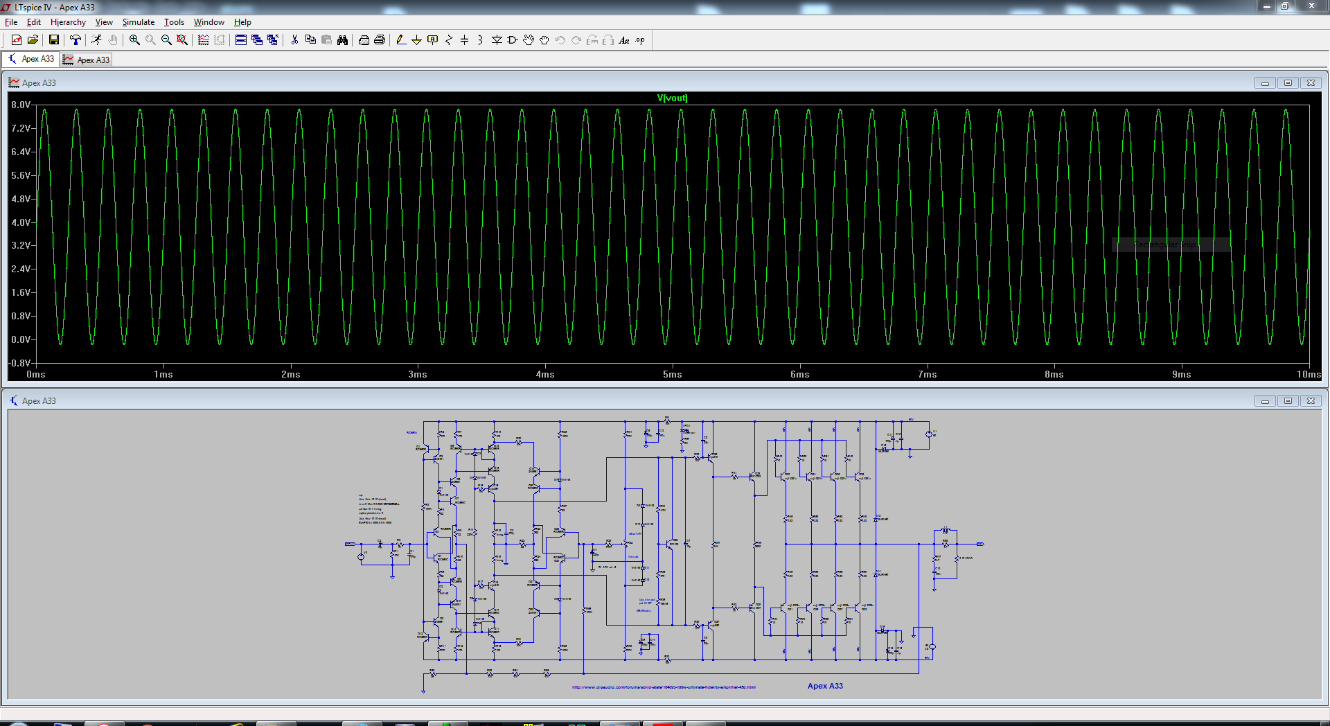

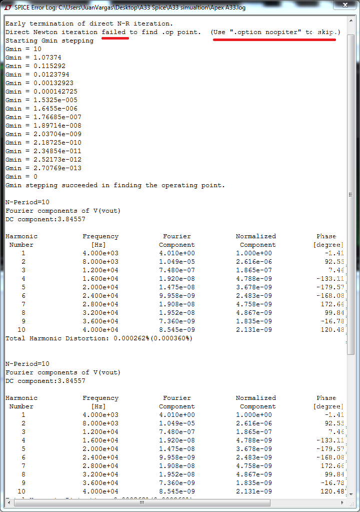

Hello Mooly
I was fallowing your tutorials and it came out this line "
Direct Newton iteration failed to find .op point. (Use '.option noopier" to skip.)
I'm not sure what I did wrong the THD is completed but I'm not sure if the result
is correct, here are some images.

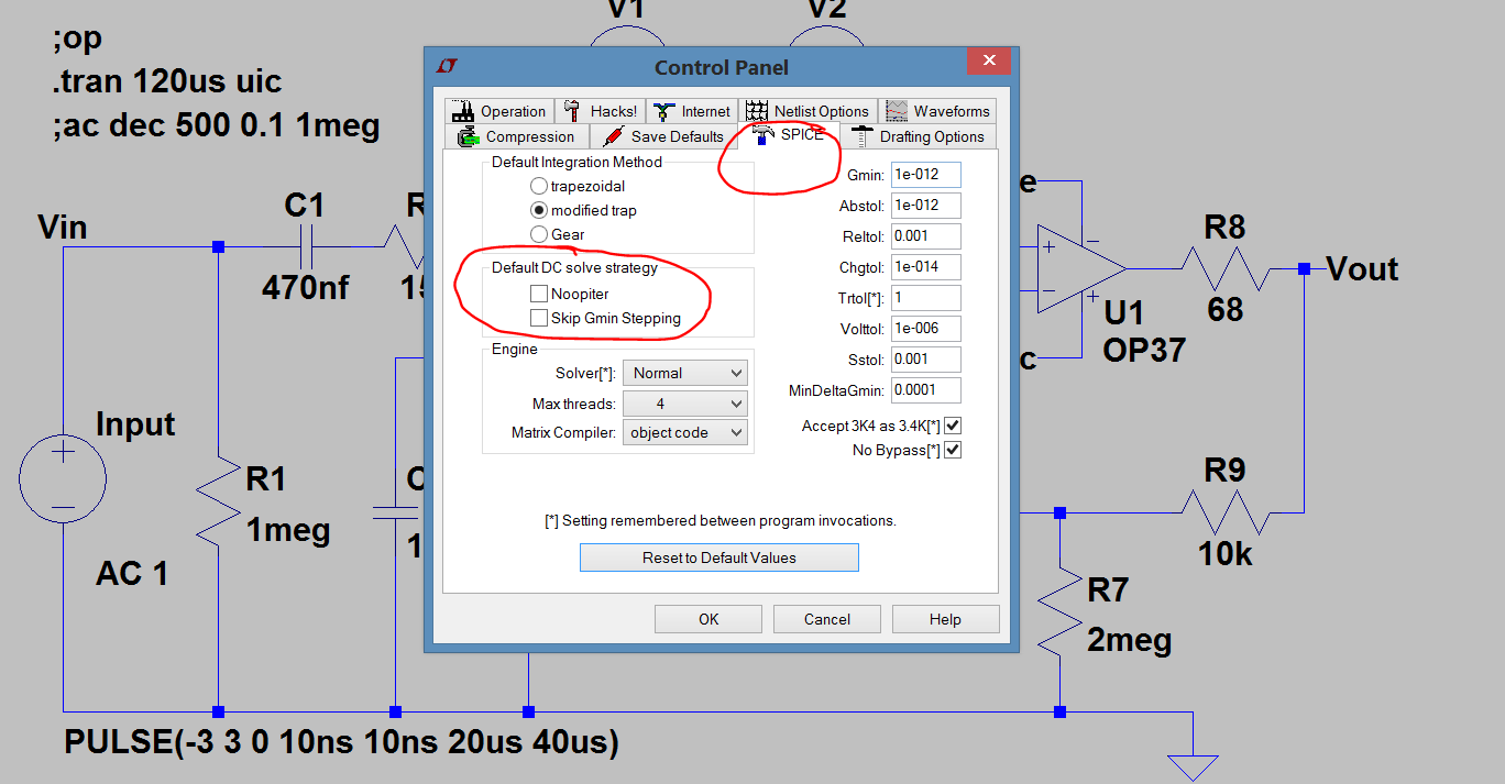

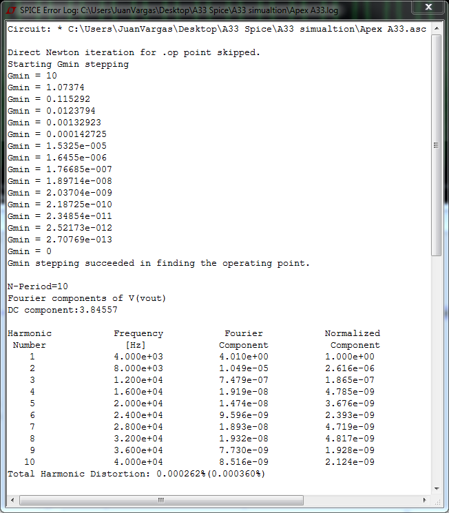

There is no problem. What has happened is that LT failed to find the operating point using the easy method and so had to default to another to solve problem.
If that happens then you can add as a directive (top right on the toolbar) .option noopiter which will stop it attempting and failing and having to try something else. It saves a few moments in the run time, that's all.
You can also add it as a default in LT's control panel.
