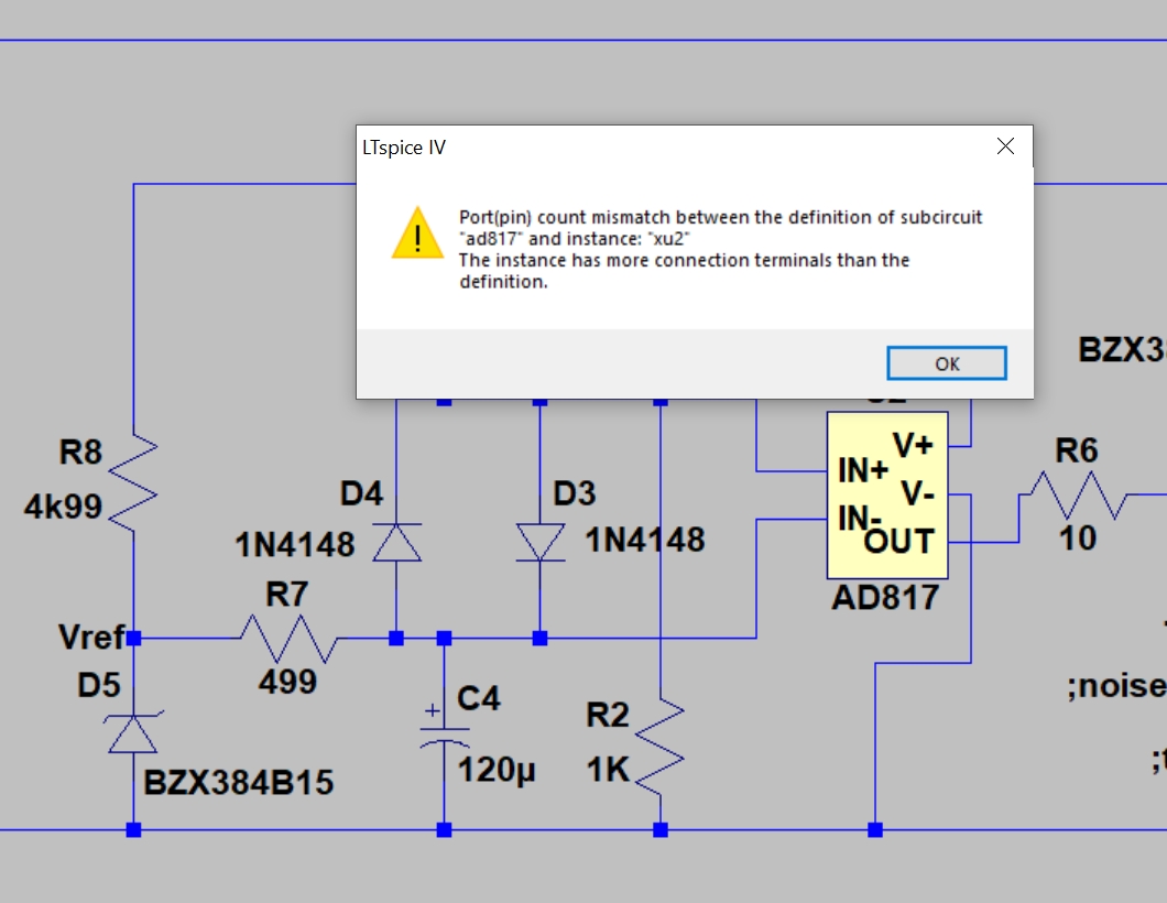

Just for you to know, I followed the AD tutorial and got to an asy file, that I filed.
But when I wanted to run it I got this message.
Is there a way to convert that square into a standard opamp triangular image?
Why hung up on the shape? Follow the tutorial and get it working.
Then afterwards, if you have a lot of time, you can open the .asy and change the shape all you want. It has absolutely no effect on the simulation of course.
BTW You are still on the very old LTspice IV, so some things may be different from the latest version most of us use.

I think you are making this too hard. LTspice IV has a built-in generic op amp symbol that can be use with your AD817 model. It's in the Opamps folder named opamp2, and it is triangular shaped. After inserting the symbol into your schematic, change the instance name from opamp2 to AD817.
As Jan said, you can always create a symbol that you like later. For now, it's best to use something that is known to work.

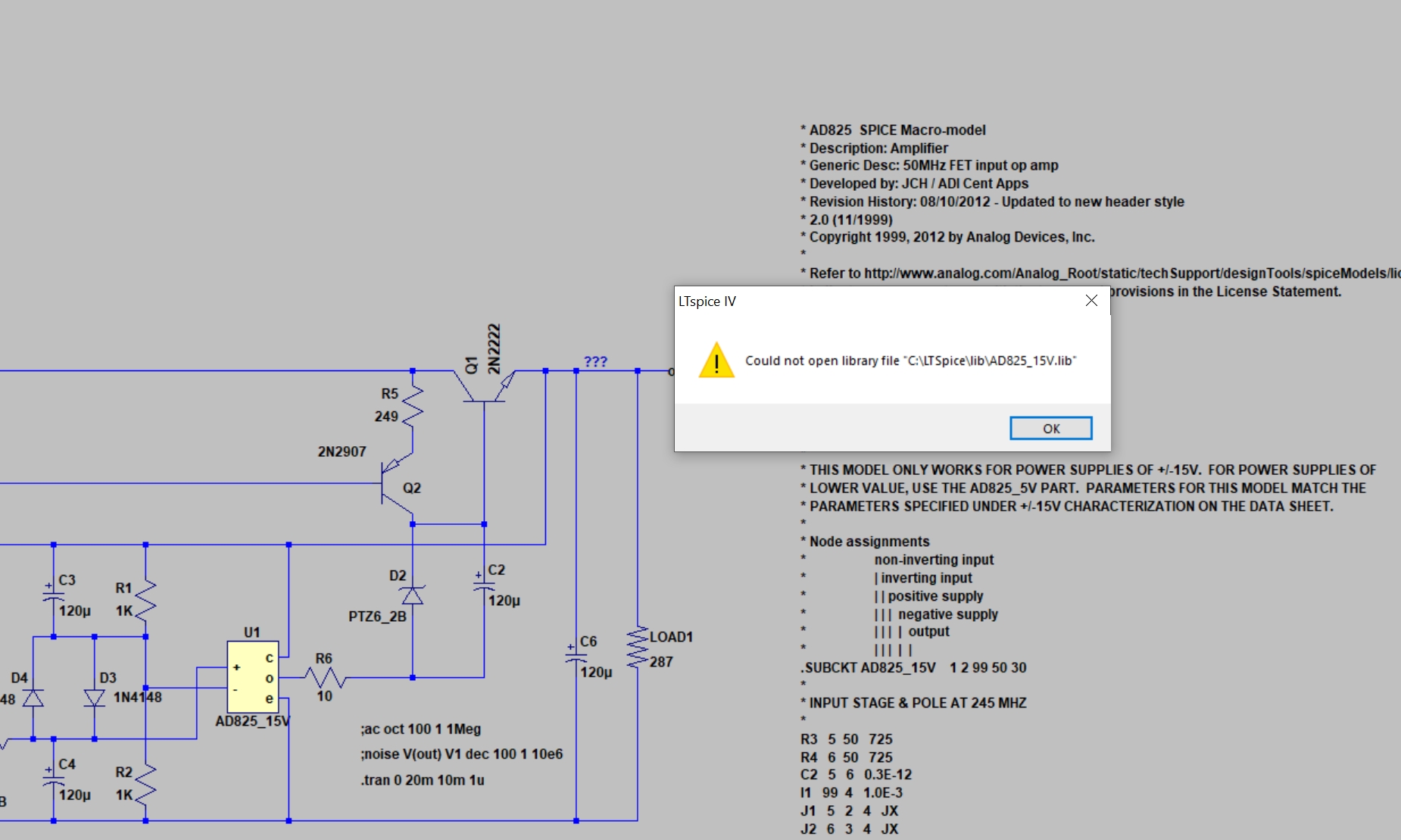

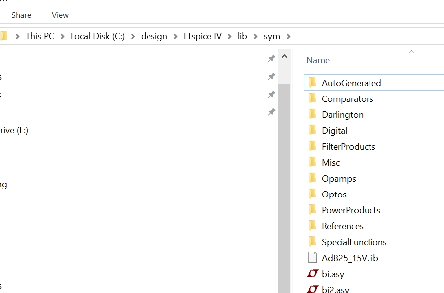

Sorry, but LTSpice continues not to find the .lib file, even I can see it there, in that place listed.
No clue on how to make it see the file that already is there.
It's not clear what .lib file you are referring to. I tested the built-in opamp2 symbol along with the subcircuit in post #2320 and it worked fine. Maybe if you post your actual .asc file someone can determine what is wrong. The images in your posts #2321 and #2328 don't tell us a lot.
One thing that jumped out immediately is that the .asc file contains no .inc or .lib directives nor any embedded models. These directives are the normal way to include models, subcircuits, and libraries in a simulation file. But with no explicit .inc or .lib directive, the only way I can see that LTspice even knows about your library file is that it must be referenced in the custom opamp symbol. This really isn't a good practice (IMO).
Based only on what you've provided, I would suggest replacing your custom symbol file with the built-in opamp2 symbol, as I recommended before, and adding a .lib directive to tell LTspice where to find the library file (and I would not store a library file in a symbol folder). Simply locating a library file in a certain folder isn't going to ensure that LTspice will be able to process it. In particular, LTspice expects to see .asy file extensions in its symbol folders so it doesn't know what to do with your Ad825_15v.lib file and just skips over it.
To make any sense of this you will need to upload both the library file and the symbol file. Note that the diyAudio forum doesn't allow uploading .asy files so give the symbol file a .txt extension; it will need to be renamed to an .asy file to run the simulation.

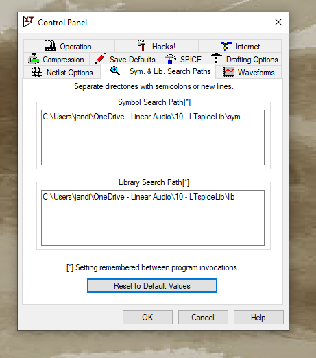

For LTspice there is no reason to put models and subcircuits on the schematic. I am using my own directory for symbols and library files which of course never gets overwritten.
I put the path to those files in LTspice on Tools|Control Panel|Sim & Lib search paths , see attached. You can use any number of folders and search paths as you like.
The only reason to clutter the schematic with model stuff is to make the schematic portable between people. If you send the .asc to someone, the receiver most probably has his own folder system, and by putting models on the schematic, LTspice has them right there.
I should also mention that ALL the problems discussed here are clearly described in the Help file.
