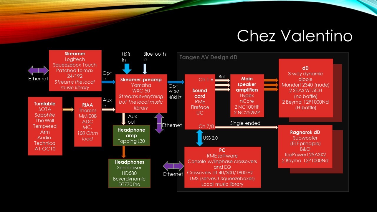

More than 11 years later, the system is still playing.
Filters are now 2-pole linear phase with some extra boosts and suctions here and there to get things right.
Main amplifiers are changed to Hypex nCore. Two IcePower250ASX2 have failed, and I decided to splash out when the second one went.
Also to make tings easier and more modern I've put in one of those nice small Yamaha streamer-preamps as the daily control center for the whole shebang:
