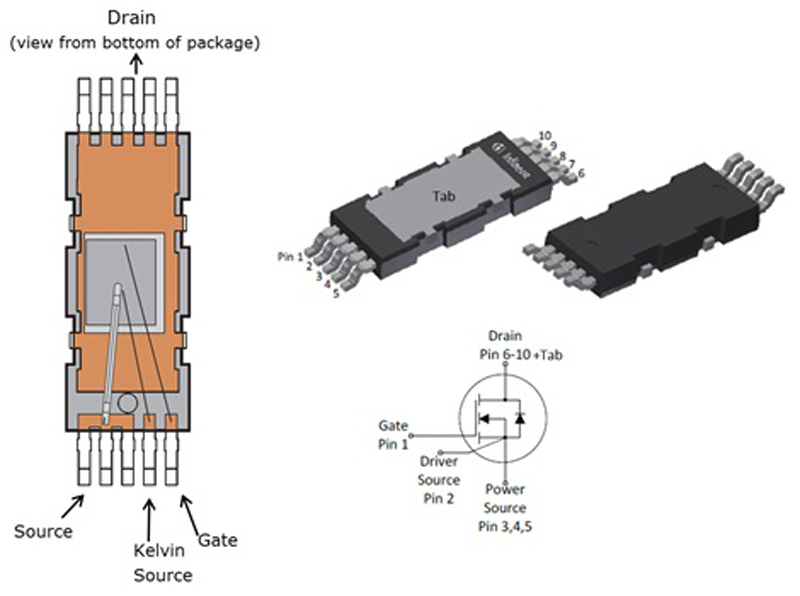

The new DDPAK from Infineon: Power Systems Design (PSD) Information to Power Your Designs
- Claiming half the inductance of TO-220 for a package with more loop length. What inductance were they considering?
- Claiming higher thermal conductivity than TO-220 for a package with half of heat transfer area and less thermal mass.
- Claiming the suppression of one manufacturing step that is needed anyways (bottom side selective soldering for thru-hole parts) in attempt to compete with other countries' economy, whose tricks are cheap labor, finding conditions for workers to be happy with less expense, and more manufacturing steps to prevent unemployment or excessive expansion of non-technically-competitive sectors (which happens to be the same).
- Claiming reduction of distance from PCB to heatsink is good for power supplies, while it prevents mounting (always taller) diode bridges to heatsink, it prevents using (always taller) Reinforced Insulation optocouplers on bottom side of PCB, it mandates the usage of a custom cut insulation sheet between PCB and heatsink for off-line applications.

I've seen this package used in micro inverters.
I think eva is saying that Infineon are needlessly reinventing the wheel and its causing quite a few issues. Reinventing the wheel is like the oscillation in a circuit they must reinvent things to remain innovative, keep people in jobs, create pollution and waste. etc.
I couldn't agree more with that viewpoint if my viewpoint is correct.

A range of new SMD packages, intended for not using the PCB as the heatsink, are required. I have often run into applications that benefit from these packages.
But that "DDPAK" is not that well executed. Inductance is not better than TO-220. That project has not been checked by a true high speed switching designer. Half of drain and source connections should be at the same side of the package.

Often, as with the SMD packages I designed, a specific application is known in advance and a unique package is made for it. Designing a new package comes down to the usual two main criteria, need for something new, and cost savings X expected sales volume. The sales volume thing is the MAIN driver in today's market, and the reason why many low volume parts are dying off today. If a new semiconductor component doesn't find a million part per year socket within a year of so, it will go away.
Ours were low source inductance packages for 100 MHz to 1GHz radio transmitters. The LDMOS die had the source terminal as the substrate which was bonded directly to the lid / heat sink. Then the remainder of the package was built upside down. Wirebonds were used for the gate and drain terminals which were routed to SMD pads for the PC board. Our needs were unique, the sales volumes were very low by todays standards (50K/yr) but the profit per unit was very high, so we HAD to design our own SMD packaging. Nobody in the business would do it.
Solderable by the usual automated SMD processes, but some pick and place machines may not like the offset design.
