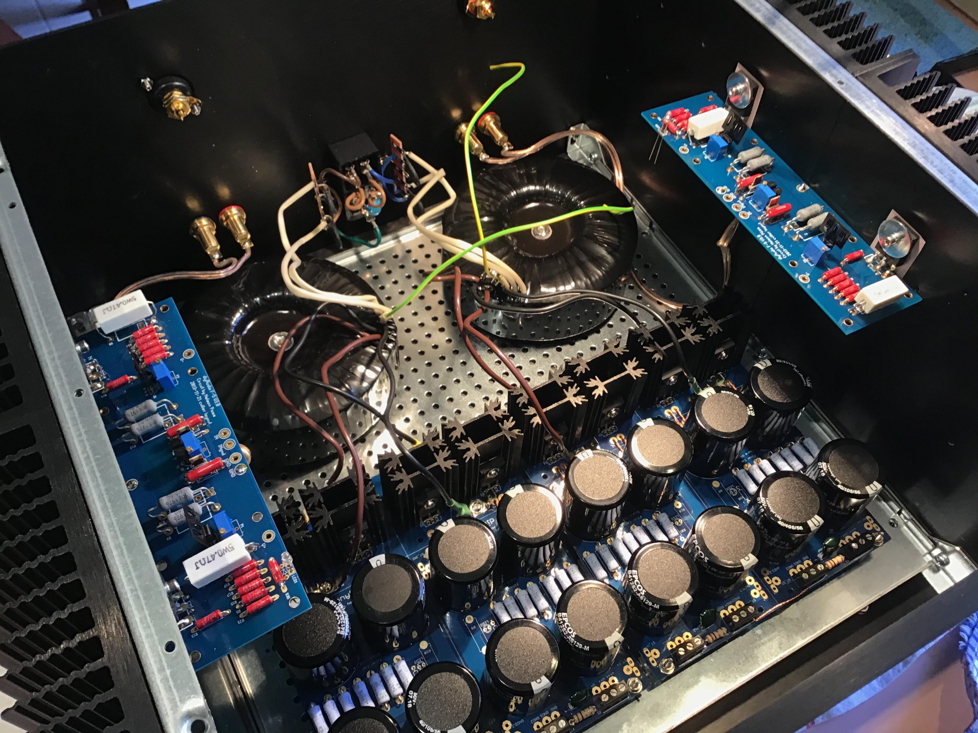

I have built a F5 turbo for another with purchases from the Diyaudio shop. Higher quality components and matched jFETs We’re used. But I can’t get the amp brds to bias.
Using a variac with only 40VAC going into the amp for 2.65VDC on the brds the 0.47 resistors have 1V across them. It doesn’t matter which of the two trim pots (10 turn) are on full anti-clock or fully clockwise turned in any or all combinations the bias doesn’t change. Also there is 0.33V DC offset stress the speaker posts. The resistors are slightly warm.
I have checked all components resistors and jFETs a number of times and all appear to be correct. At assembly each component was quad checked against the schematic at assembly.
Any clues why I cannot bias off the power FETs. They appear to be fully on and conducting? Anyone else experienced this?
See above for the voltages DC and AC.
Read above to see my problems with my F5 turbo. I sent the brds. off to an interstate friend who has built many more class A SS amps than me. Also he has a pro. desoldering station. He removed the driver trannies and deemed them the right ones in the right place. But when he pulled the power FETs he said they were the wrong ones. I checked them at least a dozen times and would bet my life on the fact I had them right.
He claims according to the markings you would think they were correct and in the right place. Only when placed on a smart meter did it show I had them the wrong way round. Brds. have been re-assembled and he is going to test them over the weekend.
I’ll update this thread when they return.

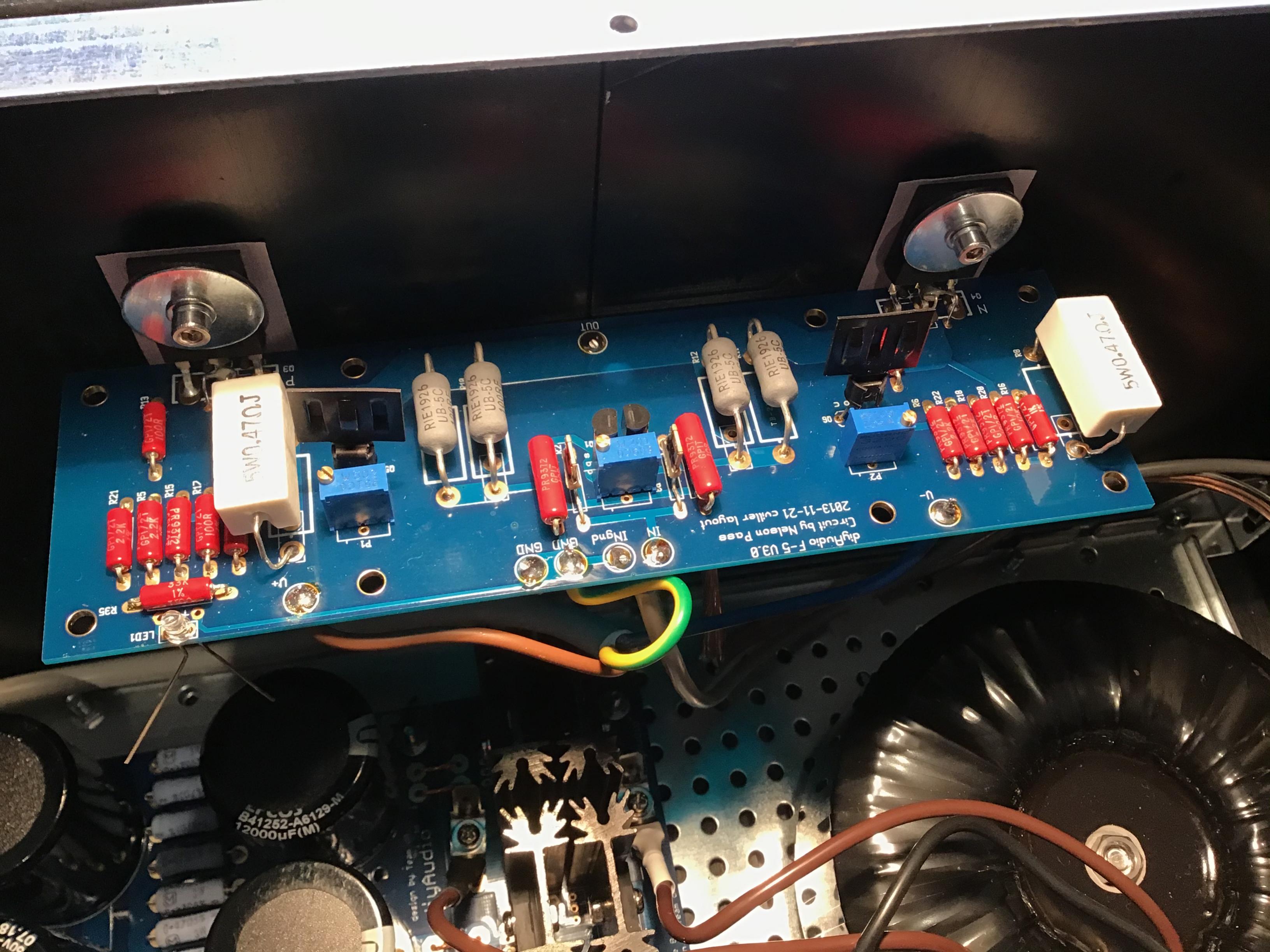

I have a quick question (I hope) about biasing...
I have both R/L channels fluctuating around 0mV and am currently targeting 550mV measured at the resistors. On the left channel, I have the pots set so the measured values are -549mV and 551mV, meaning there is roughly a 2mV spread measured at the resistors to achieve 0mV at the output. On the right channel, The pots are set so the measured values are -545mV and 555mV with 0mV, which is roughly a 10mV spread.
In both cases the average voltage is 550mV, and I may leave it at that bias setting. I don't imagine the variance in spreads is going to be too much of an issue, but the v2 guide says if you have decently specced parts (I used the F5 parts kit from DiyAudioStore), then the + and - voltages for each channel should be equal when measuring 0mV at the output.
So which components on the amp boards would account for the voltage spread seen on my R channel? The output resistors? FETs? Something else? And is it worth trying to do better than this by swapping something out?
Thanks in advance!
What about variation in the 0.47ohm resistors?
That was my initial guess since that's what I'm measuring the voltage access. It would be nice to be able to measure them without removing them from the circuit, but that's probably not going to be very accurate. Then again, maybe whatever I measure with them in circuit could be telling... I'll give it a shot tomorrow.
I measured the output resistors in circuit, which I know isn't very useful because other parts will be contributing to the measurement, but all 4 measured the same, fluctuating between 0.54 and 0.55.
I can try lifting one leg from each to get an exact measurement, but there would seem to be many other possible causes -- R5, 6, 15-18, 21, 22, etc. Also thermistors.
Is this worth chasing down or is it fine to have ~2% voltage difference in one channel between R7 and R8 when output is 0mV?
Thanks in advance!
I personally would be ok with that difference.
Yeah, I think I will leave it alone. I managed to lift a leg on each of the four 0.47 3W (5%) resistors to check and they showed 0.53Ω, 0.54Ω, 0.55Ω and 0.56Ω isolated from the rest of the circuit. The two lower were on one channel and the two higher on the other, so it doesn't seem like these are the cause of the discrepancy anyway.
