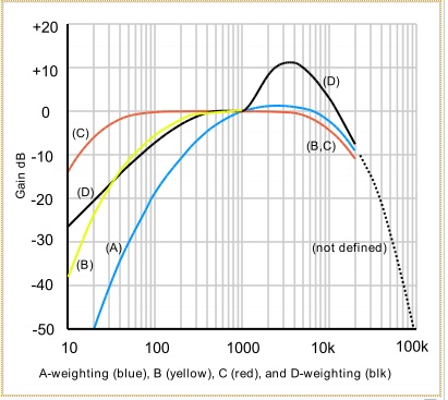

Blizzardbuffalo,The problem that I see, is that for infrasonics to be heard you are talking about decibel levels above the levels for permanent hearing damage. At 20Hz you need 84db, which is almost on the edge of the base accepted level of 85db (at any audible frequency) for the start of permenant hearing damage over a period of time.
For a frame of reference, the European Union mandates that any work place where noise levels go above 80db must provide hearing protection.
You have overlooked that the acceptable levels for hearing damage are measured using the dBA scale, which rolls off in response below 1000 Hz.
It takes 130 dB SPL to read 80 dBA at 20 Hz.
Upper frequencies, in particular those centered around 4000 Hz where hearing is most sensitive, cause damage at far lower levels than low frequencies.
If that were not the case, we would be deafened from closing car doors, which are on the order of 130 dB SPL at very low frequencies inside the cabin.

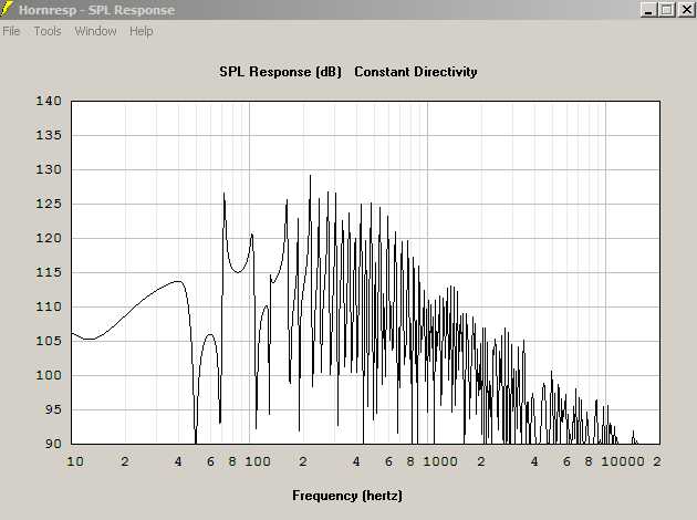

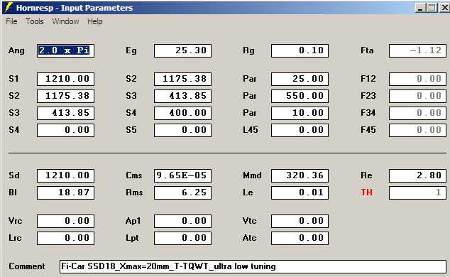

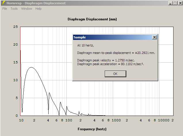

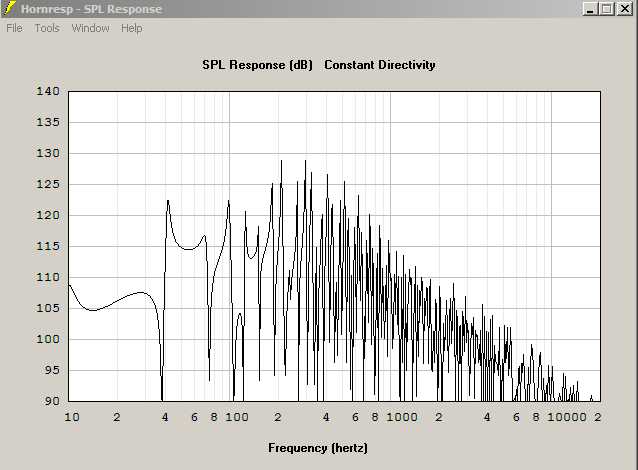

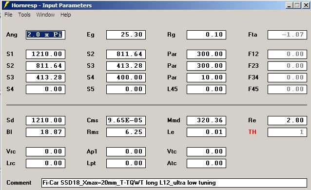

Hi Rive,
Maybe one of bjorno's favorite quarter wave resonators (T-TQWT), they tend to be smaller than tapped horns (TH).
I'll attach some Hornresp Input screens to get you started. Enter into Hornresp, and use the Wizard to mess around with this.
Blizzardbuffalo,
Art
It depends on who you ask, in Australia the guidelines for industrial relations related legal limits are in dB(A), however all the general government guidelines state 85dB. In the US the CDC uses dB instead of dB(A) with it's guidelines for preventing hearing loss, as does the US department of Labor. If they are using a weighting scale, they do not mention it.
As for car doors slamming, you may very well be deafened in that frequency range and not even know it. Permanant hearing damage doesn't nessisarily mean total deafness, it can mean reduced or no sensitivity in the affected frequency range.
However, in a non weighted scale a car door slamming is widely considered to be around 90dB (depending on the car) and should be fine unless you enjoy slamming car doors continuously for 8 hours a day. Interestingly enough, this study done on behalf of volvo shows that at 28Hz a door closing normally reached 42.88dB(A) to 43.14dB(A) and quickly closing a door reached 48.18db(A) to 49.07db(A). That study may actually be of interest to the OP as it has a focus on the quality of sound that comes from car door closing.
look at the second image on this website (not my website, googled). The image shows the so called auditory field or hearing area (Hörfläche in German), taken from the works of Profs. Fastl and Zwicker.
The limit of damage risk is plotted across the frequency spectrum in that diagram, and you can see that while it beings at below 90dB unweighted SPL at around 3kHz where the ear is most sensitive, it is already up to 130dB (!) at 30Hz. Unfortunately it is not plotted to frequencies lower than 30Hz, but assuming an asymptotic continuation or even a slight change in direction, it is highly unlikely to be lower than 120dB anywhere between 30Hz and the single digits.
I'm unsure of the precise methodology that has been used to obtain any of these various hearing safety guidelines, however most sources that make any attempt to differentiate between the frequencies of different stimuli agree that the damage threshold is higher for lower frequencies, but differ perhaps by how much.
Any safety guideline listing only a single value is IMO simply erring on the side of caution, listing the worst case value as to always be below this threshold, particularly for laymen attempting to follow this guideline.
I am neither a doctor nor a lawyer, however most of what I have read on this subject leads me to believe (and behave accordingly) that at sub-40Hz frequencies SPLs of up to 110dB are of no major concern to my hearing health. And the closer we get to DC, the less concern there is to be had, as the Eustachian Tube will simply equalize away any low frequency high SPL pressure fluctuations.
