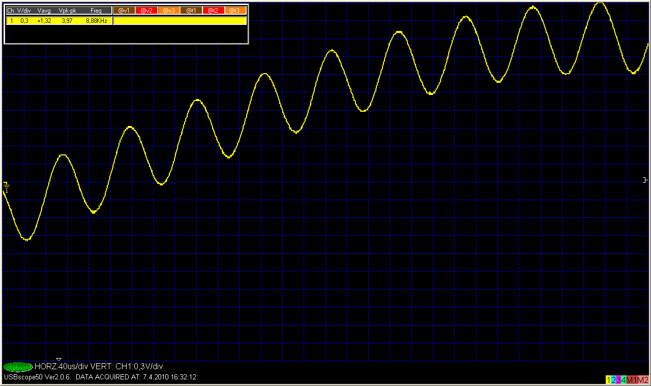

Linearity at 100kHz
When it vibrates so pretty, I guess something is wrong.
Federmann, the signals are SMPTE IMD 250Hz+8kHz and CCIF IMD 13+14kHz. The CCIF IMD would test the amplifier zero crossings at different slopes and amplitudes. The SMPTE IMD would show shape of high frequency, low amplitude signal carried on high amplitude, low frequency signal. Again, it reveals crossover distortion, if present.

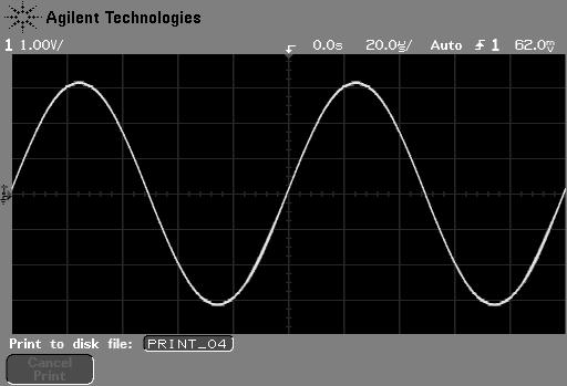

The question was
the output at say around 1 and 10 volts pk pk output at 10 khz when loaded capacitively with perhaps a 1 or 2 uF cap. Thanks
