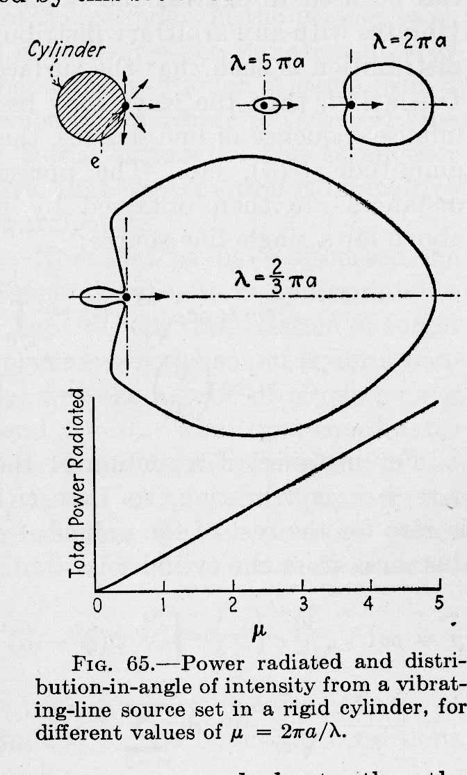

I would like to point out that the normal definition of the Hankel function (J0 + i Y0) has the Jo term as real and the Y0 term as imaginary. The complex i is usually brought out in front. Also, just to be consistent with texts, acoustics always use "i" rather than "j" so the signs will be different.
I want to show a different way of arriving at the same result as above, but one which has broader applicability.
Consider an infinite cylinder of radius a. This cylinder exactly fits one of the eleven coordinate systems for which the wave equation is "separable". By separable we mean that the solutions in each of the different coordinates can be separated out by a technique know as "separation of variables". I will not go into this technique here, but it is one of the more powerful techniques in the field of partial differential equations.
From the above it is know that any solution to the wave equation in cylindrical coordinates r, phi, z must be of the form:
p(r, phi, z) = R(r) * PHI(phi) * Z(z)
Where:
R(r) = A * H_m(k*r) = B * H'_m(k*r)
PHI(phi) = A * e^(i*k_phi*phi) + B * e^(-i*k_phi*phi)
Z(z) = A * e^(i*k_z*z) + B * e^(-i*k_z*z)
H_m(w) = Hankel function of first kind = J_m(w) + i * Y_m(w) where J_m(w) Y_m(w) are the Bessel Functions of order m. H'_m is the same but with a minus sign on the complex term. The plus sign represents outgoing waves and the minus sign incoming waves.
k_phi is the wavenumber in phi and k_z is the wavenumber in z. The magnitude of the wavenumber k must equal the vector sum of the three wavenumbers in r, phi and z, i.e.
k^2 = k_r^2 + k_phi^2 + k_z^2
Since the solution must be periodic in phi,
PHI(phi) = A * sin(m * phi) + B * cos(m * phi) where m is an integer.
If we have only outgoing waves and no variation of the source in Z then the solution becomes (no Z function is required)
p(r, phi) = SUM_m( A_m * H_m(k * r) * cos( m * phi))
Where SUM_m means that we must sum over each value of m - the radiation modes.
From the condition that the surface velocity of the cylinder at r=a must match that of the air surrounding it we will get:
p(r,phi) = SUM_m( A_m * J_m(k *a) * H_m(k*r) * cos(m * phi))
If the cylinder does not have any variation in phi then m = 0 only and there is no sum and we get the above
p(r) = A_0 * J_0( k * a ) * H_0( k * r)
If the cylinder had a variation in phi then we would calculate the A_m from multiplying both sides of the equation above by cos(n * phi) and use orthogonality to find the A_m.

In this case the cylinder is the source, as it is in Werwolf's derivation. In my solution one would model a line of sources width b lying on a cylinder of radius a as a patch of sources that lies along phi = 0 and subtends an angle phi_0 about phi = 0 suck that b = sin( phi_0). This would then involve a Fourier series in phi and a sum of many modes m, but is certainly a reasonable thing to do.
This is actually done in Morse, Vibration and Sound, Sec. 26. The results are attached.

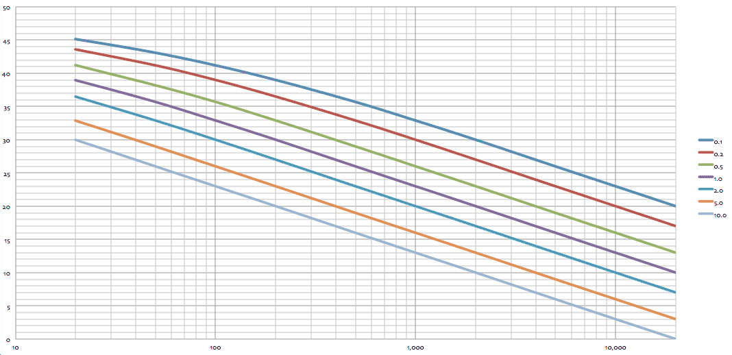

POST #11
C. Infinite Line Source: frequency-domain pressure response (continued)
We've determined that our Infinite Line Source 'transfer function' is given by:
H(kr) = (-rho/4)*{Yo[kr] + j*Jo[kr]}
Bessel Functions ... don't offer much "insight" for the uninitiated
So let's look at the asymptotic behavior of our newly-derived 'transfer function', for small & large values of 'kr'
1. kr << 1
Jo[kr<<1] ~= 1
Yo[kr<<1] ~= (2/pi)*[ln[kr] - 0.1159315]
H(kr<<1) ~= (rho/4)*{(2/pi)*[0.1159315 - ln[kr]] - j}
2. kr >> 1
Jo[kr>>1] ~= {SQRT[2/(pi*kr)]}*{cos[kr - (pi/4)]}
Yo[kr>>1] ~= {SQRT[2/(pi*kr)]}*{sin[kr - (pi/4)]}
H(kr>>1) ~= (rho/4)*exp[-j*(pi/4)]*exp[-j*(kr)]*SQRT[2/(pi*kr)]
This last expression, the approximate/asymptotic behavior for large values of "kr", is VERY interesting we'll explore it in the next post
(yes i promise some charts/graphs of the frequency response are coming ...)

POST #12
Before we explore our Infinite Line Source 'transfer function' for kr>>1 :
Let's examine this "kr" term in a little more detail ...
'k' is the so-called wavenumber, equal to w/c (where 'w' = radian frequency, and 'c' = speed of sound = 1100 ft/sec)
'r' is the distance from the Infinite Line Source to our measuring point
Therefore "kr" is really "distance divided by wavelength", and as such it's a unitless 'indicator' of how many wavelengths the measuring point is from the Infinite Line Source ... including a (favorable) '2pi' proportionality constant Here's some simple examples for kr=1 :
For a frequency of 100Hz (wavelength = 11 feet), kr=1 when r = 1.75 feet
For a frequency of 1kHz (wavelength = 1.1 feet), kr=1 when r = 0.175 feet
For a frequency of 10kHz (wavelength = 0.11 feet), kr=1 when r = 0.0175 feet
Note that larger values of "kr" will, of course, result for greater distances at any given frequency ... OR, for higher frequencies at any given distance For example, if we are measuring (or listening) at a distance of 8 feet from the Infinite Line Source, kr = 10 at a frequency of 219Hz ... and "kr" will be even larger at greater distances, or for higher frequencies.
So ... without providing a precise distinction (yet) between "near field" and "far field", we can expect that our approximate 'transfer function' for kr>>1 will be "reasonably useful" for a wide range of practical frequencies and distances (and, of course, we have the exact transfer function in our back pockets when kr>>1 doesn't apply)
Here's the approximate Infinite Line Source 'transfer function', for kr>>1, once again :
Let's look at these terms in detail :

POST #14
The exact transfer function for the Infinite Line Source, for any value of "kr", is :
where :
Jo[x] is the zero-order Bessel Function of the 1st kind
Yo[x] is the zero-order Bessel Function of the 2nd kind
Let's chart the magnitude response, as a function of both distance and frequency (normalized so that the farthest distance and highest frequency is 0dB), described by this frequency-domain 'transfer function' :
-------20Hz---50Hz---100Hz--200Hz-500Hz--1kHz---2kHz---5kHz---10kHz--20kHz
0.1M 45.2dB 43.1dB 41.2dB 39.0dB 35.7dB 32.9dB 30.0dB 26.0dB 23.0dB 20.0dB
0.2M 43.6dB 41.2dB 39.0dB 36.5dB 32.9dB 30.0dB 27.0dB 23.0dB 20.0dB 17.0dB
0.5M 41.2dB 38.2dB 35.7dB 32.9dB 29.0dB 26.0dB 23.0dB 19.0dB 16.0dB 13.0dB
1.0M 39.0dB 35.7dB 32.9dB 30.0dB 26.0dB 23.0dB 20.0dB 16.0dB 13.0dB 10.0dB
2.0M 36.5dB 32.9dB 30.0dB 27.0dB 23.0dB 20.0dB 17.0dB 13.0dB 10.0dB 07.0dB
5.0M 32.9dB 29.0dB 26.0dB 23.0dB 19.0dB 16.0dB 13.0dB 09.0dB 06.0dB 03.0dB
10.M 30.0dB 26.0dB 23.0dB 20.0dB 16.0dB 13.0dB 10.0dB 06.0dB 03.0dB 00.0dB
Notes :
- The left-most column is distance, in meters (M), from the line source.
- The value of "kr" for each data point can be found by multiplying the distance (in meters) by the frequency (in Hz), and scaling by 2pi/c = 0.0184 seconds/meter.
- The "3dB per octave", and "3dB per doubling-distance", rules become quickly apparent as "kr" exceeds unity.
And so ends our frequency-domain pressure response discussion, for the Infinite Line Source up next, the derivation of the time-domain impulse response for the Infinite Line Source ...
where :
Notes :
dave
