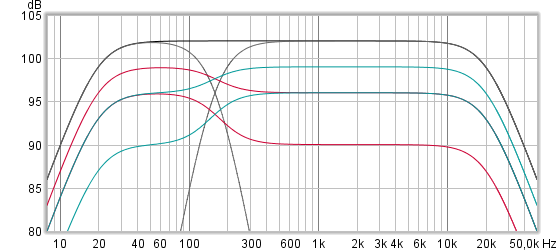

Can we mix a floor to ceiling array pass band with a point source pass band right if a floor to ceiling array fall -3dB per doubling of distance verse a point source fall -6dB ?
What i mean is seen in below where two pass bands are summed at 160Hz with 4th order LR slopes inside a 20Hz-20kHz system domain. Black trace is 102dB SPL at 1 meter where summing is perfect but if we use floor to ceiling array for LF pass band and sum it to point source HF pass band we get non smooth summing at 2 meter doubling of distance and again at 4 meter point ? Red traces is summing of LF part as being floor to ceiling array and HF part being a point source, where for turquoise trace LF part is point source and HF part being floor to ceiling array.

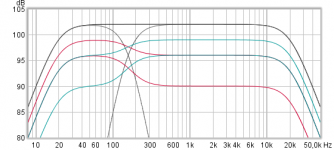

At low frequencies the farfield to nearfield transition point would be closer to the line source, maybe even before reaching the listening distance. So it should be relatively easier to crossover to a point source above that.
Now if we cross a line and a point source at a frequency ( 450Hz for example) where the nearfield of the line source extends way beyond the listening distance, we should match their levels at 4m not 1m.
That way at 2.5m the point source will be 2dB hotter and at 6.5m the line source will be 2dB hotter.
This gives +- 2dB between 2.5m and 6.5m. Not bad given the situation.
Crossing a line source to a subwoofer or a supertweeter ( say above 14kHz or so) could be understood. But why would anyone cross a line to a point source at 450Hz??
To avoid another long line of midbass drivers or is it a well executed compromise for improving something else? or both?
Check out the new McIntosh xrt2.1k. They use point source for 150Hz- 450Hz and line source for bandwidth below and above that.
