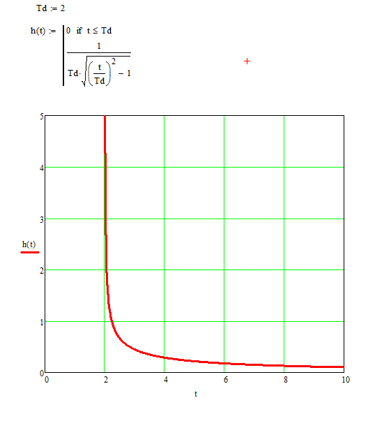

Graphs soon?
Perhaps someone can post some plots of the time-domain impulse response from POST #19a, for a few values of Td ... maybe Td = 1, 2, 5, 10 :) ... where (rho/2pi) can be 'normalized' to unity (or any other convenient value).
The impulse response "tail" will be immediately apparent. Please note that:
1/{Td*sqrt[(t/Td)^2 - 1]} ~ 1/t (for t >> Td)
And please remember ... the time-domain impulse response is simply the Inverse Fourier Transform of the frequency-domain transfer function (aka frequency response). One is completely determined by the other ... the same information is presented in either domain, time or frequency. For the Infinite Line Source ... we see ~ 3dB drop for every doubling of frequency and/or distance in the frequency domain, which dictates (or, is dictated by) ~ 1/t behavior in the time domain.
Done
I think that I'll show the finite cylindrical source in Mathcad also as it makes for a nice clean presentation.
Thank you Earl !!!
