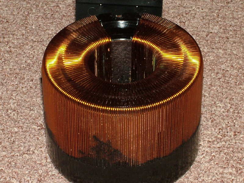

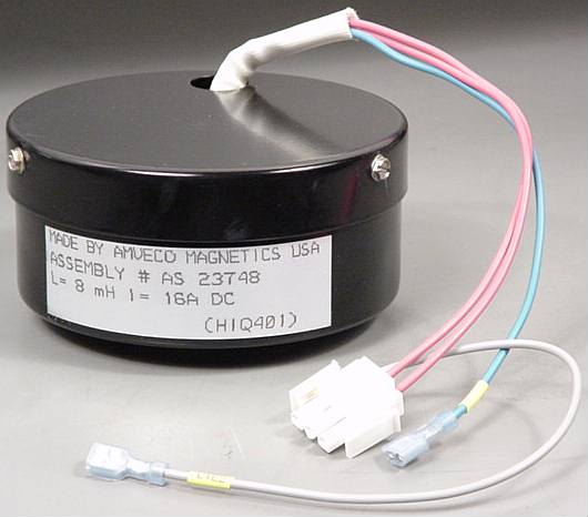

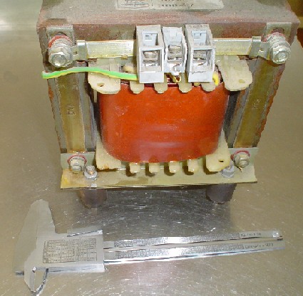

Some really cool chokes can be wrenched out of worndown big bucks gear, such as this 8mH fat boy with 3.5mm diameter enamelled copper winding.
Buy it if you can't wrench it out, borrow or steal it. :clown:

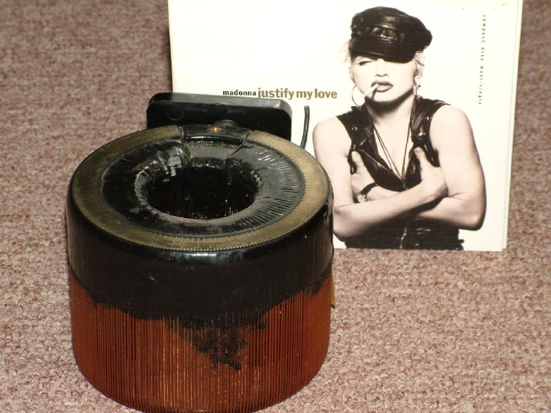

how bout these puppies
I got 8 of these and Im not sure how suilatble they will be in a CLCLC aleph-x psu. I think the resistance is around 0.1 ohm or so and imagine the inductance to be 0.5 mH if Im lucky. My biggest concern is will they saturate at 6 amps bias? How can I know or work it out?
Measure?
You could connect all 8 in series and measure R.
By size and 2mm wire I guess something like .3 to .5 ohms per
inductor.
Let's say .5 ohms worstcase.
Then if your Aleph-X draws something like 7 amps
the math is easy.
i.e. P=I.I.R so P=7.7.05 = 24.5W all the time each inductor.
That's a little to much for something like that.
Moral of story, try to measure first, test apply second, then
decide if they are usefull.
I hope this helps a little
thanks thats very helpful guys, I never thought of tieing them all together to get the total resistance And then work out power disspated.
I cant see an airgap so I would have to say no, I expect anything over 10 watts would be too much for them.
If I try them and the power supply works, how do I know they are acting as inductors and not fancy resistors, cos I would rather just use resistors than these things if they arent doing anything?
