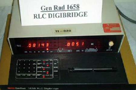

Jameco sells a kit which attaches to a DVM -- it's OK. There are still Heathkit RLC bridges which are acurate to a few percent and these go for less than $20 on the Bay.
I use a GenRad which I bought for $50. There's always one on sale on EBay:
I have wound several coils with the formula above, and they are quite accurate. There is no need to buy an LCR meter.

tell me, how can you tell if an inductor is within a 2% tolerance when you don't have a high quality LCR meter/bridge?
how can you tell the inductance if you use a ferrite or iron powder core? how do you characterize a core without a meter?
how can you tell the primary impedance of an SMPS transformer without measuring it?
i guess it depends upon how serious you are about your avocation.
First question, you measure it with a series resistor at several frequencies and do a little math to figure out DCR and L. How many frequencies does the typical cheap LCR meter measure at - usually 1 - like either 400 or 1K?
How do you know your uncalibrated 35 year old piece of electronics bought off of Ebay from someone you don't know is accurate to 2%?
