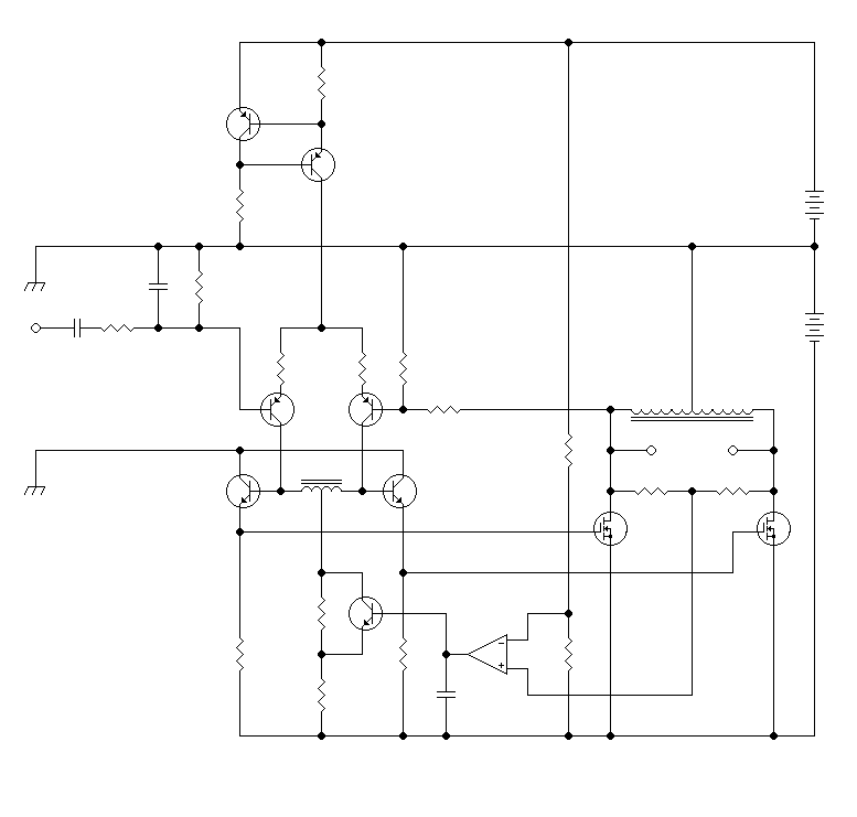

rough schematic
I've done a quick drawing of the schematic without any parts values yet.
The opamp is a discrete stage in the original but I didn't have the patience...
the transistors used are :
PNP's: ZTX214
NPN's: ZTX109
MOS : NDP6060
Apparently the idea from this came from a Mullard single ended amplifier that used germanium AD149's on the output (just in case you happen to have it :) ).
Quiescent current in the output is 3A per leg (total 6A through the battery). Lower battery is 12V and upper is 9V.
S

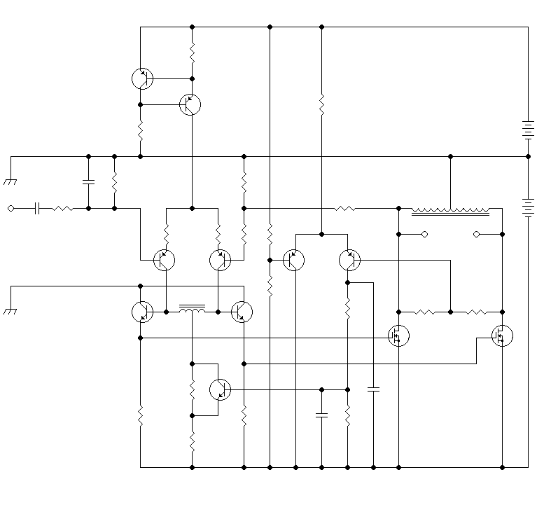

hmmm
overwhelming response so far ... :(

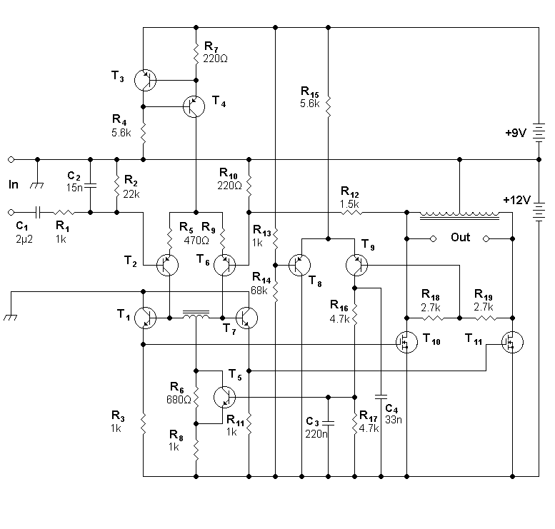

Well, nevetheless, here is a (final) corrected version with parts values this time. There was a small error in the feedback loop in the previously posted image.
The item I'm having most difficulty with is the first inductor/transformer. What I would like is some suggested inductance value for it (or how to calculate it) and possible parts that would fit the bill.
The second inductor I am pretty much certain it will be a mains toroid (say 230V primary - 40V sec. 225VA). Some companies make autotransformers with suitable values which would perhaps be preferable or indeed fabricate custom items. The questions I have on this item are:
- should it be rated for 3A (the quiescent current) or 6A (the peak) ?
- what VA rating should I aim for (the goal would be to keep leak inductance (& capacitance) low and hence not compromise the highs) ?
- do you have any suggestions for a company that will make custom items cheaply and will accept low orders (ie. only 2) ?
Finally, any other suggestions regarding parts substitutions, possible problem areas or general improvements, eg:
- would it be possible to remove the global feedback ? what other alterations should I make if I removed it ?
- should I replace the the current source or the dc servo with something better (and what) ?
Well, this is all I have to ask I guess.
In order to boost the interest a bit, I think I should add that the main other reason (apart from being an efficient class A amp) for building this is that it is a transconductance amp. or "current amplifier" if we want to abuse the terminology a bit. That "means" the input is a "voltage" and the output is "current". There have been one or two articles in E&WW singing the praises of such "current" audio amps but one should be carefull with large woofer excursions it might cause if uncontrolled.
One final reason is that it is quite easy to build although a little on the expensive side because of the large inductors and heatsinks and batteries required.
