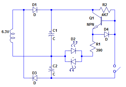

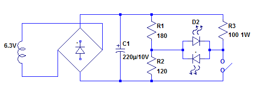

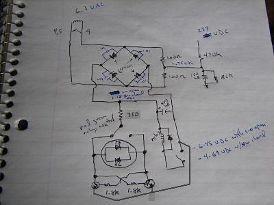

I am working on this circuit, and I have replaced the 100 ohm resistors with .047uf 600v polypropylene caps. Now the light doesn’t work. How could I get it working without putting him back in the output of the tube?
I am working on this same circuit again, and I have replaced the 100 ohm resistors with .047uf 600v polypropylene caps. Now the light doesn’t work. How could I get it working without putting hum back in the output of the tube? The same schematic is shown in post no 1, but I also eliminated the ground elevation circuit with the 470kohm and 82kohm resistors and the cap.
Google Image Result
This is the circuit I’m copying. I take two mic inputs, so I’m using both side of the tube. The relay pushes more voltage to the plates and operates the light. There are two possibilities for plate voltage, one green, one red. I don’t know how to upload the actual schematic for what I’m working on with my phone.
