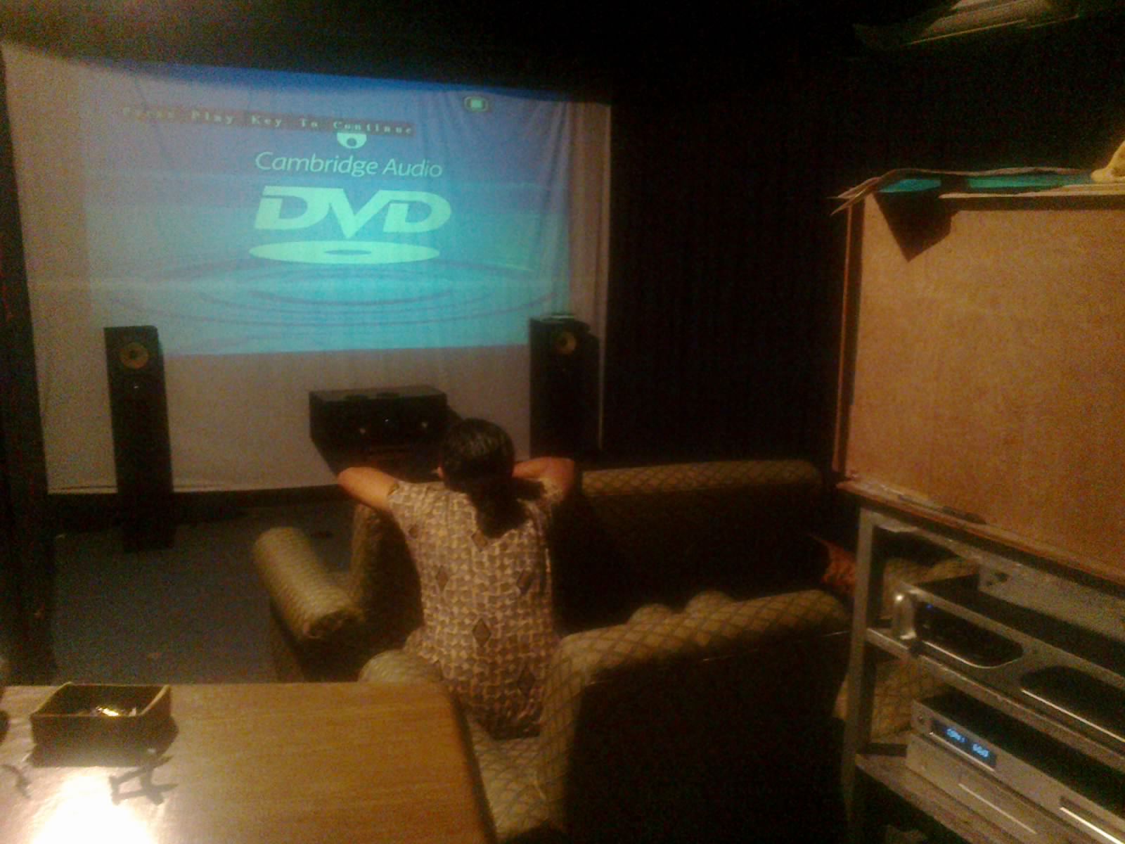

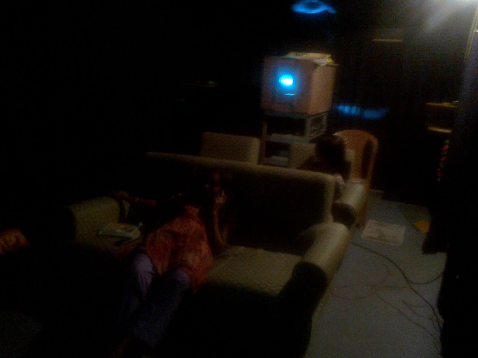

India again -HD LCD projector .
Have changed my triplet to 500mm from Optolife.
I will recomend Optolife for all sort of Diy projector related optics ,good service I must say.
:hohoho:
