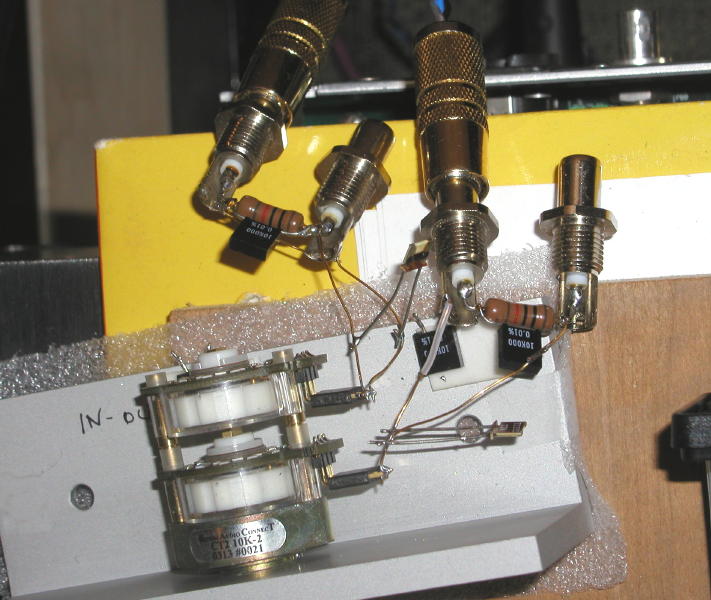

It seems like I've already found a perfect attenuator. It consists of a series, fixed resistor at amp's input and another, removeable resistor that sets the attenuation. In a picture, my current setup is presented. Please note that the socket is only temporary, it will be later replaced with much better grade, closer to amps' board.
All I need is a set of 6 resistors that I can plug in and depending on their values, I can adjust the attenuation in a 12dB range which is perfectly fine for most of my listening.
The quality of resistors is of great importance and in high resoulution system the differences can be easily observed. Specifically, for a GC amp, I'm choosing a nude Vishay in a series position and Caddock MK132 for shunt (Vishay does not work well here).
This setup is probably better than anything else presently available, although it's not particularly convenient ;)

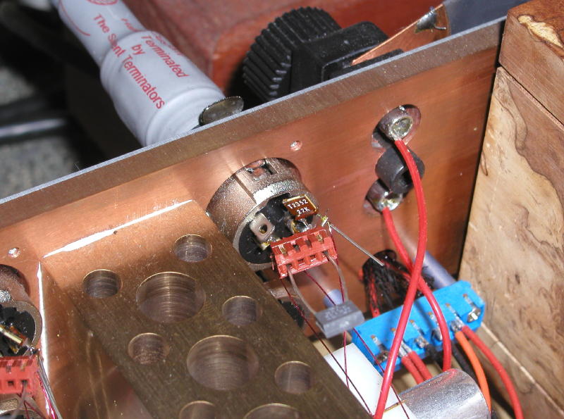

It all started again, when I bought a used Placette RVC on the Audiogon. I've heard previously very positive comments on that attenuator, so finally I decided to give it a try.
Initially, inserted between NOS DAC and GC, I didn't really like it. It was a bit harsh, not liquid and kind of annoying. I still preferred the Levinson preamp as it was more laid back and tuneful.
Later, I completed the active buffer stage ( 6 ohm output imp.) and I plugged the buffer directly at the DAC output, and suddenly things changed. Placette became the best thing I ever had in my system, with a level of accuracy, resolution and openess I didn't expierienced before. it was not an issue of musicality anymore, things simply sounded right to the point that issues like tonality dynamics and musicality are not relevant any more.
I was kinda surprised. ;)
Placette is based on a network of 14 resistors and 7 relays. It provides linear output voltage adjustement in 128 steps (if I'm not mistaken).
To see how good it is, I tried to "improve" on it with a circuit that consisted of a single series resistor inserted between two RCA jacks (input and output, series resistor being Vishay S102 or Caddock TF020) and the shunt element with DACT switch and nude Vishay across it. To my surprise, I couldn't improve on Placette with that circuit, contrary Placette was still better (in terms of resolution and opennes).
This leads me to conclusion that shunt element is equally important in a switching attenuator as the series counterpart.

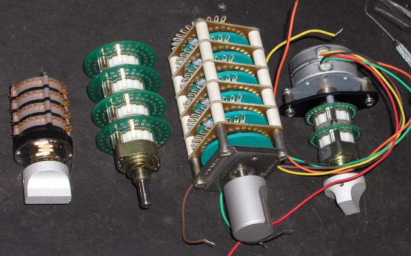

I have the Elma switch that's second from the left in your picture. I bought it through a group buy that was going on at Head-fi.org some time back. Shortly afterward, there was some talk of how the gold plated contacts on the Elma corroded over time leading to compromised sound. I don't know if that's the case, but there were a number of folks who wrote to concur.
Just out of curiosity, could tell us the names of the switches you have pictured? I'm also interested in which ones you found to perform particularly well.
Also, where can one purchase the nude Vishays?
Thanks,
KT
The biggest switch in a picture is Shallcross, which I think is the same as Shallco. It seems to have silver contacts.
Two other switches are from Elma. I like Elma for a reason of smooth switching action, I can't get used to hard turning of the others, Grayhill is particularly unpleasant.
I can't say how well Elma will perform over the time, but the preamps I sold two years ago still don't produce any switching noises (I'm using a better grade of Elma from Percy). Besides, a stepping motor can be attached to Elma for remote convenience. You can't do that with other, possibly better switches. Another advantage the Elma may have, is very little metal in contact area, and if low mass has some advantage in RCA connectors and binding posts, it may as well be important here.

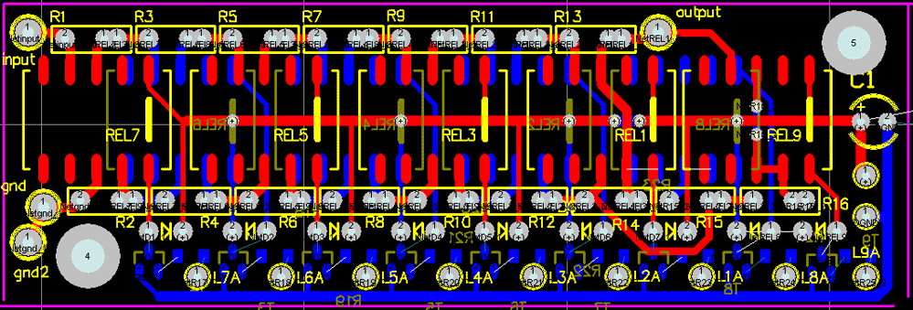

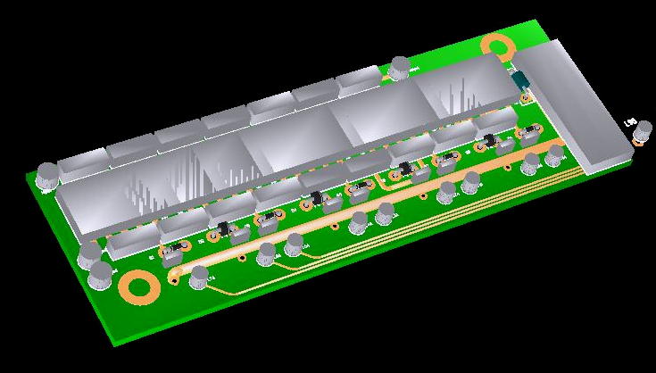

To be more practical, I intend to mount shunt resistors to a rotary switch and have at least 24 settings. The series element is fixed, the shunt is switchable, but a single resistor for each setting (altogether 25 resistors per channel, allowing 24 steps).
I'm also working on a more universal solution, where smaller number of resistors is used to create much more steps. It uses double sided PCB and relays (gold plated, silver clad contacts)
Yes. One board is needed per channel, balanced operation will require two such boards per channel.
The operation of the attenuator is very simple. There are two strings of resistors: one in a series position one in shunt. The resistors are shorted by relays in sequence and that produces 130 steps with average resolution 0.2 dB in most critical range section. There is never more than 7 active resistors (both series and shunt).
The signal path length is defined only by resistors size and relay switches length.
There will be display board available, remote control as well as encoder for manual adjustment.
