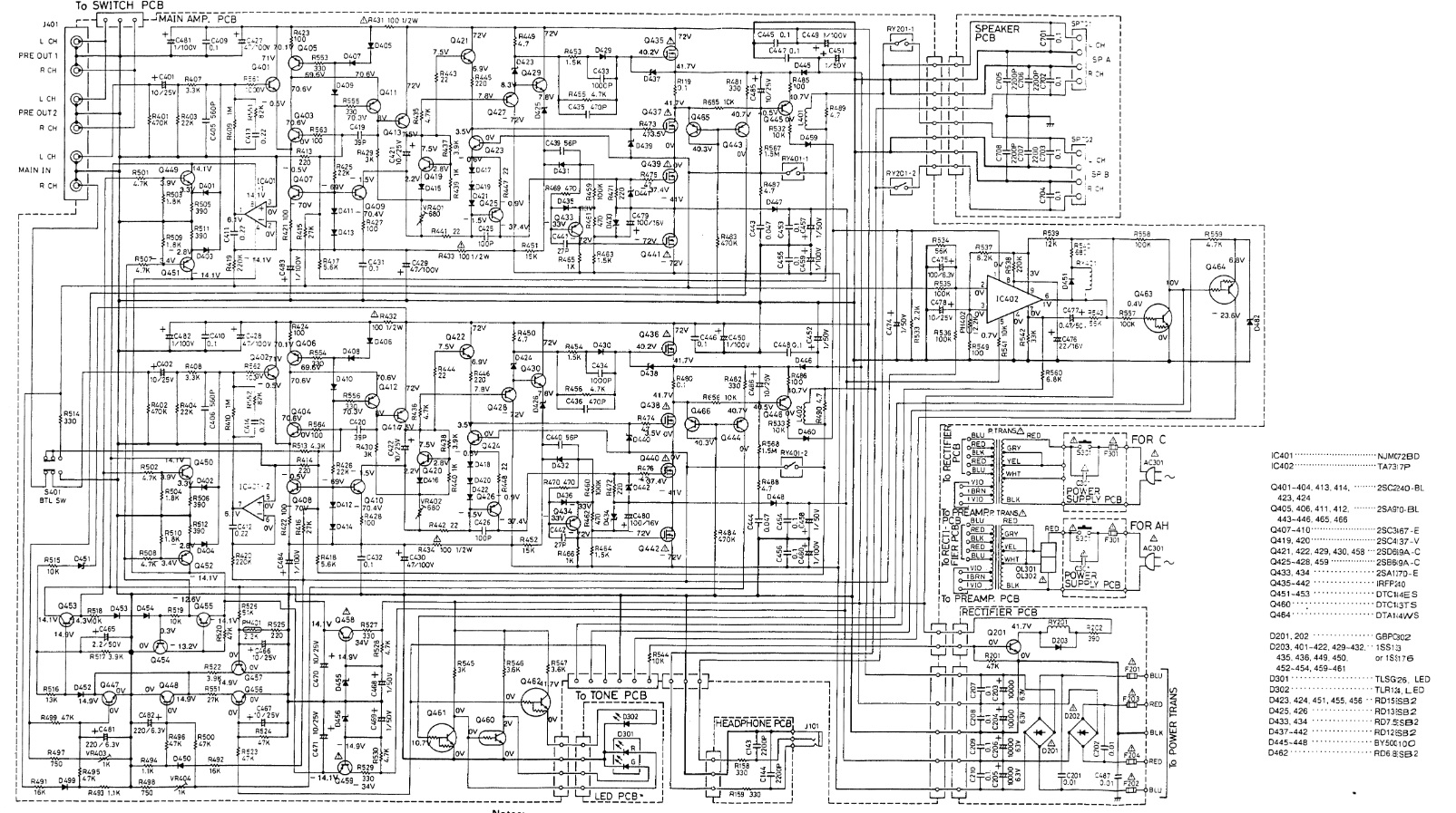

Hi again .
I inspected every cap inside NAD 306 amp and also the service manual .
In the main amp section all electrolytics are polar ones .
I was expecting to find some non-polar electrolytics to replace those with film caps but I can't find any of those .
I added a photo with the scheme .
Maybe this amp have some huge compromises ?.
And maybe the signal is passing thru some polar electrolytics and those can be changed with non-polar ones ?
What needs to be replaced ?
How can I improve this amp ?

Its a very unusual front end but as to improvements, well I would say to leave well alone. Certainly just swapping parts randomly will not achieve anything.
That said, there is one thing that could be improved (as a generalisation) and that would be to replace the speaker relays with solid state versions (which would have to be diy'ed, they are not available as an off the shelf part). Problems due to contacts tarnishing and giving rise to various forms of non linear distortion seem to be getting more common.

You'r saying that is a good design that don't need inprovements ?
Its not a design that you will improve just by swapping parts imo.
I don't understand why they use only polar electrolytic caps ?
Bipolar caps are only used where there is a need for a large value cap that can see voltages of either polarity. To use them in other areas would simply be bad engineering. A correctly specified polar cap used correctly is essentially transparent to audio.

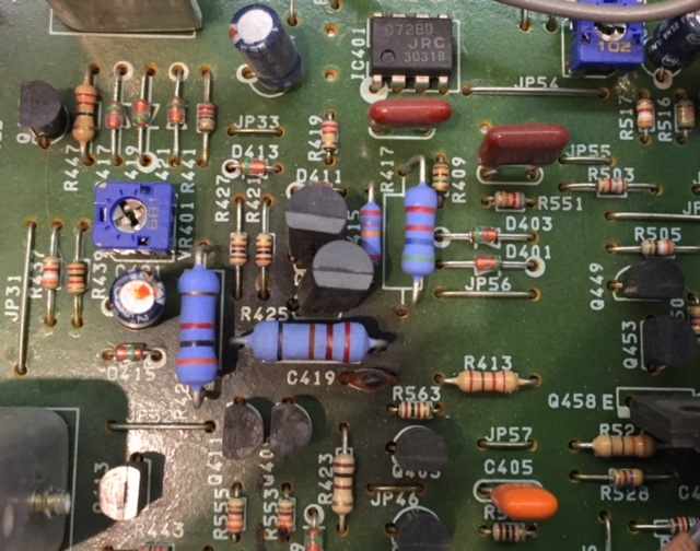

Hi, I just got one of these amps from a customer who had bought a new NAD as replacement. I have just had a look at it, and done a quick test to see if it was working properly.
It is quite a complex design for a cheap(ish) small amplifier: All the outputs are IRFP240, and at first glance there appears to be four devices per channel (!), but then I saw it has dual rail voltages (41 and 72V), and it looks like two of the IRFP240 are switching the rail voltages to the other two devices (Class G/H stuff). So in effect only two outputs per chn. And of course it has the typical NAD soft clipping and protection circuits, as well as both MM and MC phono stages, so lots and lots of components in it.
After cleaning the volume pot it works perfectly, and has a very clean output, with THD better than -90dB. Harmonics are mixed, but with low-order becoming clear with increasing load. Frequency response is about -1dB at both 20hz and 20Khz, so "nice" symmetry there, but could perhaps benefit from a larger input cap.
So objectively a (surprisingly) good little amplifier, although I don't really like the topology - but that is perhaps just because I am more familiar with the common BJT push-pull EF layout.
If only NAD had spent just $2 more on the plastics for the front panel and knobs, instead of using the lowest quality stuff they could find...
Have a nice weekend :)
Dry & baked solder joints..

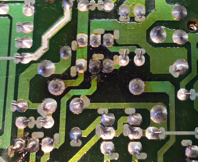

Well I went back to do a few more tests, set the Bias and align the Soft clipping circuit, and then I got some "funny" measurements - suddenly not working so perfectly after all.
I then had a look on the bottom side of the PCB, and found a lot of dried out solder joints: The worst areas were under the two clusters of power resistors (around R425 and R426 - see the two pictures), but there were many joints all around the board with a ring just starting to show. Almost an hour of reflowing/soldering.
So if anyone has one of these, with unstable sound or some intermittent problems, I would advise to check the condition of all the solder joints first.
If you are aiming to keep it for years, the caps and small transistors around the hottest resistors should probably be replaced, as they will be pretty well baked by now. R425 and R426 (22K) should also have more distance to the PCB, for better airflow around them.
