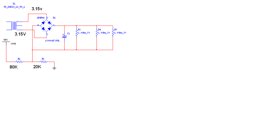

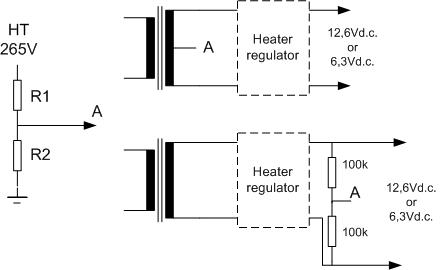

I have just read this thread and the recent trouble sunrise had with his heaters concerned me. I am running 12AX7's/12AT's and 12AU's and should get around 130V on cathodes of upper tubes, this is too much for a heater at only 6.3V.
How should i float my heaters?
Heaters are run from 6.3V DC and My HT is 370V before voltage regulators and 265V after.
Do i just run a divider down? is it better from unregulated or regulated supply?

To float heaters just pull the voltage divider from the last capacitor at Your high voltage. Calculate the voltage divider so that at top You have Your high voltage (where the divider is connected) and in the middle (between two resistors of the voltage divider) You have the voltage You need to float the heaters. If Your voltage between the cathode and heaters is,say 100V - You can float Your heaters arround 50-55V.
So - if the upper resistor is R1 and lower resistor is R2 than Your voltage could be calculated with 55V=(R2/(R1+R2))*Uht. Uht is Your high voltage (265V). So lets say that You want to drop on those resistors 5mA. Than Your R1+R2 is arround 53k. With that You can calculate R2 and find the closest values of R1 and R2 so that You have some current flowing through them and also some nice values that You can buy in stores. Hope this helps and hope that I have written everything correctly- not much sleep last night

Missprint on heater balancing resistors? Says 100k. I guess you
meant 100 ohms? (normal choice) Also, there might be a point in
bypassing the lower of the (B+ to GND) voltage divider resistors
with a cap. Some small-signal valves have a spec. max impedance
between heater and cathode, usually 20k, if memory serves. Use
at least a 1uF cap, IMO.

thanks..... no sleep last night i guess
You can do that but I would connect middle point between 80k and 20k on the center tap of You mains transformer (I see that You have a center tap).
