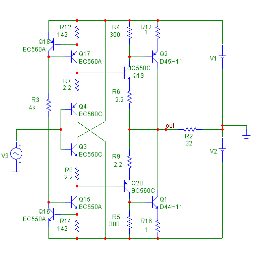

Improved Diamond Buffer Design
Hi All
I was wanting to build a discrete buffer for a preamp/headphone amp, so I started with a classic diamond buffer design and I found that I had to increase the bias to drive the low impedance loads at low distortion, but then the output devices would get hot because of the heavy bias.
I needed a design that can supply large current to the output devices when the output devices needed it.
So I came up with this design here.
Enjoy
Tim

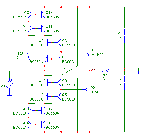

Improving upon the Improved Diamond Buffer
The previous iteration of the design was very good, but its input impedance was about 7k which is fine if the circuit is to be used as a buffer to a opamp but not so good if it will be used by itself.
The changes have increased the input impedance to about 150k but reduced the voltage swing by +- 1V and have lowered the distortion in to 32R slightly from about 0.003% to 0.002%
Otherwise the rest of the specs are the same with 0.12R output impedance, theoretically 470MHz 3dB bandwidth and vanishingly low distortion into 100R
Cheers
Tim

I was wondering when somebody would ask me that.
According to the unreal world that is Microcap 6, I don't need them because I can't get the distortion any better than it is and if I add them to my simulation the distortion gets worse.
But you are right, in a real world my parts won't be so well matched and I will need some degeneration.
I will be having a go at the prototype soon so we shall see.
TzeYang said:
no degenerative resistors for the drivers and the mirrors?
It isn't simply a distortion matter: without resistors, it will go into thermal runaway at an incredible speed.
I suggest you power your prototype with a good, current limited lab PSU. Otherwise the experiment may end in heath and smoke...
Circuit looks very cool to be honest (though with emitter resistors it'll be even better).

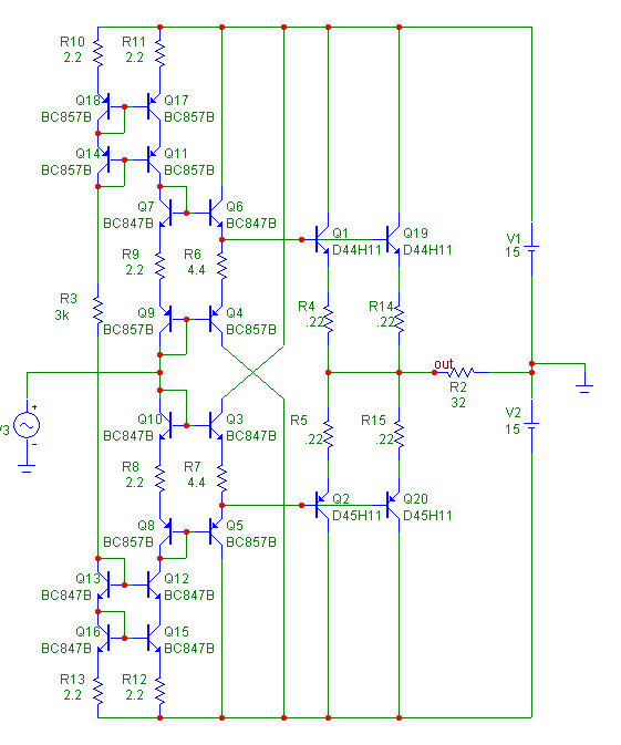

OK
This version I have included the degeneration resistors and the BC847B's are intended to be BC847BV dual transistor pairs to improved temperature tracking, possibly matching as well as reducing parts count.
Doubled the output devices to reduce the output impedance,
The THAT 300 devices look very nice, if they were not so expensive I would probably give them a try.
Cheers
Tim
There's one thing I don't understand, which of the following is of higher Zi (input impedance):
1) Source sees two diodes.
2) Source sees the bases of the driver transistors (typical diamond buffer structure).
Though it is not obvious the 2 diodes are in series with the high impedance of the current sources.
The high impedance dominates the 2 components.
Cheers
Tim

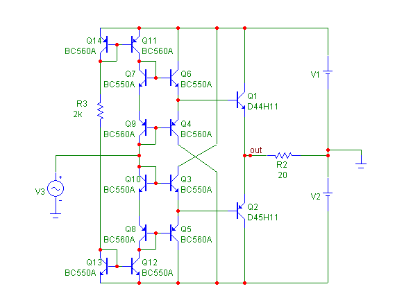

Hi Tim
In the datasheet it states the matching is between devices of like polarity. So the 340 has 2 matched NPN and 2 matched PNP transistors. The NPN is not exactly matched to the PNP, but I don't see how that will effect your circuit. IMO, I like swap mirrors better than cascade mirrors. But you’re paying a lot more to have separate matched dies in one package. (That is the big advantage with these in that they are not monolithic.) Is it really necessary to have a compound mirror? for THAT price..... :dodgy:
IME, you want to use these at around 1 or 2mA, they perform nicely. They are fast and very low noise, at least in my circuit.:) I measure a current gain of about 85, which is close to the datasheet, but much less than the Hfe of a BC550. I don't think this is a big drawback considering all the other positive properties of these transistor arrays. A few more uA of base current? Big deal.:rolleyes:
For best noise results don't leave the substrate floating.
I have also used D44 and D45. These are nice linear TO-220 BJT’s up to about 4-5A. Fast with plenty of gain. But are they really needed to drive 32 Ohms at +/-15V? Or are these not the devices you are referencing?
Anyway good luck:)
My :2c:
Hi Aurelian
Funny enough I have already done such a circuit and it works great.
I think the others who were on this topic would approve too because it has everything they were suggesting too and it achieves the distortion, bandwidth and load driving performance that I was after.
