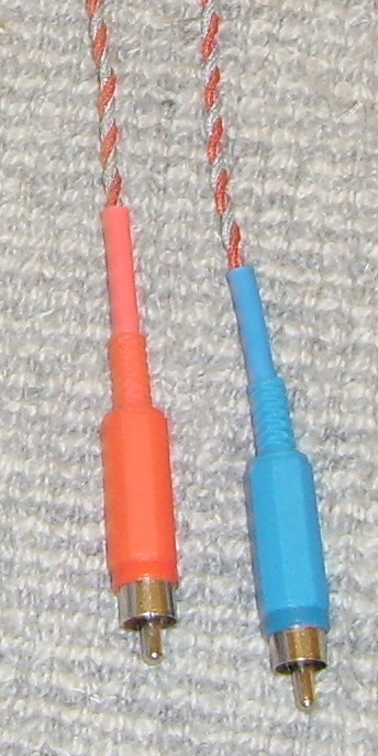

Here´s my own attempt at silk insulation, from Dr. Gizmo´s recommendations in Listener magazine. 24 awg solid silver and cheap connectors. The silk came from a crafts shop.
Coolness!
So what's going on here? You got some silk braid from a crafts store and slid it over the wire and then twisted them together?
Actually I'm currently working with another French company to produce some custom silk braid for my cables. I've come to find that the "nude" cables really weren't up to being handled by the average audiophile. While I've yet to have a cable fail, I'd got some back that just looked plain ugly. Dirty and all kinked up.
I'm working on a new version of the cable that uses four strands as in the original, but instead of braided they're just a simple, straight parallel quad inside a braided silk jacket.
I found they sound every bit as good as the nudes (in some ways even better) but they have a much better "feel" to them and don't have the rather stiff, springy, kink-prone, mind-of-its-own quality of the nudes.
The jacketing also allows me to wax the silk insulated wires. Something that I had very good results with with the nudes in development but something I opted not to do with the production version becasue while the wax, which was applied dry and the cables warmed up to the wax's melting point which caused it to wick into the silk, gave the cables a nice light brownish color (because it made the silk translucent so the color of the conductors showed through), if you bent the cable too severely or scraped it with a fingernail, it would slightly separate the fibers and the wax making that portion of the cable look white.
Didn't want any blotchy looking cables out there.
That´s right. Pretty simple, isn´t it?
Please note that English is not my native language and "crafts store" may not be the usual designation.
I was told the silk braided tubing is used for making belts and curtain cords and the stores that sell it also sell shirt buttons and fabrics.
It must be miles away from the silk you get from France.
I´m almost sure the one I got is artificial silk or a mix of natural and artificial materials, as it feels both satin smooth with a disappointing hard edge, like sharp hills on a prairie.
These add a certain sonic signature that I dislike.
A while ago I plugged them between CD player and integrated amp and listened to "Platinum" from Mike Oldfield.
It sounded fast and detailed, possibly due to the air between the braids and the 33 pF per metre capacitance. On track nr. 4, Oldfield´s version of Philip Glass´Northstar, when the speed guitar enters at 3:15, the background choir, drums and bass don´t get compressed. Quite satisfying if it wasn´t for the sharp envelope edges in which the individual instruments are contained. These get really annoying on track nr.1 at 4:00 where it´s all glockespiel and electric guitar. Almost ear-bleeding.

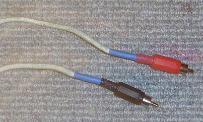

Switching to all cotton and silver (see photo) the razor edges disappear instantly. The sound is darker and not as fast and detailed and the track nr. 4 bit sounded compressed, certainly due to the 100 pF for 80 cms. The cotton sleeves are thinner than the silk braids and I believe I also overtwisted the wires. But this cable sounds quite musical and pleasant.

Forgot to post the picture: you can see how the wire tangles and the outer cotton jacket (read shoelace ) got dirty with repetitive use. For commercial jacket applications white natural fibers are out. Audio Consulting doesn´t seem to bother about it, but they´ve always showed a hairshirt kind of approach...
