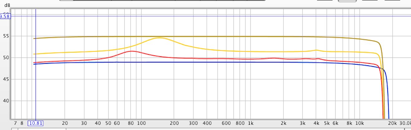

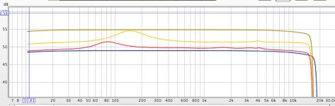

DATA
I ran trustworthy but sort of semi-calibrated impedance curves on my nearby headphones: Audio-Technica A900 (sealed, some mods) and Sony MDR-7 (open, about 30 yrs old but good quality at the time).
Some conclusions:
1. Minor bumps in curves - likely diaphragm resonance
2. Surprisingly precise match between sides
3. No difference when A-T mounted on an elderly human head
4. Since there appears to be not too much undamped resonance with these headphones, I think it is unlikely that a low output impedance would be materially beneficial, esp. in light of substantial DC resistance present. But prolly just enough resonance to lead to Big Arguments among reviewers and different amps and tastes.
The top curve is the impedance of a 83 Ohm resistor and bottom is 39 Ohm.
Orange curve is Sony with peak at maybe 150 Hz; DC resistance about 53 Ohms
Red (lower) curve is A-T with peak at maybe 80 Hz; resistance about 41 Ohms
A loudspeaker (driver) curve would have an Everest style peak at, say, 25 Hz (resonance) and a full-range driver might be going somewhat up from 3 kHz (voice coil inductance).
Ben
