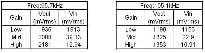

First I had to choose a maximum output voltage for the AD620.
I intend to use it for feeding either the input of my oscilloscope (broadband measurements) or the input of my sound card (5Hz-20kHz measurements).
For the later (sound card), the max out from the AD620 needs to be the 0dB of the card’s input, thus 1.286Vrms (or 1.818Vp, or 3.637Vpp). This is almost 1/5th, 1/7th, and 1/9th of the max out with +/-9Vdc, +/-12Vdc and +/-15Vdc PSUs respectively. http://www.diyaudio.com/forums/attachments/equipment-tools/229262d1309365074-implementing-y-out-oscilloscope-manual-meas-clipping-level.jpg
Then I need to know the Slew Rate (SR) of the AD620.
The data sheet gives the SR minimum 0.75 V/us and the SR typical 1.2 V/us.
Part I, page 1, equation (3) provides the minimum frequency (fp) above which an Op. Amp with a typical architecture will start to Slew limit. (AD620 conforms to this typical architecture).
Plugging Vop=1.818Vp and SR=0.75 V/us into the eq. Fp=SR/2piVop per above, I get:
fp=67.5kHz.
Plugging Vop=1.818Vp and SR=1.2 V/us into the same equation, I get:
fp=105.1kHz.
Now I had to test these results in my “real world” case .
The test set-up:
[Sine wave Signal Generator] – [AD620 (+/-15Vdc PSU) in single-ended Input configuration loaded with 10kOhm dummy output load] – [Oscilloscope and RMS Voltmeter]
Results are tabulated on att.1
With signal of 65.7kHz the AD620 output is higher than 1286mVrms. This means that it’s fp is higher.
With signal of 105.1kHz the AD620 output is a bit lower than 1286mVrms. This means that it’s fp is a bit lower. (It is around 100kHz.)

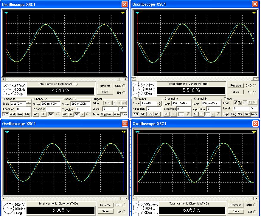

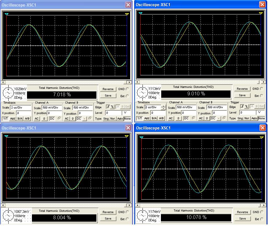

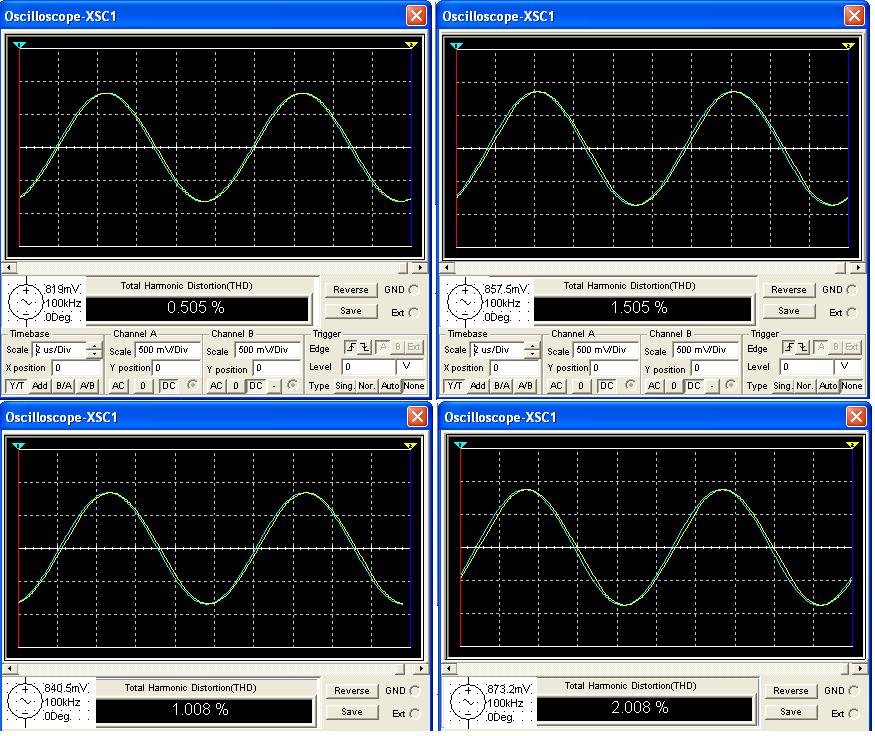

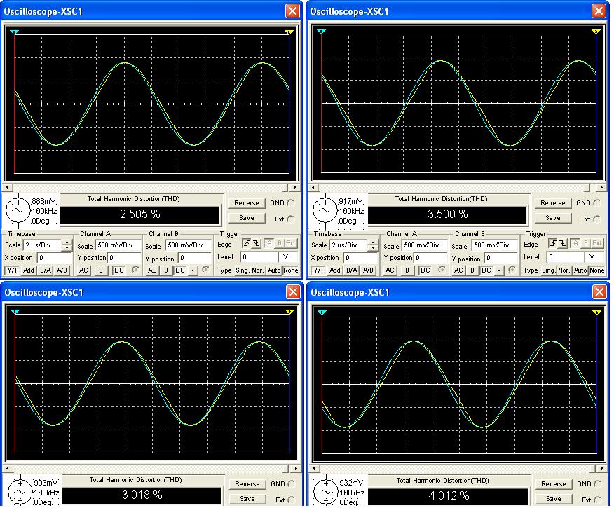

How did I actually test the onset of slew limiting?
By observing on the scope and comparing the output and input traces.
I don’t have a THD meter, so I had to find a way for to compare what I saw as onset of slewing with it’s THD equivalent.

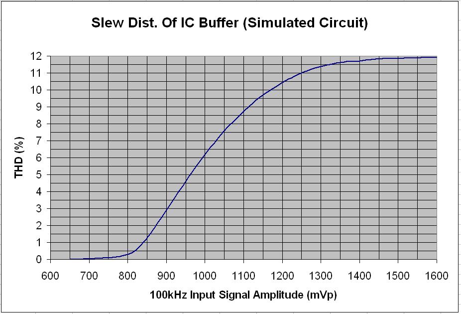

I simulated a simple inverting buffer IC for SID (Slew Induced Distortion) and did a series of virtual measurements.
Results on att. 1 to 4. Yellow sine is the output and cyan is the input.
The shape I was considering as the onset of Slew limiting while watching the real oscilloscope, was no better than the 2%THD and no worse than the 3% SID induced THD. Not very bad score. :D
Using the simulation virtual measurements, I plotted a THD versus Signal amplitude curve for the case of x1 gain (att. 5).
You can see that it takes a very small increase of signal amplitude for the THD to increase quite a lot. In fact such small a signal increase, that it is very difficult to adjust it on an ordinary real signal generator.
Using this curve, one can also estimate a correction factor for adjusting the “observed” oscilloscope trace to a trace with a lower distortion figure.
E.g. a signal with an amplitude A producing a curve of 2% THD, has to be lowered by 5% for to produce a curve of 1% THD.
A signal with an amplitude B producing a curve of 5% THD, has to be lowered by 14 % for to produce a curve of 1% THD.

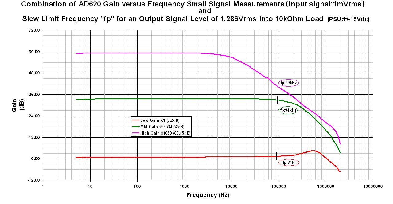

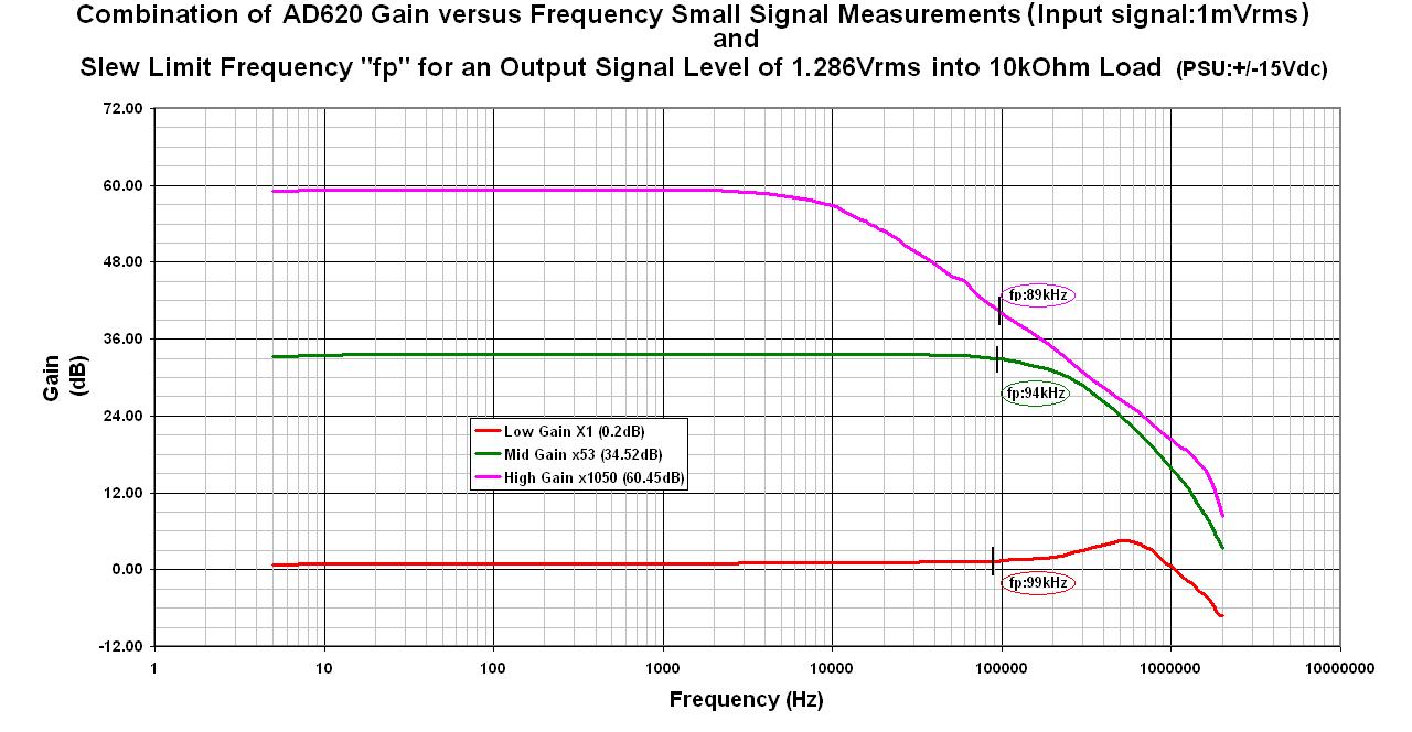

I thought to post some essential paragraphs from part I of the article. They are in att.1
In att. 2 you see the small signal “Gain vs Frequency” of AD620 I posted earlier.
In this diagram I have marked the frequency “ fp” for the specific AD620 output of 1.286Vrms, which is the 0dB of my card’s input.
So now watching this diagram I can notice from which freq. and up the output signal will be slew limited, as well as what level of amplification will the output signal have at each frequency.
The “fp” noticed with careful real measurements using the oscilloscope, corresponds to a THD level of 2% to 3% (*PS)
So as per post #84, I generously (-10%) corrected each to an fp corresponding to a SID-induced THD of 1%. This corrected “fp” is the one marked on each curve in the diagram.
These “fp” are in good agreement with the theoretical (calculated) “fp” of post #83. It turns out that the Slew Rate of this AD620 is close to 1.07V/us
From the equation (3) (Fp=SR/2piVop) it follows that fp goes up as the output level goes down.
fp increases 10 times due to a 10 times reduction of Vop
fp increases 50 times due to a 50 times reduction of Vop and so forth.
I have verified this up to 2MHz, the freq. limit of my signal generator.

Erratum (fp values)
Gentlemen (there are no ladies here, I am sure )
I just noticed the results of a new form of distortion acting on my brain. I call this HEID (Hot Environment Induced Distortion).
Distortion products are disorientation, dyslexia, luck of concentration, no interest for the other sex (but that’s irrelevant:D).
An example of the results of HEID can be seen on att.2 of the previous post.
The undistorted diagram is attached here, just for comparison.
My apologies

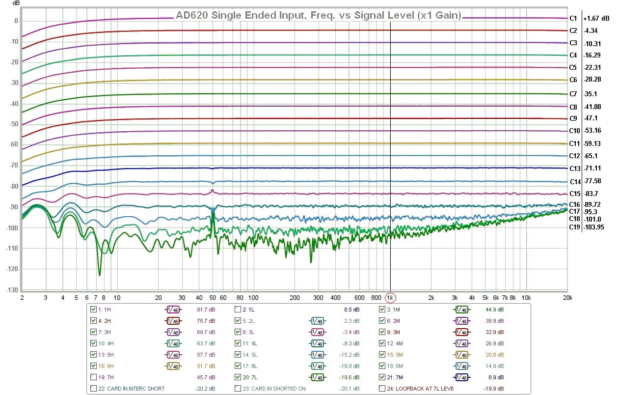

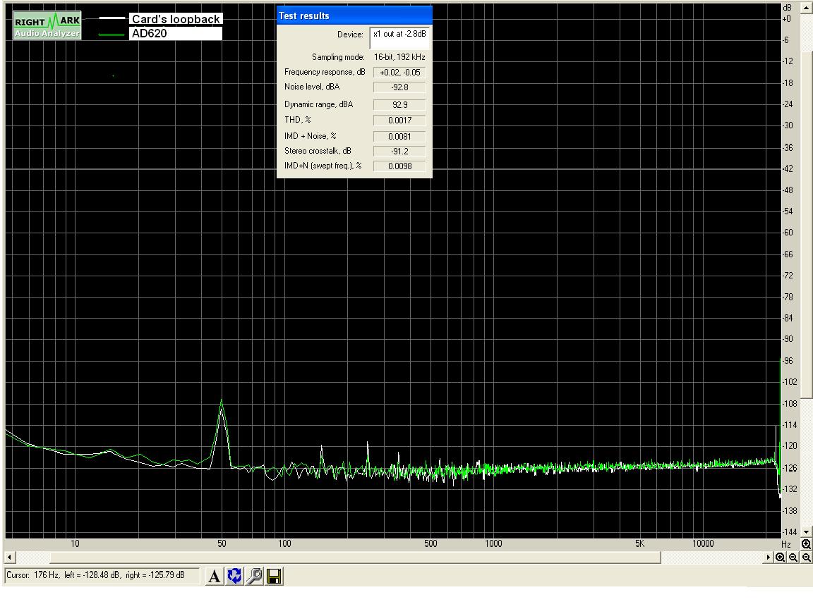

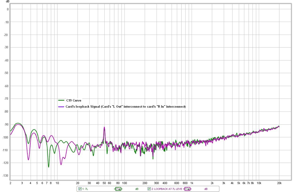

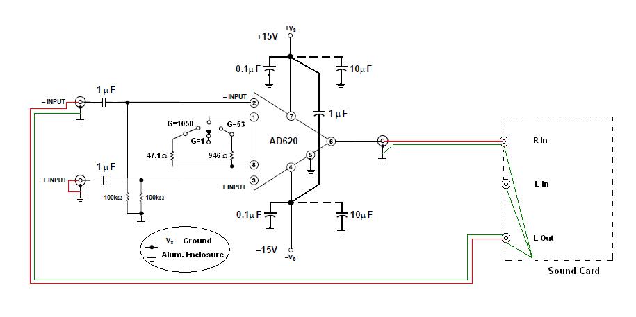

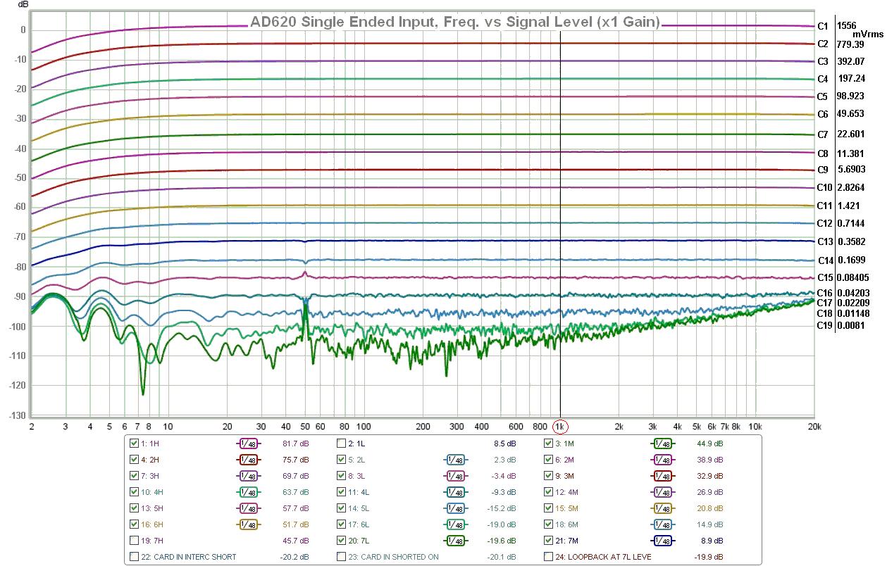

Here are your long missed :D auto measurements with varying signal level.
Att.1 is the measurement set-up. AD620 gain is set to “x1”
Att.2 are the curves with dB markings (on the right) relative to 0dB of the card. Reference frequency is 1kHz.
Att.3 are the same curves with corresponding signal amplitude in mVrms at the input of the card.
They are noiseless down to curve C14.
Compared to TL074 diagrams (post #64) where the last noiseless curve was C11 (-62.51dB), the AD620 goes lower by almost 16dB.

Hi George, very nice result with the AD620! Very impressive that you can get measurements that clean down into the microvolt range!!
I'm a bit confused by the graphs in posts 88 and 89. The 60db gain seems to start rolling off at around 2Khz but you have the fp point at around 89Khz, Is this what the paragraphs are talking about with respect to the difference between power bandwidth and small signal bandwidth, ie you are basing on distortion (so power) rather than rolloff ie small signal? Not suffering from any HEID here at the moment. 14degC outside today :)
Tony.

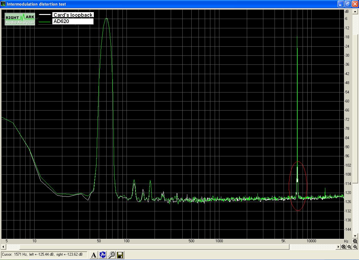

Joined 2002
Yes Tony. They look pretty clean. Most or all of the LF noise at the very low signal levels is from the measurement set-up.

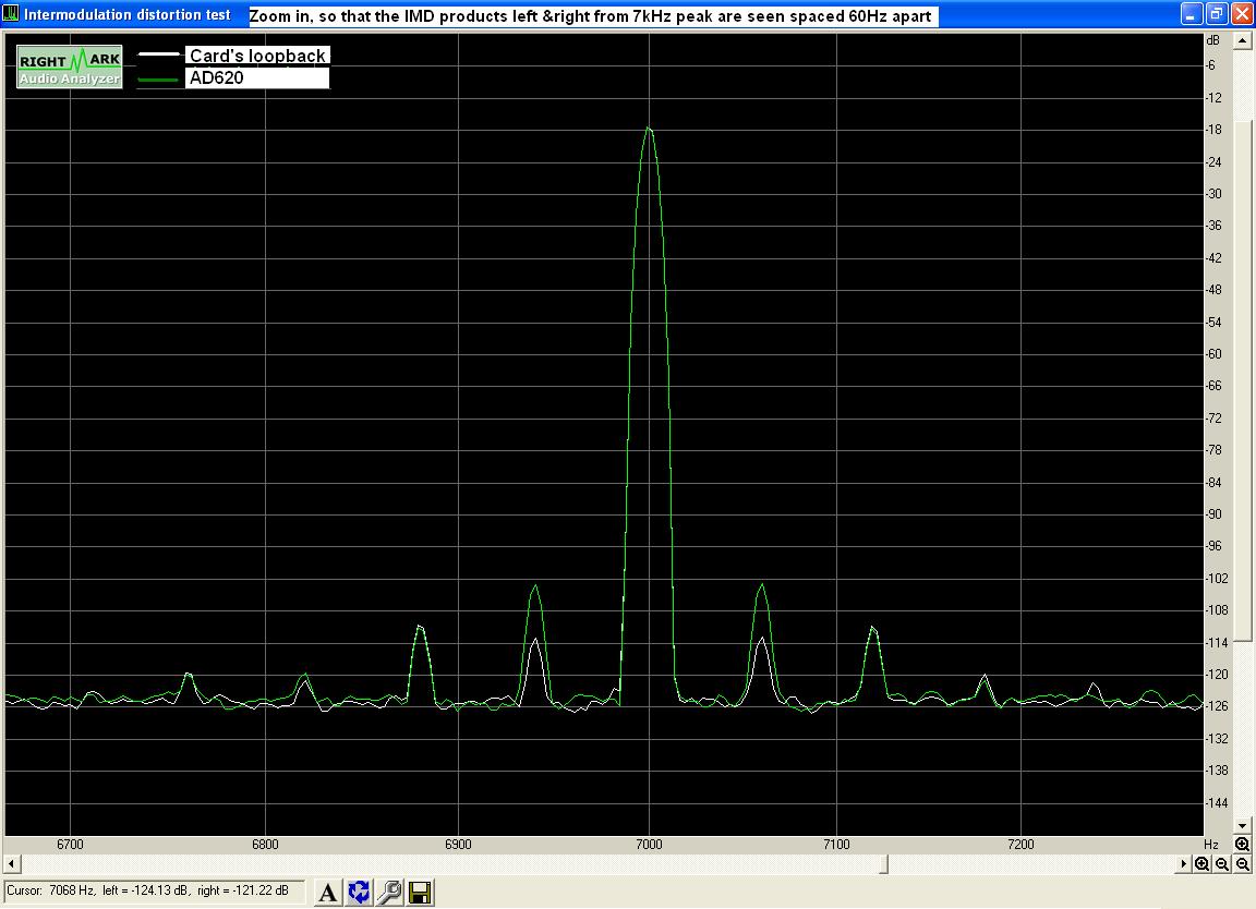

In att.1 I have placed C19, the lowest from the curves I posted above, together with the card's signal in loopback connection using the same interconnects used on the AD620. As you see, they are almost indistinguishable. This shows that the noise is not picked up by the AD620 circuit.
Some measurements from RMAA follow (att.2,3,4)
The frequency roll-off (for each gain setting) occurs on any signal level.
In addition to this, you have to consider the fp point, which varies with the signal level.
High signal level = low fp (SID starts at lower frequencies, not good).
Low signal level = high fp(SID starts at higher frequencies, much better).

Just another Moderator
Joined 2003
Interesting that the IMD is only happening on the AD620 for one harmonic either side of the 7K signal, but the sound card clearly is contributing for four harmonics (assuming that is the right term to use). Looks like you have a similar level of 50Hz interference to what I have as well! my best results were around the -108db mark as well..
