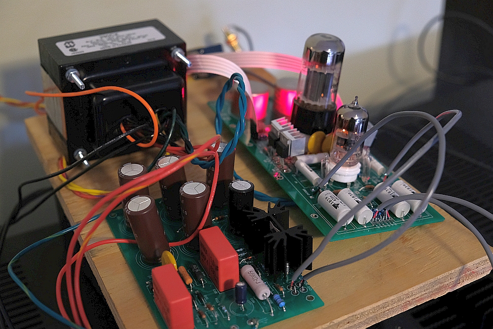

I have the 290CX and I have about 357 Vdc at the psu output using 120 to 121 vac mains. I agree that you shouldn't worry about the difference. You will end up with slightly lower current through the 6922 but that is no problem. It might even be desirable.
Just a crazy thought. Did you happen to have your light bulb tester still attached when you measured psu voltage? I did that and had low voltage. The light bulb causes a fair bit of voltage drop, even though it's not glowing. I found that out the hard way.

Thanks again for all of the suggestions. I spent some quiet time, once the grandkids had gone to slept waiting for Santa, traced what R1 does on Jack's board, determined I needed a jumper there. Now I have 357vdc like Jac is showing, didn't check what was coming out of the wall though. I figure with the improved voltage I can move on to powering the preamp side of things.
And yes Jac, my first power on was with the bulb tester, much lower voltage, but no glow so I did move on to full test.

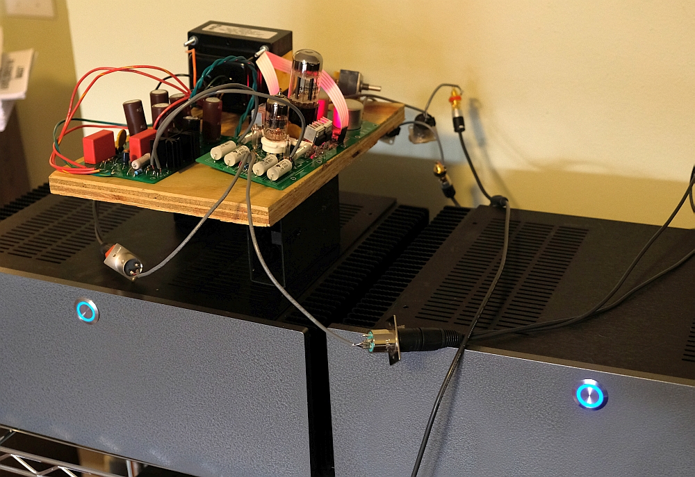

Many thanks to all for their advice and assistance. While lunch was being prepared, went ahead and added the XLRs, connected power supply, added some EH tubes and viola sound. I am playing the preamp through some A7 powered speakers I have in the shop, no hiss just great tube sound!!
Now for the case build and connect it to the pair of bridged F4s.
The case build is the part I hate the most, rather build the circuits than plan and drill a case.

Thanks guys. Your suggestion Jac using the 290CX is spot on, a bit oversized for this application, but works well. Underload the PS is holding at about 351vdc.
I am now in the process of trying to pick a case for it, then it's off to the drill press!!

I got things down to -75dB for 60Hz and 120Hz by playing with the heater wiring. I re-read the article which quotes -89dB at 25Hz. I am in the mid -70s, so I would assume SY got much quieter PS. I have some extra volts on my heaters (around a volt!) so I could experiment with DC...

Indeed. I got another -10dB at 60Hz using a Russian 6N23P-EV. It was the best out of 8 choices. Let me see what I can get by changing the 6SN7...

I am enjoying listening to my board mounted Impasse playing through the F4s. Tubes are EH in both positions. Tube rolling to come later!!

FWIW, the Maida regulator is NOT particularly quiet -- it's the LM317 -- try bypassing R108 with a 10uF/450V electrolytic or polypropylene cap.
