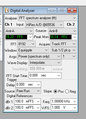

Take the FFT and compute the total IMD from the spurs? After all that's what the option would be automating isn't it?
Measurement options are usually there to automate the processing of the readings, but you can do that the boring way if you have to.

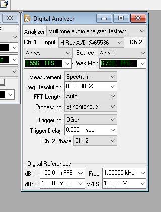

As far as I am aware, you can use the digital multitone analyzer for this. Specify the multitone as the two frequencies you want to use for the IMD.
Or use the digital FFT analyzer as mentioned by Mark.
Jan
