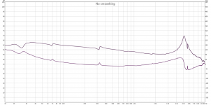

I wouldn't consider it especially linear, but by the same token I don't want to introduce any more non-linearity into the system than is required.
EDIT: Sorry, top plot is acceleration bottom plot is phase
