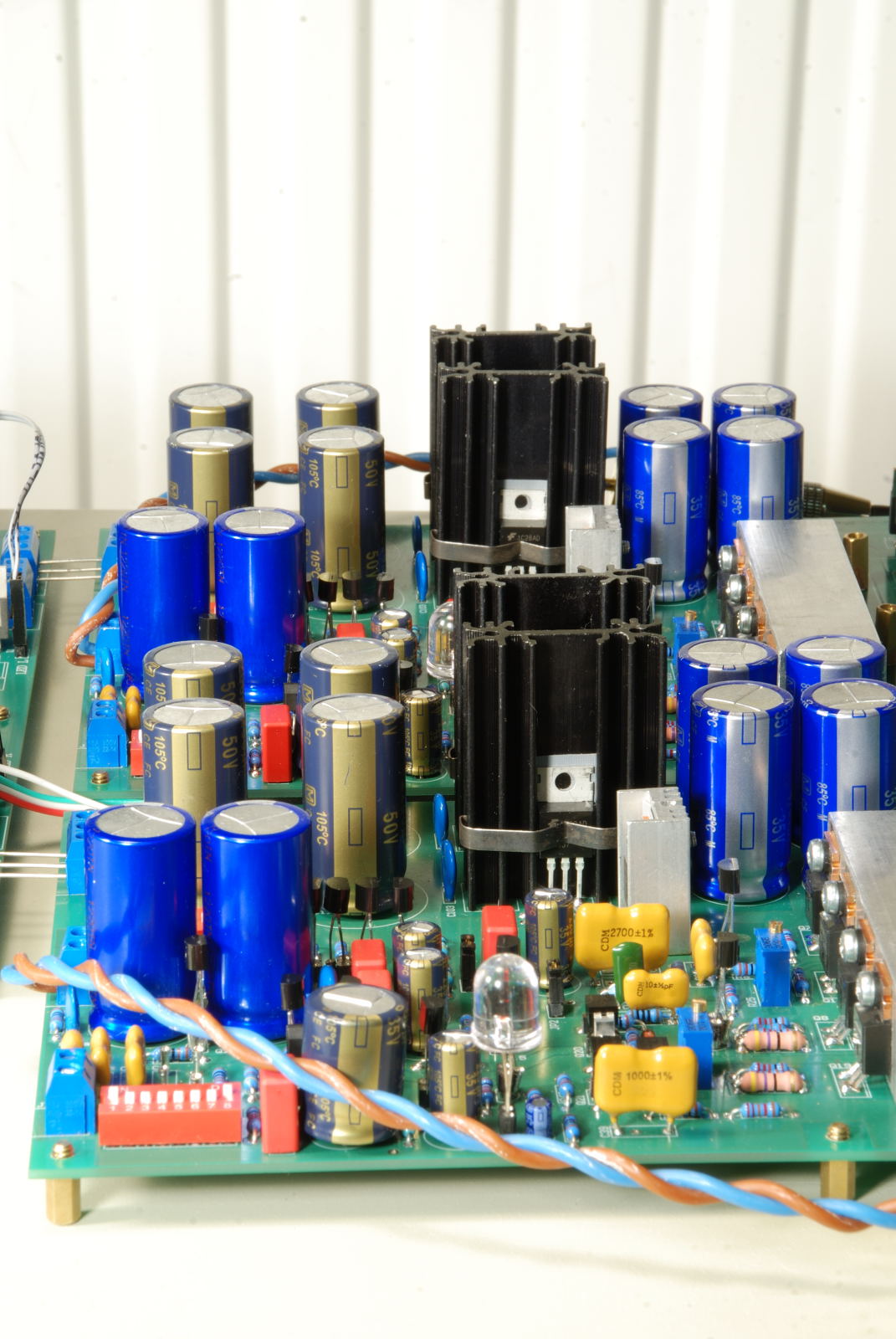

It is live!
Before anyone would think I have miraculous properties,
I must say, I do not have.
Just S1-8 off position available this favorable situation.
It doesn't matter, this is singing for me now. (Without caps.)
We will be good friends, I think.
There is some hum, perhaps because it is on the desk only.
I have made some error during wakeup CH2.
But only a 10K trimmer was the victim of this.

enjoy my freind. it is a sweet phono stage! i have a very low hum when its cranked up no music.
i forgot to ajust the regulators before i fired it up.....i cooked allkinds of stuff. i learned, but the hard way.

I'm still learning XOno.
That hum evidently assigned with cables at the inputs.
At this moment, it dissapeared almost completly.
The dc offset is like chorea.
If I blowing some air on the panel, it is growing rapidly like chorea Sancti Viti.
Perhaps I still will have to build in those capacitors.

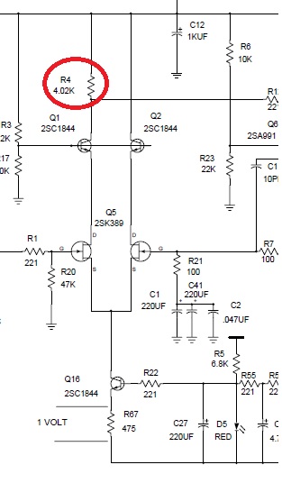

I built an XOno phono stage quite a few years ago and found it easy to eliminate the output caps. I only built the single ended version but the concept would translate to the balanced version as well.
In terms of thermal stability, using dual transistors such as the 2SK389 for the MM input, one gets good matching of the temperature of the critical FETs and temperature drift shouldn't be an issue. If you can't get the 2SK389, then put the transistors on a common heatshink or put them in a little "house" like a matchbox so that they aren't exposed to air flow. They will quickly settle to a common temperature.
To get down to a very low offset voltages, once can then substitute the drain resistor R4 for a 10 turn pot (5K) and dial the offset down to zero. Once set, it has been very stable for me.

I was built it according to Ralph's instructions:
Building an Pass XOno MC/MM-Preamplifier Clone
I have some 2SK389BLs.
Also I have offset setting trimmers.
The output fets are mounted on an alloy brick, permanently for heat spreading purposes.
Anyway I don't too excited about bouncing offset.
It is sounding wonderfully.

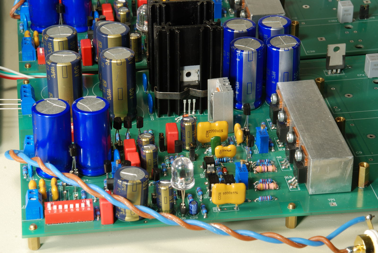

Some new photos about the working amp:

I have some questions about XOno.
Am I right, that MC input fets are running at about 4mA?
Ideal voltages accross R45,46,47,48 88mV?
Mine voltages are between 84-91 mV
And what about Q15?
Mine is there now a 2SK170BL, running at about 3,6mA 200mV/56Ohm.
And how about D5?
Accross legs I can measure about 1.74V, 1.72 on the other side.
I get voltages 1.13V and 1.11V on R67, 1.14 and 1.12 on R53.
Is it good, or I must search better LEDs?
I don't want to change resistors.
The 0.35V on R33 present, a little bit changing on the timeline.
DC offsets are somehow bouncing histerical as I wrote earlier, but I don't get bigger than say +- 0.1V.
