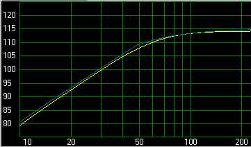

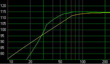

Ok, after a bit of fiddling I managed to get a nice vented box:
Red line = Sealed (50l)
Yellow line = Vented (50l) = Box i got with the sub
Green line = Vented (100l) = What I'm gonna build (tuned it to 30Hz, there not much point in going lower is there?)

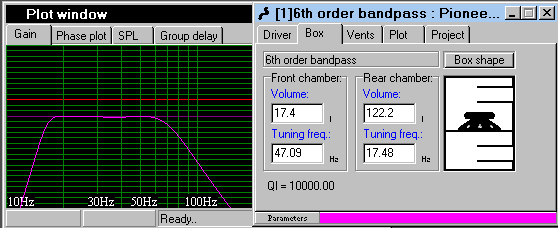

I had a go at band pass, but didn't get any good results.
Opinions wanted please.
Also... Do you think 18mm MDF would do the trick? Would It help If I used battons? (I can get 18mm for almost free you see)
Also, I was thinking of mounting the amp on the side of the box near the top (away from the middle)... Is this a good/bad idea?
Lastly, this is should sound good, yes? (well, I'd be happy if the green line is gonna sound better than the yellow one).

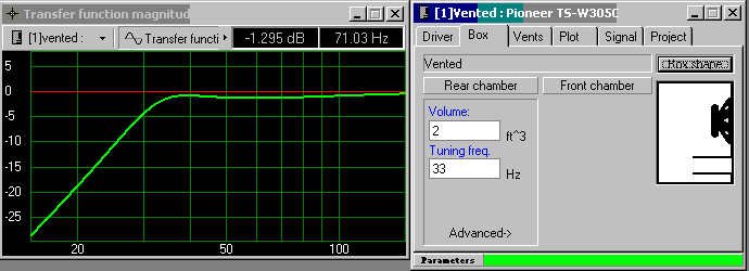

Firstly=use winisd pro
Secondly=
2 cube 33hz tune looks good
1x4" port 32cm long
that gives less peaking action.Dont forget cabin gain.u may need to EQ down the bass(better than not having enuf and sucking up power)

Some older sedans have next to no ready opening to fire a sub through so a bandpass enclosure is required; (note, the middle speaker grille is the port)
an important thing to note with bandpass enclosures is that, typically, a "by the book" enclosure won't sound the best, and a higher tuning frequency than normal is required to prevent the enclosure from sounding mushy/boomy.

I just looked at the red line in the WinISD graph (which is for the sealed enclosure) and thought that it would sound bad since the low frequecies drop of below 100Hz (ie, not a very flat freq response), or does it somehow cancel out cabin gain?

I see what you mean about the peaking. I had another go with WinISD pro, and found that 80l (around 2.8 cube) tuned to 30Hz also gave a flatter response than my previous 100l design.mikee12345 said:Firstly=use winisd pro

For the Yellow curve, I tried to model my current box. I went thru WinISD backwards. I measured the length and diameter of the port, then kept adjusting the tuning freq in WinISD till the port size roughly matched. I put it in so I could see how much of an improvement a new box would be.SkinnyBoy said:50 litres tuned to 30Hz... and I have no idea how you got graphs looking like that..... (I didn't try either.. lol)

You're sure did a better than me... I deleted most of my bandpass attempts cause they were so bad.Circlotron said:
I've never built a bandpass. Some people say they are difficult to get going properly, but, FWIW...

12inch Pioneer in a 40 litre sealed = green...
two 8inch Venoms in 20 litres each sealed = yellow
Two 8inch subs fits better on a parcel shelf than one 12 does..
(please note, the 8inch sub reponse may be a little generous as I cranked up the X-max so that it wasn't limiting the max SPL... you should still be able to get this SPL, but not with a sinewave input)
thats the max spl calculated by rms power and x-max.... so... Venoms might be alright... (basically I'm tryign to convince my friend to get two $50 8inch woofers rather than one $200 12inch sub,.... )

SkinnyBoy said:12inch Pioneer in a 40 litre sealed = green...
The venom 8"s give every impression of being a tough little sub but it's look writes a cheque that it's suspension can't cash (that big rubber surround is, unfortunatly, mostly for appearance)

you could even do the Venom 8inches in like 20 - 30 litres ported..
Dont go increasing xmaxes now
look at the EBP of the woofer
Its well into the ported box range.
Sealed -3db @ 70hz
Ported -3db @ 40hz,or 30hz with 2 cubes .More possibilities
Personaly,i dont take into account cabin gain that is UN MEASURED as everyones gain is different!
+ i hate sealed box properties of raising the Fs,increasing distortion in the midbass
where as ported is dampening the cone near there.
In my opinion -3db @ 70hz is too crap
-3db @ 40hz matches the generic gain curve better.

Sealed or ported... the dilemma continues
I finally got round to reading http://www.diysubwoofers.org/ and it has some very good info on there. It got me thinking that a sealed is better since it claimed that some cars have 18db per octave of cabin gain below 80HZ! That seems an awful lot - building a crossover that has 18db/octave is a task in itself, so sealed seems like a solution. I think I now understand why many people say sealed sounds good, despite the un-flat frequency response.
I doubt my car has 18db/octave of gain tho, but it would be nice to know how much cabin there really is. Maybe I should try some of that room analysing software in my car?
But in the otherhand, I'm really tempted to build a box with a flat freq response (or close to it), and use EQ to cancel out the cabin gain. I currently favour this option since I occasionally bring the sub in the house for house parties, and such like, where there is no cabin gain at all (I guess I should've mentioned this earler).
Since you've used these drivers before in a sealed enclosure, can you tell me what they sound at the lower frequencies... Would 30Hz sound good, for example?
Also, as bang for buck goes, this pioneer almost unbeatable. It can be had for around £50 here in the UK, which is much less than $200, and maybe less than 2 of the 8" woofers you mention.
By the sounds of it, ported gives much deeper bass, and my midrange and highs are also more than adiquate:
