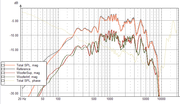

Now, I've properly calibrated the Z distance in LSPCad, and everything matches.
But, my question is:
Since I measured each speaker individually, wouldn't that mean that, when connected in series I shouldn't get any gain whatsoever?
As it is, LSPCad is telling me I'm gaining 6 dB from connecting both speakers in series. I assume that, since I measured individually each driver, there's no way for LSPCad to know about this.
Then again, I have compared my measurement of both upper and lower woofers with the simulation of LSPCad. And they are both the same in magnitude!
Is this OK? Can I expect +6dB when I connect woofers in series? I thought this was the case with parallel drivers.
Here's the LSPCad screen I'm getting... thanks for your help!

Hi
Looking at your graphs I see closer to 5 dB increase.
Theory predicts 3 dB increase due to adding double the radiating surfaces only. Not too sure where the 2dB error is from but since it is uniform in frequency, perhaps a distance calibration error?
I break the problem into the acoustical (efficiency) gain and the impedance sensitivity difference.
Consider that for two drivers connected in series you have doubled the cone area so the acoustical improvement is +3 dB. But you have doubled the impedance (say 8 ohms to 16 ohms for 8 ohms drivers) so that the sensitivity difference is -3 dB. The net improvement is the summation of the acoustical and sensitivity which is +3 -3 = 0 dB change.
For parallel drivers the acosutical improvement is +3 dB (doubled cone area) while the impedance is halved so that the impedance sensitivity change is +3 dB. The total is +3 +3 = 6 dB.
The usual caveat is that their sound fields must overlap. This usually means that their center to center spacing of the drivers must be less than one wavelength at their highest freqeuncy of operation.

Jim you are correct in everything you say, but look closer at the test. The circuit never changes only the mic position.
I should have made that clearer - I never moved the mic from its position in front of the tweeter. Neither did I change the distance in JustMLS. All I did was switch cables from every driver.
Jim, I'd assume your post to be correct: +3 dB from double the area, -3 dB from doubling the impedance, 0 dB net gain. But the measurements I took with both woofers in series are the same LSPCad predicted for the circuit.
It makes no sense to me!
Should I scale the driver's SPL data to -3 dB each? or -6 dB? Maybe I could scale both drivers' output to equal one driver output...

I've given some thought about this situation, and I remembered I took a measurement with both woofers in series and the tweeter in parallel. I'd assume this is the "real" reference for the SPL levels between tweeter and woofers, so, as long as my simulation reflects these levels, I'll be OK... I mean, the real issue is the relative level between woofer and tweeter... so my "all drivers wired" measurement should be my reference level... right?

As long as you the "designer" feel comfort that your measurements are really reflecting theory. Then all is good. I would try to find the error by repeating tests with some better accuracy. Maybe try near and far microphone tests with out changing the woofer circuit. The difference should be +3dB with calibrating for distance losses. In addition, as Jim pointed out the tweeter referenced at the amplifier terminals will be 0 dB from the two series connected woofers far field. Clear as mud now?

I tried another new thing. I loaded the parameters for one woofer and saw the frequency response graph. Then I told LSPCad there were two identical woofers in series (in the driver configuration section). I got something like +3dB out of it. I then configured the drivers in parallel. The difference was +6dB this time. It still doesn't make any sense. By using the driver configuration section, LSPCad should know the difference in amplitude should be 0 dB with two woofers in series, but it simulates +3 dB. And, the weirdest thing of all is that this simulation equals my measured response.

Sounds like you have to dig into the software. Maybe the difference is the software reference uses power vs voltage. Or possibly, don't tell the software that you have 2 drivers and believe the theory that you know.
I fully agree with you.
I was thinking - there's no way for the software to know I did a measurement at X power rating to a driver, and that such power rating will be halved when two drivers are connected in series. I assume the software will just see two SPL measurements and treat them as if they were independent from one another.
I'll use my reference measurement (all drivers driven in phase) in order to set up manually the woofers' levels.

Well, the mistery is solved. There's an increase of around 3 dB. I used the crossover I had already designed, and it sounds perfect. It measures exactly the same way as predicted.
Now I'm happy, and have some new toys to play with. Thanks a lot for your help!!!

I think there must have been an error in my individual measurements of the woofers. I can't imagine what it could have been Thankfully, the reference measurement was correct, so the speakers came out fine.
I need to find out what happened. I still can't understand it.
