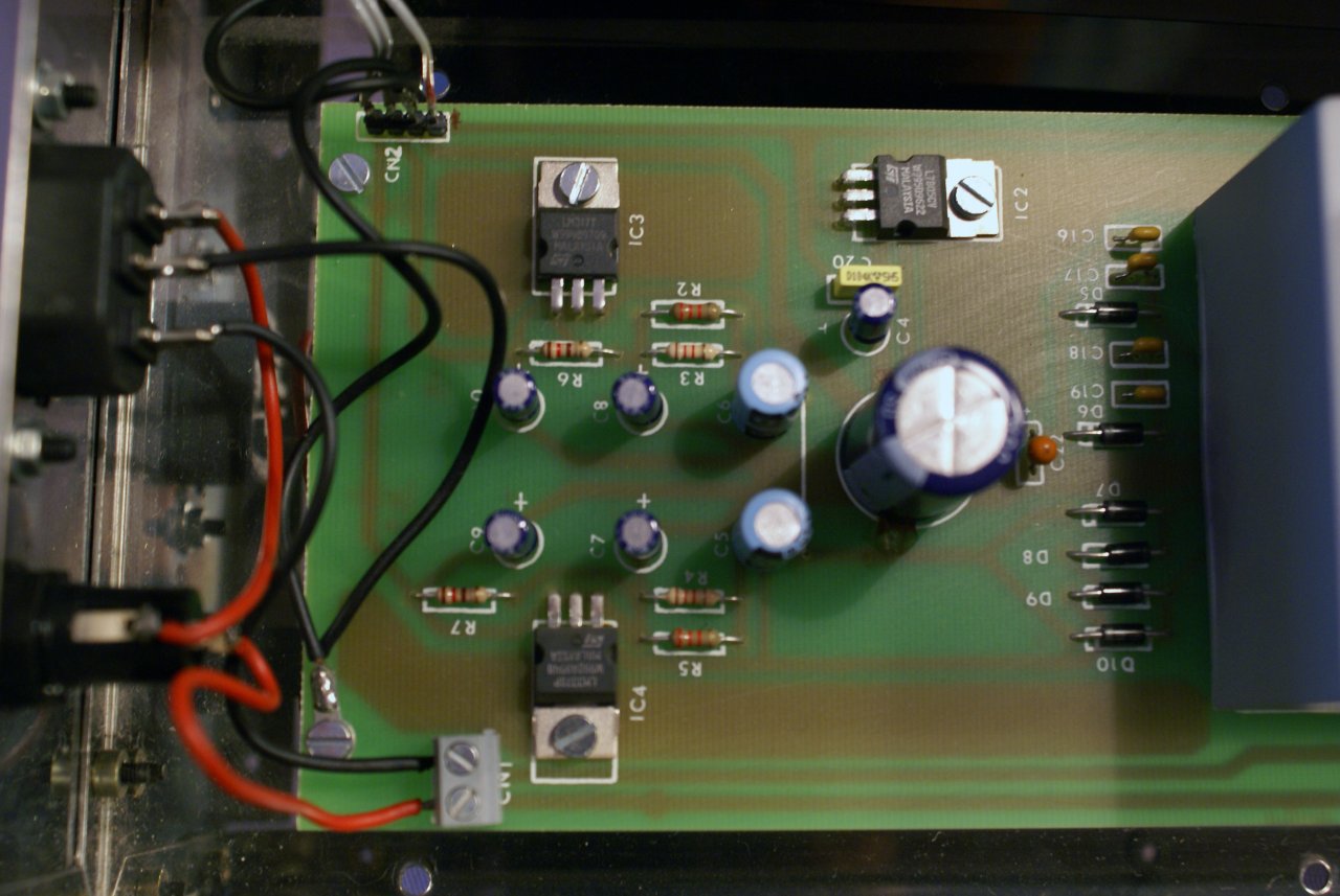

A filter that includes an earth line should be better, am I right? I know the basic schematic of both types. But which values have to have the filter LC components, how can I chose the right one? There are so many…
Are the line filters they any good for CD transports/players? Can they make the sound worse in some way? My CD transport is Audiomeca Mephisto
If your CD/Transport has a 3 core mains lead with the earth connection in use i.e. it is connected to some point within the equipment (case, PSU ground etc) then use a filter intended for use with an earth line.

If the player is 2 wire, then please don't introduce a earth connection inside the player. If so you can still use a filter> be sure to select the medical grade (no capacitor connections to E) If you start adding a ground to one that does not exist before, it now becomes a complicated system design issue and trouble awaits the novice. The higher rated current within a given series has more filtering in general.

No, there is no filter, please look at the picture. I have already looked at www.schaffner.com and found this one . It should be the best one from schaffner. What do you think?
As you can see on the picture above the player has 3 wire power supplies (with earth connection) so I do not need to add a ground. The power supply is not SMPS but with LM317/337, L7805 and L7815. I will make a completely new power supply with 3-4 transformers.Hi
