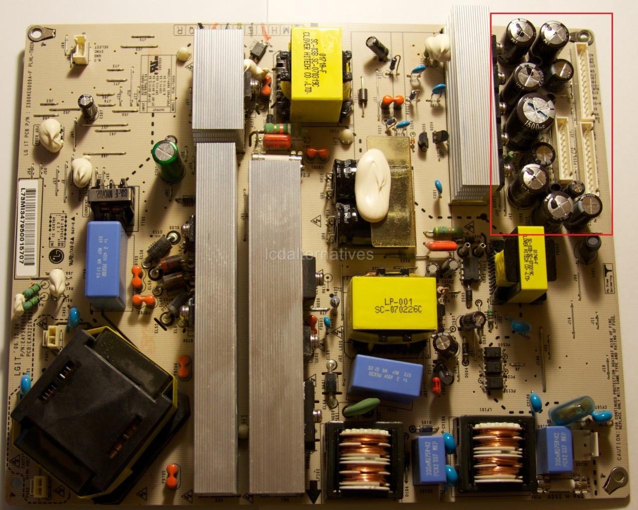

So I managed to get my passive 3D projector up and running with the LG panel... but then I thought I'd adjust the screen on the fly... in doing so I must have caused the metal frame around the screen to touch the circuitry or something nearby and the whole thing just went dead... the monitor control panel no longer indicates anything is going to it. I'm hoping it is simply one of the components that got overloaded and that perhaps I can remove that and replace it with a new one (if I'm really luck perhaps I can even salvage the part from a previous monitor tear down).
Does anyone have any experience or knowledge of what may be the likely issue in this situation? I can provide an image of the circuit board if that will help. The capacitors all look fine, no visible bulging. The (I believe it's called the inductor) has what appears to be a yellowy orange resin like substance on all four sets of coils... might this be a sign it got overheated and failed? If so could I just replace this part and hope for it to work again?

They are just chokes (inductors) and look to be on the supply input side. They will be fine.
If you shorted something out then its 99.999% certain that the damage is going to be failed semiconductors... and with it being a man made fault the failure won't be "logical". You will be looking for collateral damage as well.
Although nothing to do with the man made fault aspect, some of the caps (top right) do actually look as though the vents are lifting... unless its an effect of the photograph.

Thanks Mooly... I should have been more clear... these images aren't of my power board... I was just trying to find an image of a similar component (simply because I haven't put a picture of my actual component online anywhere to be able to link it)... Part of me does suspect this will be beyond my ability... but I'm happy to give it a go... at this point I can't really make it worse than it is in that I can't make it work at the moment anyway. I just know it took me a long time to source a 3D passive monitor and figured I've got bits from previous projects lying around (and a good electronics store nearby) so if it's a case of something can be replaced that will/may well fix the issue, I'm happy to give it a go.

You would need to come up with a circuit diagram to stand any real chance of fixing this.
You might get lucky and find there is a CP (circuit protector) or a fusible resistor that's gone open circuit but without seeing a circuit its impossible to say. If any of the power semiconductors on the heatsinks have failed short circuit then that's a sign that there could well be other damage. Although the parts won't be unique and unobtainable, they are almost certainly not off the shelf common items either.
Unless you can find a definite problem then I suspect that is the only viable option. When things short out accidently it can have a habit of causing component failures all down the line.
If those components in the picture are OK then you will have full rectified mains across that electrolytic cap. For 120vac that means a DC voltage of 170 volts and for 230 vac mains a DC voltage of 325. If that is present then those parts are all OK.
