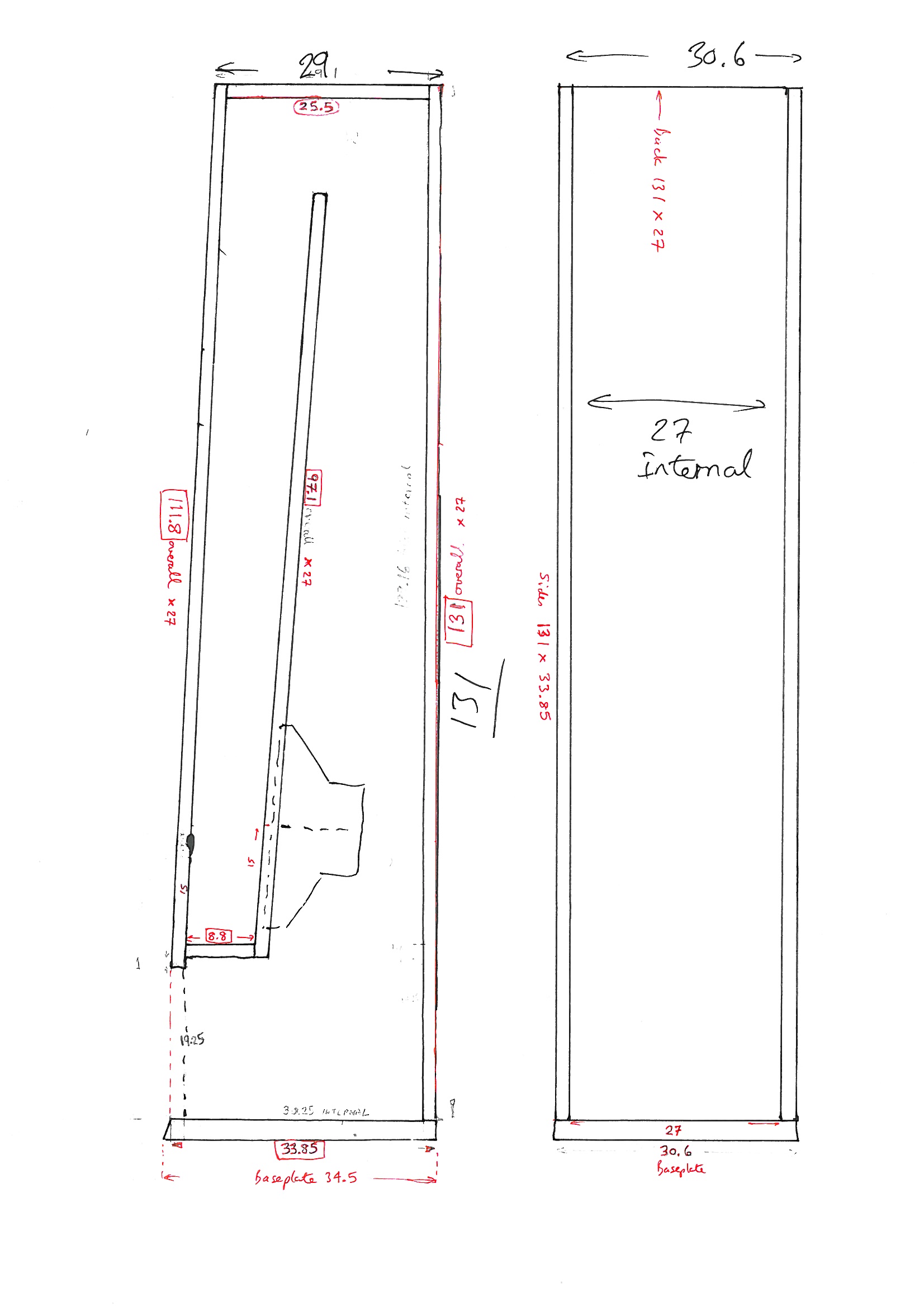

Project is in full swing ( much quicker than my last one ) . This weekend, I drew out and finalised the construction details, mainly the top fold issues . I also drew up a cutting plan for a 4' x 8' sheet of 18mm MDF , which may get cut this week ( with luck ) by my wood supplier . I also made one base panel from 25mm ply .
Briefly, the form of this speaker will be a pillar about 130cm height , 33cm deep and 30cm wide. These are outside dimensions . The mouth is 19.3 x 27 cm . Above the mouth, the front baffle slopes back a bit - 2.4 degrees - to a slightly smaller top area ( about 29 x 30 cm ) . This is due to the four-section horn expansion, which is necked-down a bit at the halfway point . It's rather similar to JLH's 40Hz unit, except for the sloping front , and I'm going to make the base panel removeable to get access to the driver, rather than having a rear-access panel .
I will try to scan a picture of the layout in next 2-3 days .

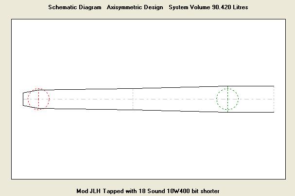

Just as a reference point for others (since you design is fixed), the crossover design can complement the roll-off of the cabinet.
In other designs I have used a low-pass filter with a high Q to achieve a LR24 transfer function (6dB down at the crossover point). In the case of the first out-of-band peak in the TH, either a damped 1/4W stub or an electronic zero (notch) will be needed. This can extend the usable bandwidth about a half octave or so.

Hi djk
That's an interesting pic, and I've seen it before, it's starting to make a bit more sense, but I'll fire out a couple of Qs :
(i) Are the pipes tapping into the extreme throat end of the taper ?
(ii) Are these just resonant pipes with a 1/4W length chosen to reduce the first 'problem' peak, which in my case would be around 160-170Hz ?
or (iii) do they duct air from the throat into the second part of the line to cause some other effect on the horn loading ?
This is very timely information anyway . Anything to reduce the burden of electronic correction is v.important in my books .
Now, 1/4W at 170Hz is ...50cm .. hmmmm

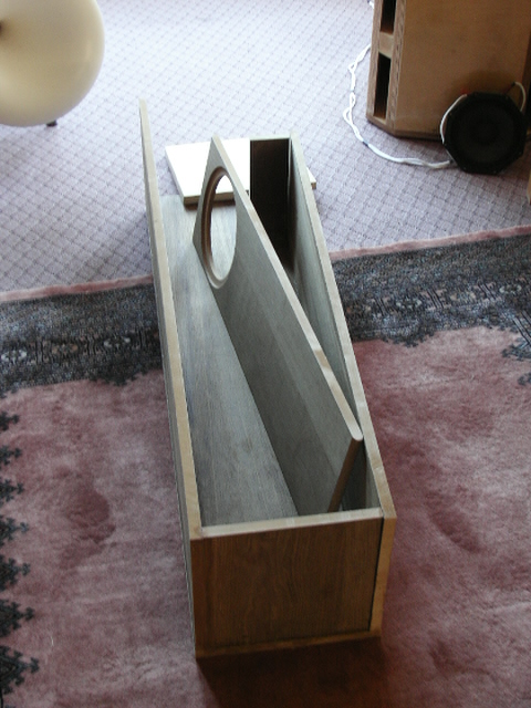

One pic of construction as of this afternoon . Some parts glued-together , others just prepared . Going very well, helped by the fact my timber supplier cut the pieces to about +/-0.5mm accuracy !
I may be held up quite a bit now by lack of drivers, because I wasn't confident to cut all the fixing holes without marking-through from the real speaker . That means I also can't fit the internal panel yet . I will work on some details ( baseplates ) and source the remaining wood I need to make the 2nd unit .

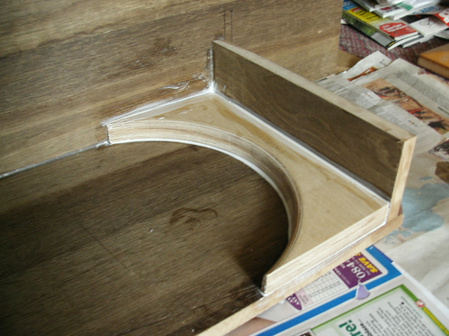

So, I've been working on details, and getting pieces done for unit 2 .
Shown here is how I've decided to squeeze-down the beginning of the throat volume as per the model . I haven't acheived quite 120cm^2 but it's about 150 now. This piece of wood is incidentally cut from the front panel of the abandoned Onken project !
