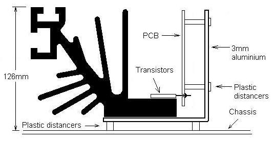

whew, another question.... This is for those with lots of heatsink experience.
I have these two metal plates and there will be ten transistors for each plate. I want to leave the collectors of each transistors connected to each plate directly.
I have two options here:
1. I can have 5 matched pairs on each plate with thier collectors common for the output. This means that the plate would be connected to the speaker output. I guess this means I'd have a very easy way of connecting fat speaker cables.
2. I can have all the PNP transistors on one plate and all the NPN's on the other and use the plates as supply rails. This means the amp would be emitter loaded. This also means that if you run one channel, the other channel's transistors will be heated.
Which seems to be the better idea??? I really don't want to try insulating the collectors from the heatsink, especially since I'm going to have the transistors and heatsinks fairly open on the sides of the amp. I mean, yeah, the whole plate on each side will be live but it's better than making it easy to short the transistor to a grounded heatsink...
Hi.
Right said Pinkmouse.
Duo,you have to redesign the whole thing.It's not a good idea.
Bellow is how I'm going to resolve this thing with the isolated
heatsinks in RMX4050.Maybe it will be usefull for you.
Dimension of heatsinks:120mm wide,120mm tall and 360mm deep
Regards.
