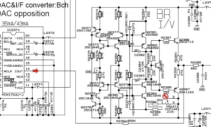

Hey, i'm new to audio electronics in a sense, i'm currently studying I-V Converters for my first DAC which employs a PCM2707 and PCM1704, similar to that of many designs i've seen around here. I know I could buy someone elses PCB and simply solder the components, but I rather build it from scratch.
The PCM2707 is not a current output DAC so no I/V converter is required for that one.
The PCM1704 is a current output DAC and does need an I/V converter.
Which one are you talking about?

Her are two examples of a different approch, that is common base/gate that also represents a very low impedance, but doesn't necesarily use high-feedback opamps.
peufeu from France
...and Pioneer ODR reference car audio system ( YES ...for CAR ... but extremly well sounding) :
Ciao

It wasn't the only one advocating such a configuration. Jocko Homo I think was the first (now is banned here, moved on a pesonal forum).
Requires special transistors (hard to find and need matching). Per Pass measurements the average THD is 0.01%. That is -80dB or less than 14 bit resolution (and not adding the noise).
Other aproach: Marantz tried the discrete OpAmp HDAM from 90's (in CD-63-SE for example). I still have to hear one to belive it.
Mark Levinson and Musical Fidelity tried the path of discrete OpAmps too. Burson Audio sells them too. Heck, even I buid a few (bipolars, jfet) in 80's.
Again, results are nothig spectacular compared with the new crop of integrated OpAmps.
