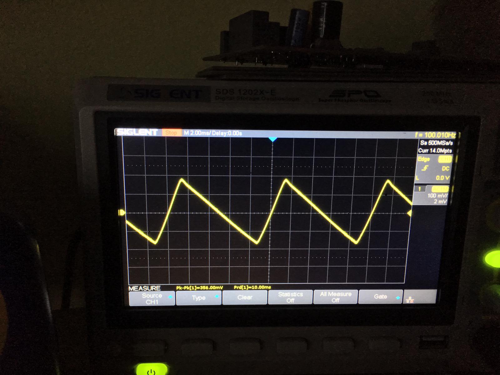

One thing I am unsure of, is how the transients of the resulting sawtooth wave looks after the bulk cap? Does it even look like a diode sawtooth? Or will it be a total mess? ...
At full load on my Zeno regulator. Measured directly on the cap after Saligny.

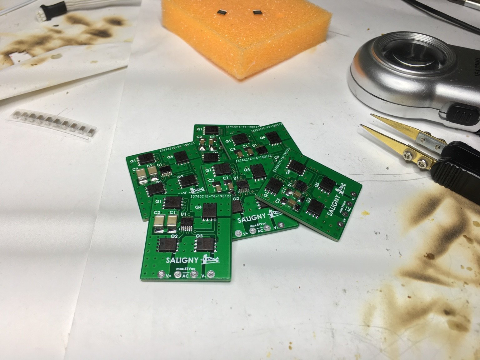

Hi Tibi,
I'd like to use this on a CCRC PSU for a Class A amplifier, which will be using 3x 68000uF, 8 mOhms ESR caps per rail and the R will be 0.1 Ohm. I was planning to use two bridges for the PSU (one per rail). Do you think the inrush would be too high for these bridges?
Do
Saligny will handle very high peak currents, far above your transformer capability. What you need to take in consideration is your trafo secondary that, for sure, will need to deliver serious current to keep these caps charged and as xrk971 mentioned, low ESR is not the right choice in class A operation.
