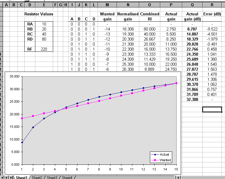

Hi Jan,
I've not spent a great deal of time on this, but I can't see why it shouldn't work just fine. Although perhaps you won't be able to get nice 1dB steps - this is my only real question at this stage. I'm guessing that this is what your reference to log tables means?
As a quick "proof of concept", I ran it through Excel (no access to simulators at work!) - here's what came out for a simple 4-bit sequence, using binary resistor values of 10, 20, 40 and 80K - I made the feedback resistor 220K, as this is a typical GainClone value. The 15 steps vary the gain from 32.3dB down to 8.8dB's - a typical GC with 10K/220K has 27dB
The purple line is simply what you'd get from 1dB steps and the blue line shows the calculated response. As you can see, the response is quite nice - there's plenty of resolution at higher settings, and larger step sizes the quieter end - just what you need, IME. The model was for 3 relays initially, and the curve was the same shape. If there is enough interest, I could try and expand it to include more relays tomorrow (if I get any spare time). This would bring more range, which is probably preferable for a real implementation.
Hope this helps,

Hi Mark,
Yes I was referring to the error you get when trying to get linear-in-dB range with binary steps. But your curves are not that bad. What about using one extra relay to switch the 22ok between two values? You could use the 18-32dB range of the 4 bit thing, which is pretty linear, and use the extra relay to say shunt the 220k with a resistor to lower the gain by 18dB, bringing your linear range to full 32dB. Does that make sense? It would mean you need some logic because you no longer have a nice binary count. Or maybe you do have if the extra step is made 16dB.
Jan Didden.
