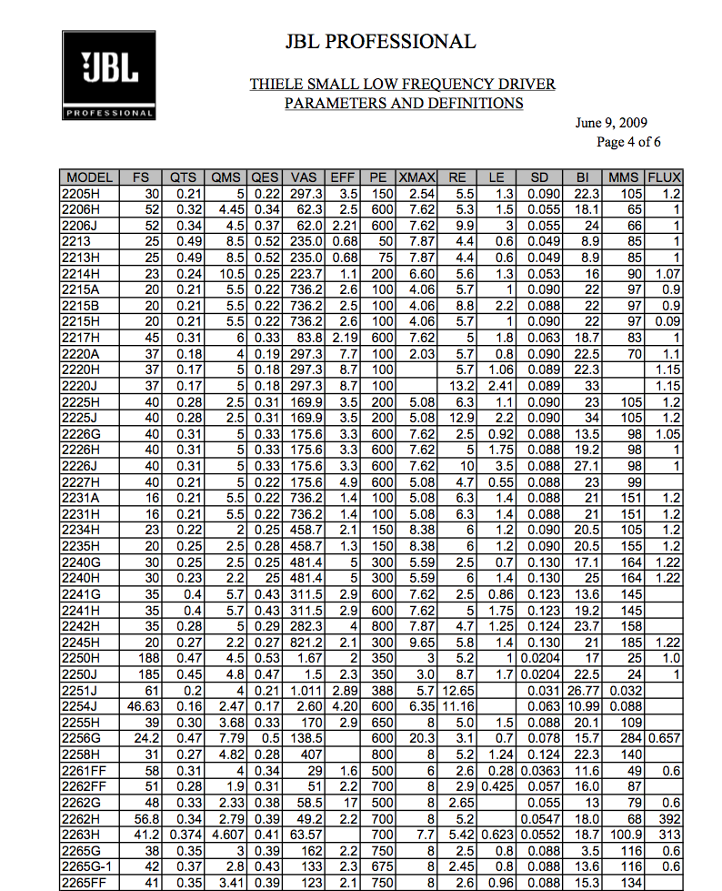

Can anyone point me in the direction of JBL driver info? I am lost in a sea of 220X drivers and no idea what the differences... From what I can tell I can pick up some drivers for nearly the price of a recone job $120ish. Was worried we were talking $500 boutique JBL stuff...

On the JBL side to me the highest sound quality 15" midbass horn driver is the 2220, then the E145, if you are going to beat them to death use a 2227.
The 2220 has an underhung voice coil and a light cone that sounds great in a horn. If you are really hard on them you can wrinkle the cones but never in a mid bass application in a house. JBL still has 2220 cone kits on the shelf.

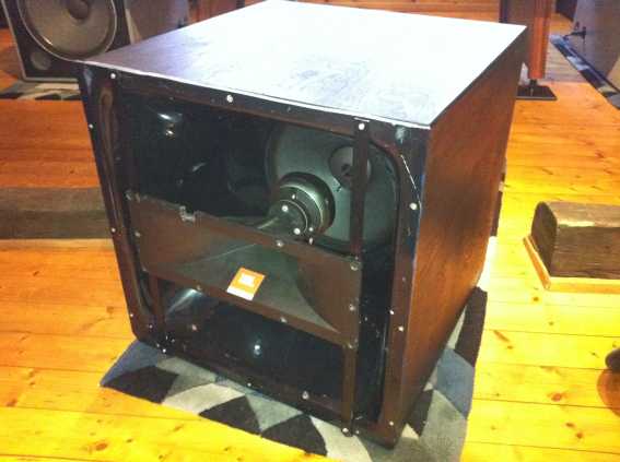

Mine (soon to be) appear to slightly different with the KEYSTONE shaped vent. Maybe a custom thing, I don't know. Here's what they sent and I have requested plans. Maybe my buddy measured them wrong but it appears the cabinet is oversized from the original plans. Once again maybe a custom thing.
Even cooler is this pic I found which is exactly what I had envisioned including metal bracket...

Mine have the keystone vent as well. These I have never found a spec sheet for. How different they are I don't know.
