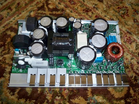

I talked to the guy who has these today and he said that B&O does not supply the wiring so you have to do your own wiring. Shouldnt be to hard.
I am sure I can get the harness from him but it would cost more. I can ask but wont until you are ready to buy. I dont want to bug him as he is really sick right now and I dont mean just a little sick. We talk for 5 minutes and he is starting to fade.
Anyway I have pics of the 1000ASP.
Here are a bunch of them online Picasa Web Albums - Uriah - DEC2010
I will upload one here and then you can go to that previous link and see the rest of the pics.
Uriah
Uriah
