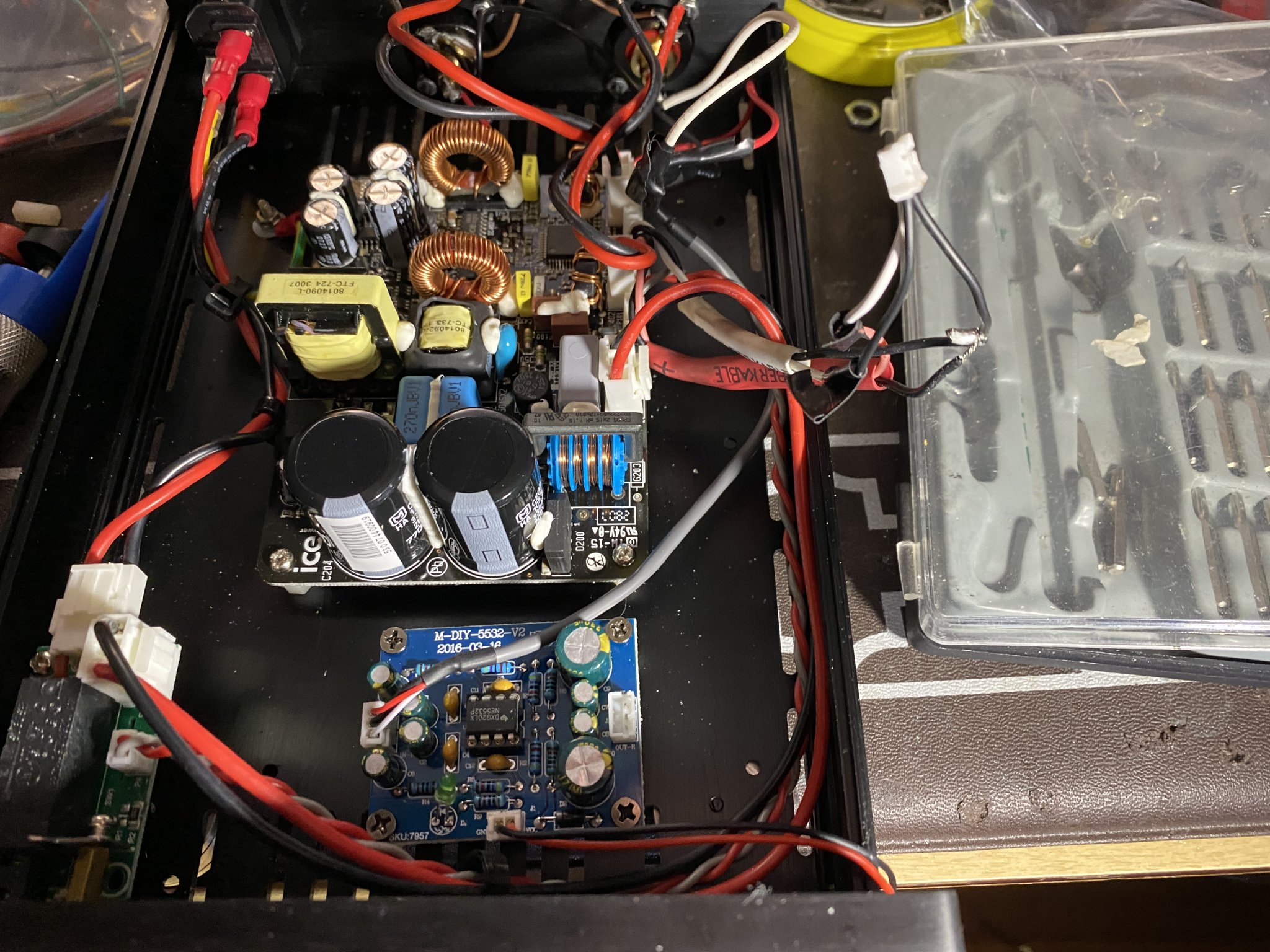

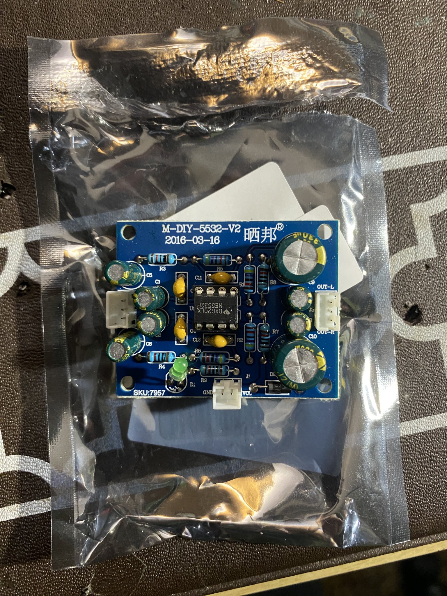

I have a 50ASx2se I have built into a ghent audio case and I wanted to know if this board here that I received by accident can be used with this as a Buffer. Its aOp-Amp pre amp board. It only has one Op Amp. DO I need a buffer with dual opamp? I am running the icepower single ended RCA and plan on going just output of my Dac to the icepower. If I can use this do I go from RCA input to the input on the board and then from audio out to the 7 pin connector input on the icepower?
Hi. It’s this. Guy here. DKARDU NE5532 OP AMP HiFi Preamplifier Signal Amplification Board DC12V-35V NE5532 Preamplifier with 28awg Cable DC Female Cable for Bluetooth Pre-amp https://a.co/d/hJnlz7U
View attachment 1140796 https://a.co/d/hJnlz7U Its this unit hereCant see the RIAA compensation parts... so, very unlikely it's a phono preamp.
Based on resistor values, it looks like a buffer.
Any chance you can show what the PCB markings are for this connector?

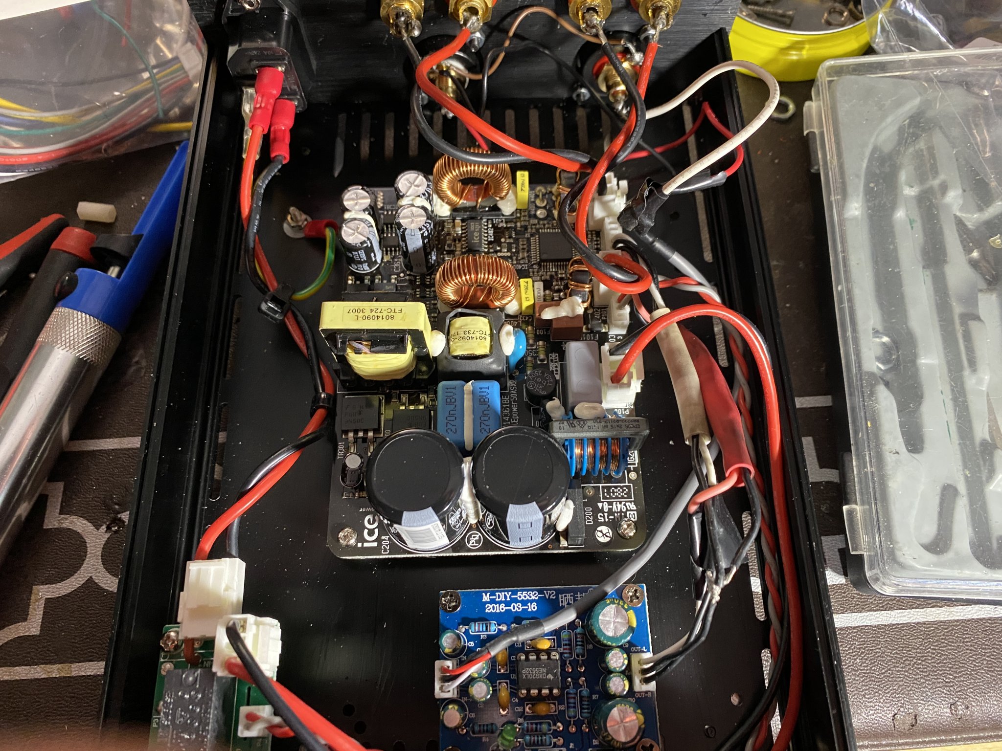

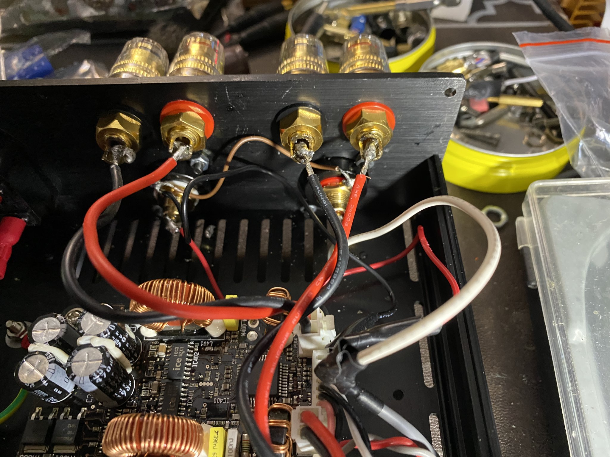

Wired it up and Im getting buzzing from Both speakers like a bad ground. I ran from the RCA in to the in on the preamp board. I tied both the grounds on the RCA Lug together with jumper wire and then the ground to the middle pin on the 3 pin input on the preamp board. Then I did same on outputs. For power for now I ran a seperate 12v dc to the preamp dc input. Heres a pic of it hobbled together. ANy ideas?
Went at it again today, Im still getting a buzz from both channels, it doesplay music but is like interference sounding. Ive tried rerouting the wires. ANy ideas? Im feeding the preamp board 12v DC from seperate supply for now. Am I safe to use the Auxilary power instead of this?
So do I need to Add coupling capacitors at the output? Im running it as is and im getting a lot of static etc. Im powering this preamp board by itself with seperate 12v supplyIt will serve as a buffer. It does not require a symmetrical power supply (like Vcc/Vee) - so, it will need the sound coupling caps.... Nevertheless, it can be used as a buffer.

No, they are included on the board.Yes you do: with a single 12v supply you'll have 6v dc offset at output without use of capacitor.
Might help regarding some of your issue, not sure it'll cure all of them though.
The Buffer has a 5x gain. Reduce it to 1-2x.
You can take two 9V block batteries and clip them together for 18V. So you can feed it ground free for a test.
If still buzzing, you constructed still another ground loop. One ground should be enough.
If you decide to keep it, change the op-amp for an NE5532 from a reputated vendor. These fake 5532 sound terrible.

Ok i think there is misunderstanding: is the board used as is? If yes it is in no way a buffer as it gives 14db gain...
My comment was in case Gaspar74 modified the resistors and maybe caps and decided to run on a single rail supply rather than a dual one.
That said i agree with you Russc, is there a need for a buffer in this case?
Gaspar74 what made you thought you would need a buffer?
