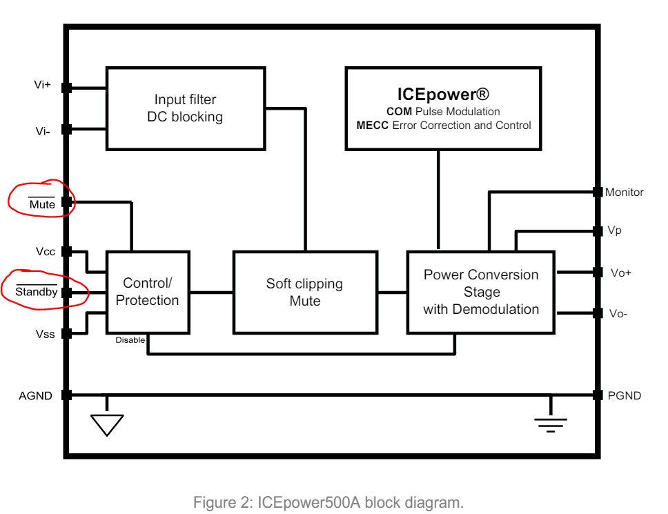

I'm trying to see if an Icepower 500A module pulled from a subwoofer is working. The original SMPS is definitely not, so I'm testing it using a linear supply from a Pass F3 build at around 53V (without load) and a +/-12V regulated supply built on perfboard using 7812/7912 type regulators. I think I've got everything connected as the datasheet says.
There's no sound, which may mean it's dead of course, but my question is what voltage I should be seeing on the Mute and Standby pins. The datasheet says the board pulls these "high" automatically, but I'm measuring 0.7 and 0.6 volts, which doesn't seem very "high" to me; I would have expected 3.3V or 5V, or something. If these are low then it might mean the board is duff, or maybe needs to be "reset" somehow, perhaps by pulling them high? (Although the datasheet is pretty clear this is meant to be automatically done by the board.)
Any help much appreciated.

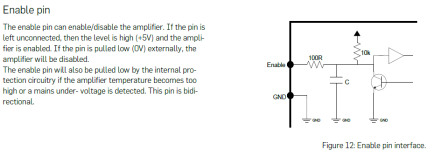

I do not think that it will survive 12 V, if it is similar to the 125ASX2. This one has an internal pull up. The pin will be pulled down internally through a transistor (except for a 0.7 V voltage drop) when the protection circuitry activates. Logic levels are +5 V and 0 V.
The 0.7 V suggests that the protection circuitry has activated, unfortunately.

Fig 14 & 15 make it clear that they are referenced on Vcc which presumably is the high voltage V+.
So you'd need to pull them up to that.
Correction: it says: Vcc JST** Pin numbering Positive power supply input for the signal section.
So that's NOT the high voltage supply.
It looks like YOU have to provide Vcc and Vss, and if you don't it won't work.
Table 3 says you need to provide +/-15V. See table 4 for the specs. So your amp probably is fine.

TBTL: That would explains the 0.7V! So it sounds like the protection circuitry is activated. If I understood the datasheet correctly, the protection circuitry is meant to be briefly activated during powerup, and then the pin is pulled high by the board and you get sound. If something is broken and the board isn't doing that then the 0.7V is explained. Of course the board may have triggered the protetction circuitry because of something I've done, I guess... so I'd better check things again. (This is the 500A, not the 125ASX2, but I doubt that makes a big difference.)
Jan: Now you point it out, Fig 14 and 15 are pretty clear; thanks. But the datasheet uses Vcc to refer to the 12V supply; the -12V supply is Vss, and the high voltage 80V supply (or 53V in my case) is denoted Vp. So unless I've misunderstood (always a possibility! Please correct me if so!) I should try pulling it up to the +12V.

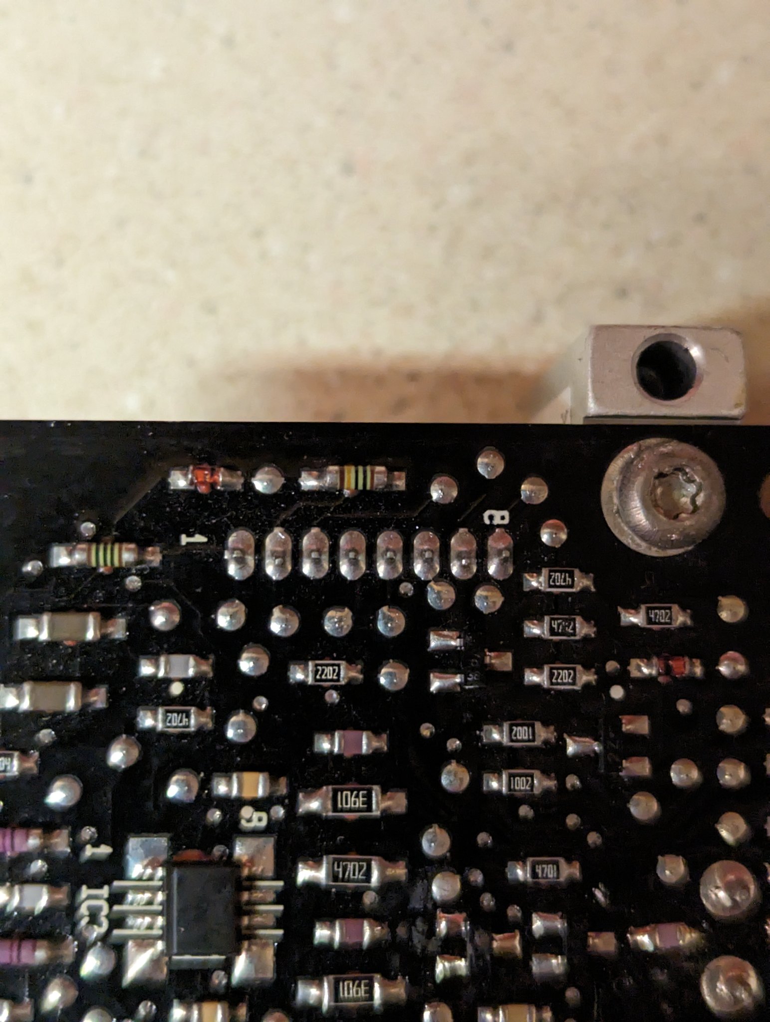

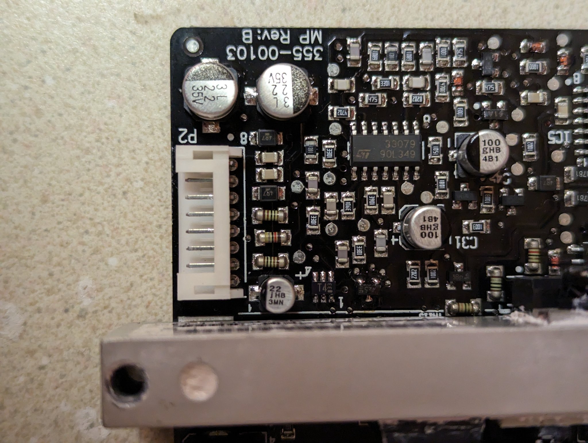

The second and third attachments are photos of the two sides of the board. I was working on the solder side, as in the third attachment; the other side was hidden by the panel the board was bolted to. When I took the board off the panel to check for burnt components I suddenly wondered about the numbering again, and I found that the numbering of the pins is different on the two sides of the board. In other words, the pin marked 1 on the component side is marked 8 on the solder side, and vice versa. You can see in the photos that the pin nearest the aluminium heatsink bar is numbered 1 on the component side, and 8 on the solder side.
In other words, Icepower uses their numbering on the component side but the the JST numbering on the solder side.
So I reconnected the JST connections things in the other order (meaning pins 1 through 8 in table 2 in the Icepower numbering are connected to pins marked 1 through 8 on the component side of the board, not the solder side.) And the amp produced sound as expected.
