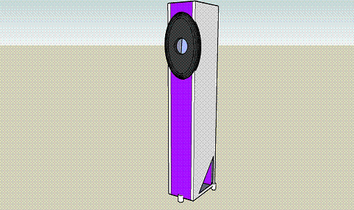

While there is no "k" in this iBIBk, here's another variation, based on something I saw somewhere. I simply calculated the Sm of the bottom (without the k slot) and translated it into two triangles on each side. What would this do for the sound? It looks nice, and maybe it would sound nice in a corner?
My apologies if this is irrelevant to the discussion.
If you set the right variable in a k-slot forumla (ie the coefficients on any 2nd or higher order variables) you should be able to get a triangle, so this would be the simliest of k-slots.
Since you have a bottom on the box, the triangles will ned to be bigger (and no need for feet -- even an argument that they are counterproductive). The net effect of those 2 changes would be to push the range of its effect up in frequency. Could easily be countered -- if necessary -- by lengthening the pipe.
dave
