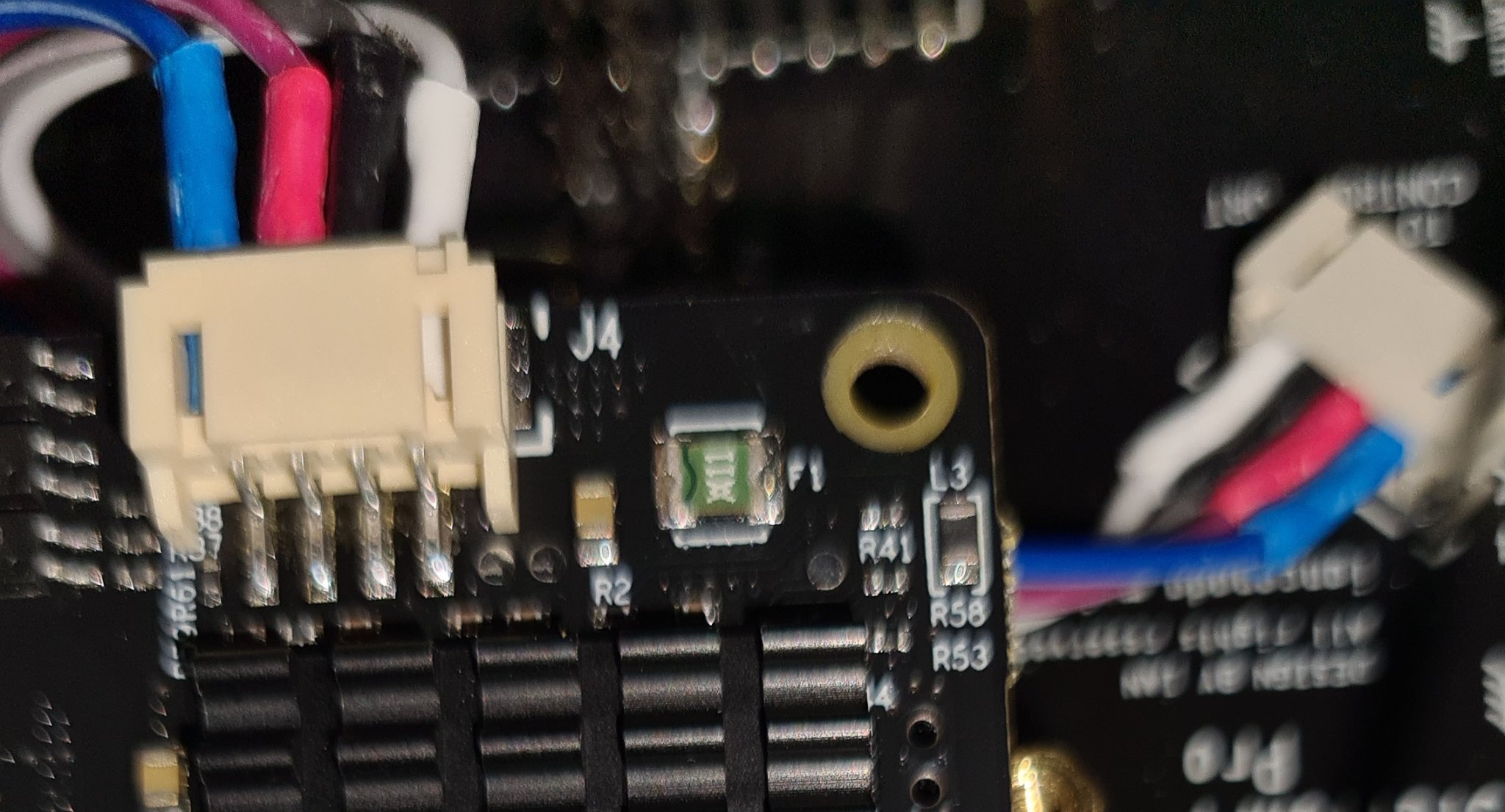

Yes, pH2.0 4PIN 1-1, 2-2,3-3,4-4
Really? In Your docu pin 2 on the Q7 is RXd and 4 TXd, same on the StationPro side... Should not be TXd crossed to RXd and RXd to TXd?
My problem is that i don't get information from Q7 to the LCD (Buttons for Input sources working find and MonitorPi works too incl. all infos, but no data from Q7 on the LCD)
Andreas
Hi Advr, can you make a photo of your control cable between Q7 and StationPro? Are really all cables straight trough ?
Andreas
Hi Andy,
I used 4 individual cables as shown. The all 4 make contact. Could be they are wrong connected?
Ad.

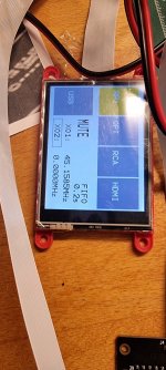

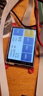

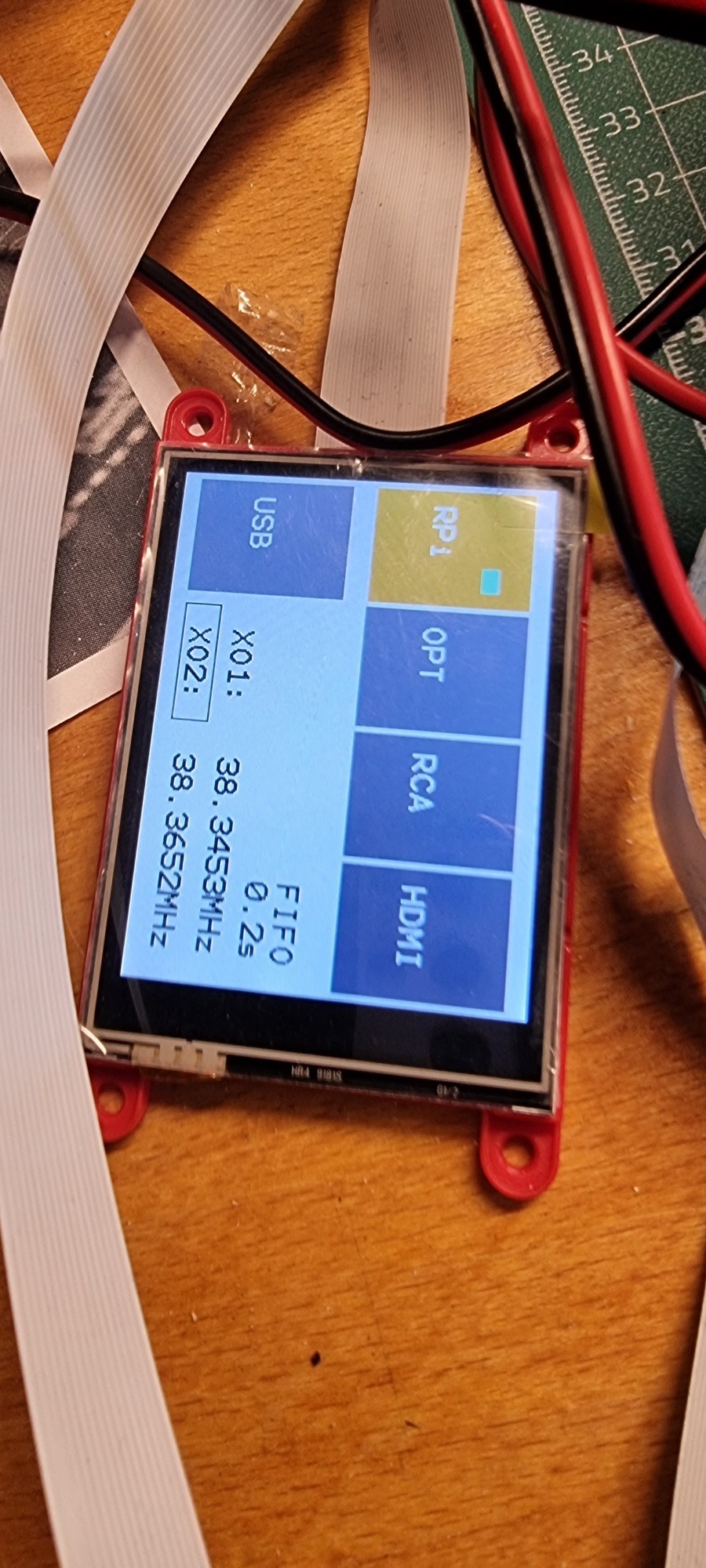

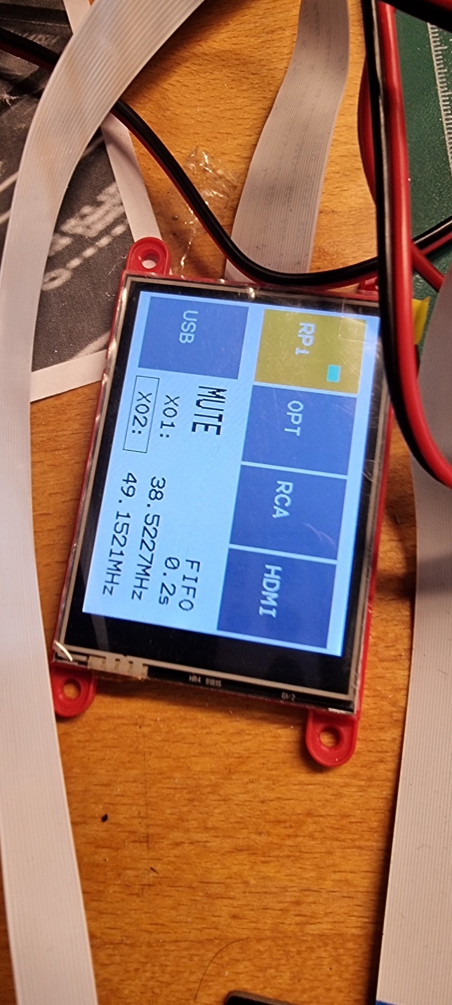

Hi Ian,
i try with FifoPiQ7 and Dual Mono ES9038Q2M DAC in sync mode (X0 removed and DAC MCLK connected with Q7 MCLK).
When i leave the original clocks in Q7 all is ok and i see on the LCD Display totally proper clock MHz.
When i use ACCUSILICON AS318 45 and 49 MHz on the display is 38.3453 and 38.3652MHz
When i use ACCUSILICON AS318 90 and 98 MHz (already without OE Pin 1) on the display is 0.0 and 0.0 MHz + MUTE
When i use ACCUSILICON AS318 98 (already without OE Pin 1) and original 45 MHz on the display is 0.0 and 45 MHz + MUTE
Any ideas ?
Kr
Andreas

Cut the AS318 Pin 1 (OE Pin) has helped !
