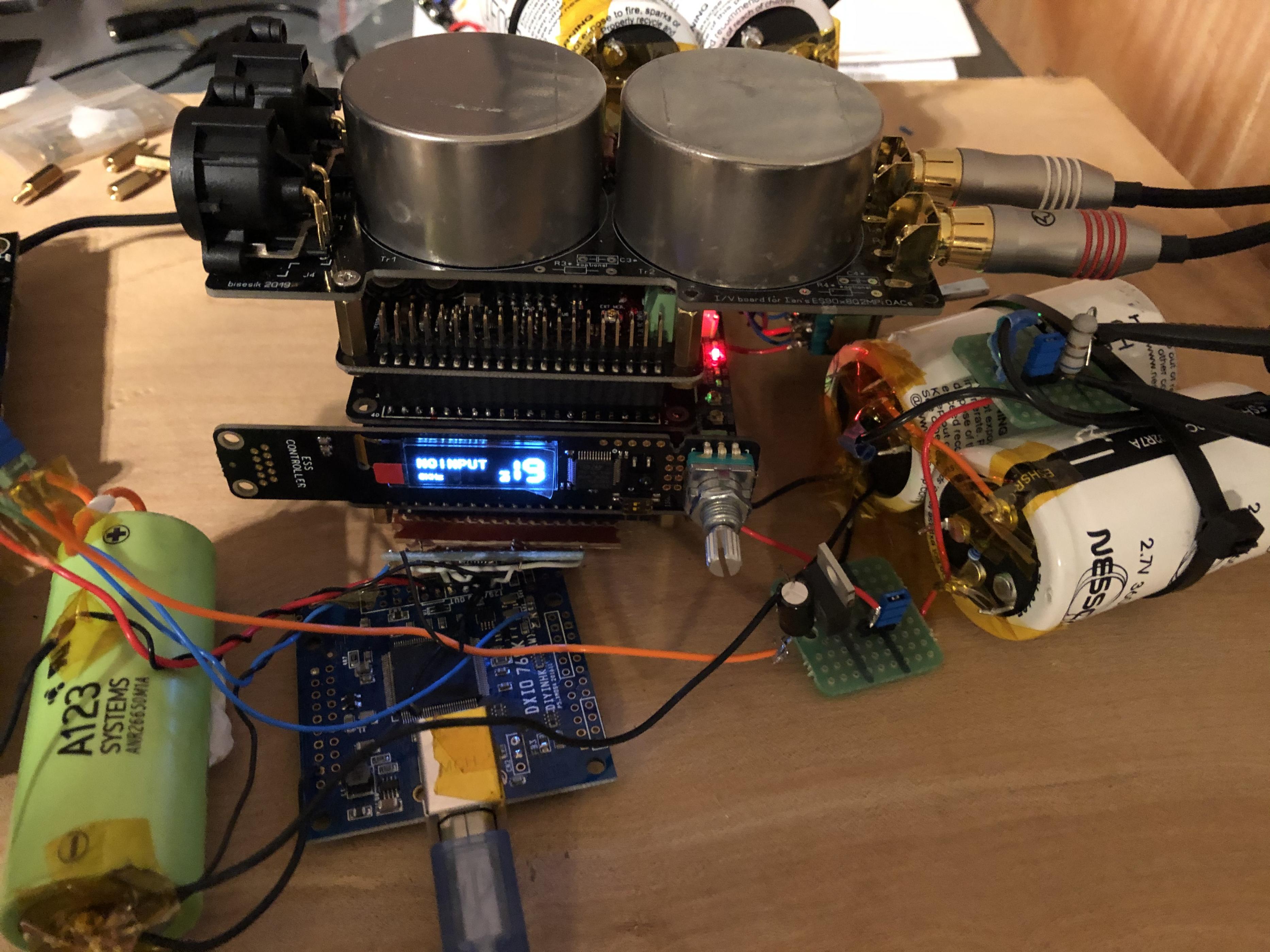

The ShieldPi is basically a board with a ground plane, to shield the noisy boards from the DAC and output hat.
V2.0 adds a cutout to be able to remove the oscillators from the fifopi more easily, if I understood some previous information I found on the subject.
Attached is a relatively recent picture of my stack, with the original ShieldPi between the fifopi and dac.
I think it does remove some ultrasonic harshness, the stuff you can't really hear but can make a system fatiguing. Or maybe its all in my mind lol.
I'm not using a pi anymore, little board in front is a usb to i2s converter which is wired into the dirty connector of the fifopi.
Battery on left is for the converter, ultracaps on the right is to generate 5V for the fifopi.
Ultracaps in the rear generate clean 3.3 for the fifopi and 3.3 for the dac.
I plan to make a couple more ultracap 3.3v supplies for the dac. I also want to try adding lifepo4 batteries in front of the ultracaps, and see if it makes any difference.
Also attempting a diy version of an i2s terminator. Will see how that works.

Thanks randytsuch, your answers are correct,
More information of ShieldPi V2 was updated here:
https://www.diyaudio.com/forums/dig...mate-weapon-fight-jitter-510.html#post5956035
ShieldPiV2_3
by Ian, on Flickr
Have a good weekend.
Ian

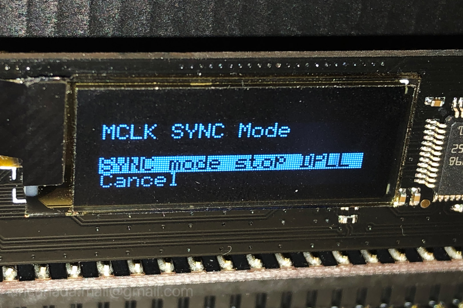

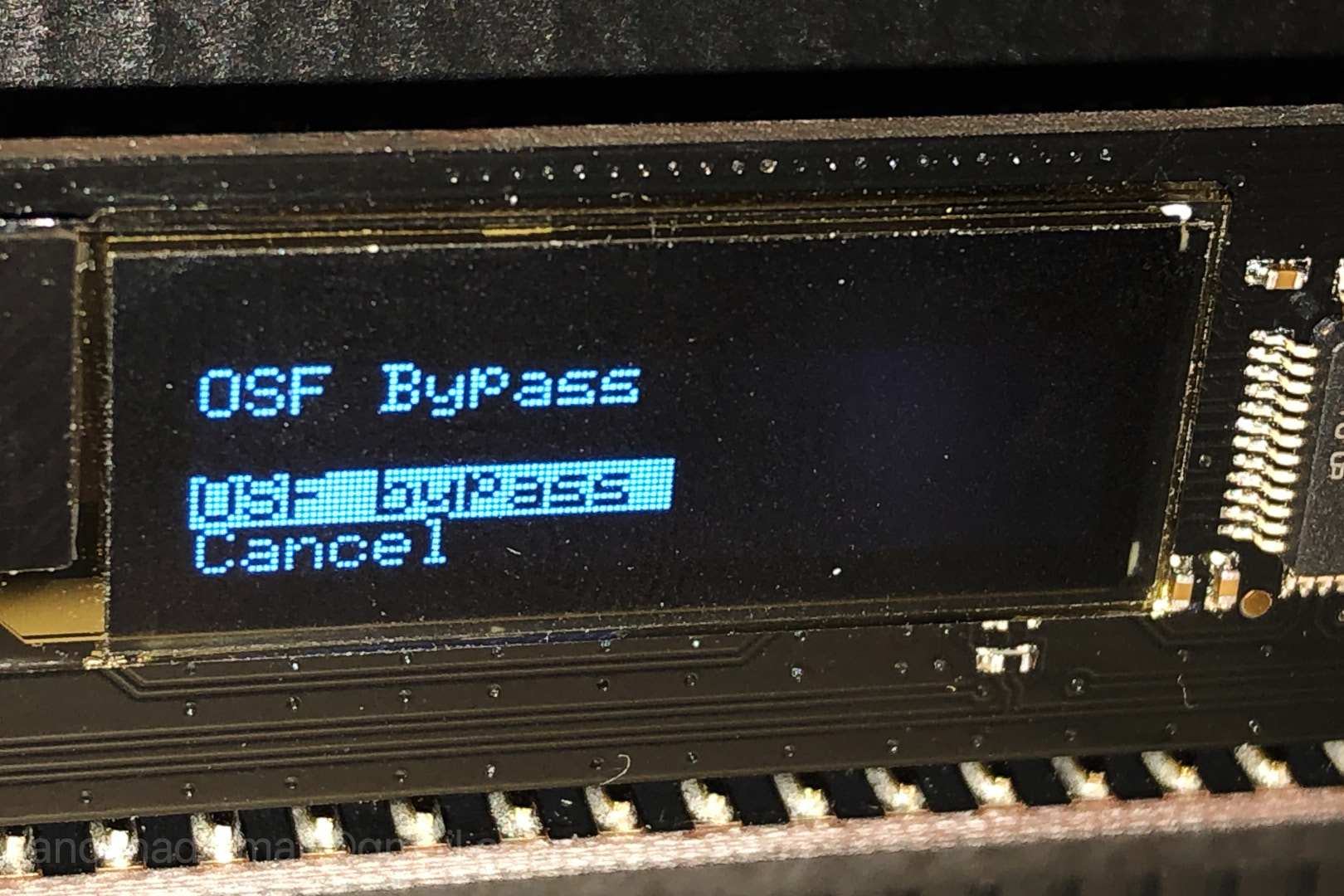

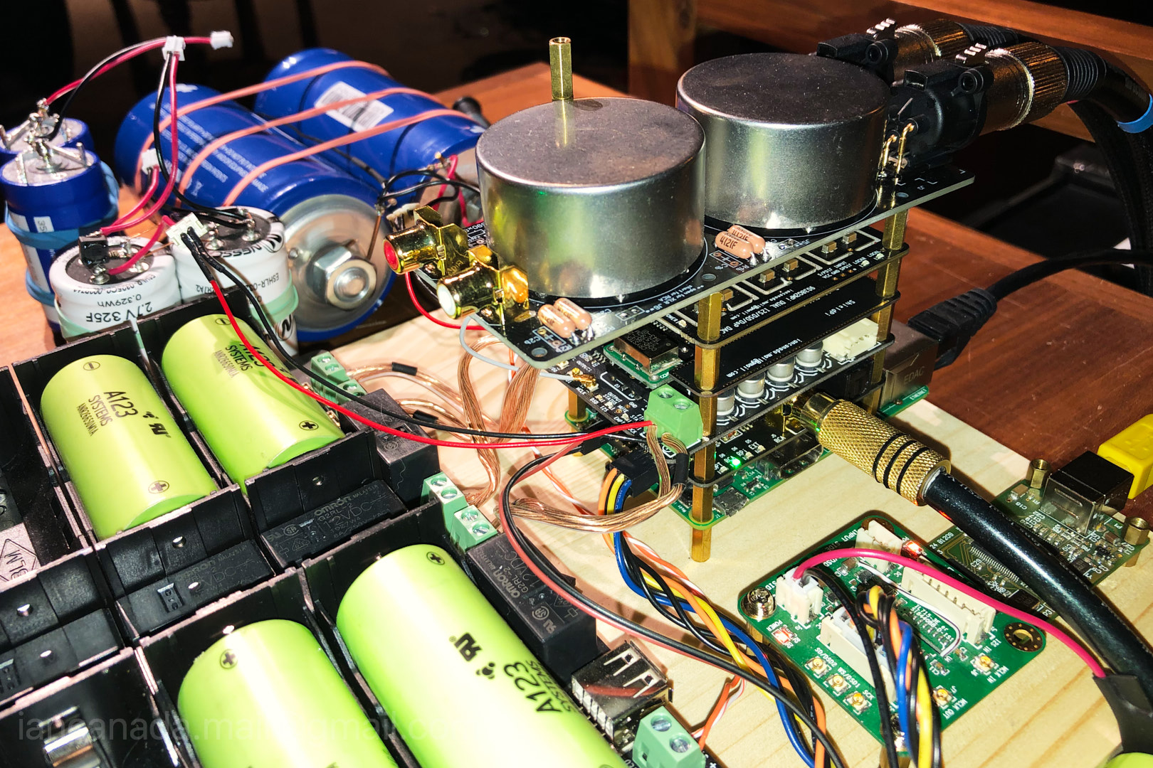

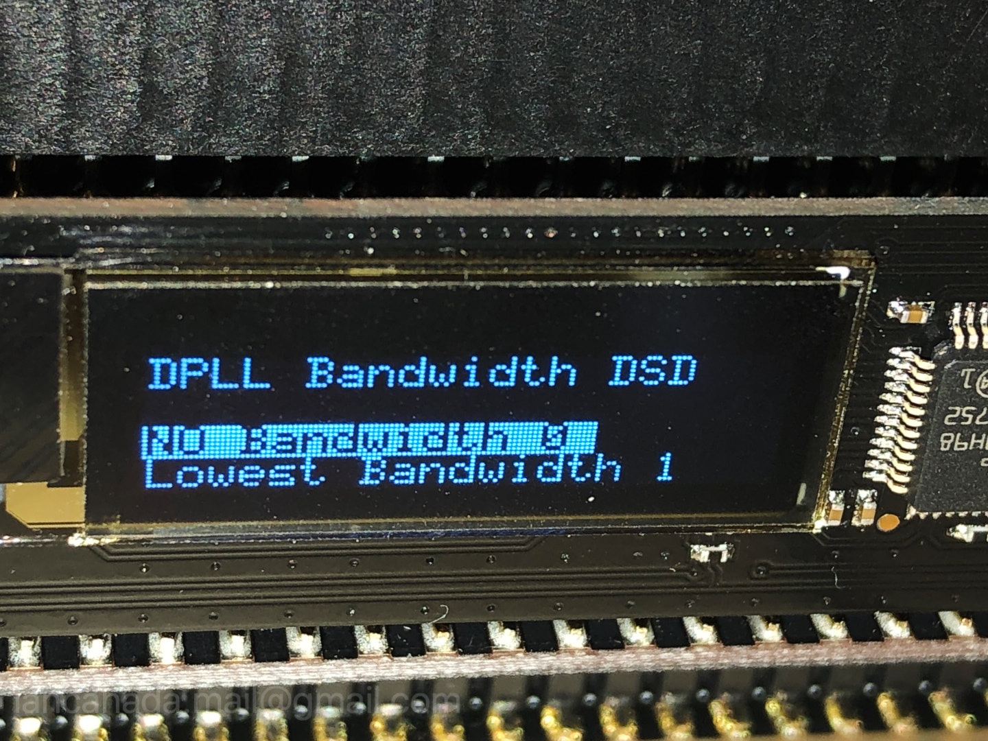

But the only problem I had was that the true sync mode doesn't work with DSD. Now, the problem is fixed. I know the reason and have the solution.
Some community members told me that they can run DSD at true sync mode with DSD bandwidth 0 and DPLL stopped. But I tried many times without success. The other day Vin send my a picture of his system running DSD at this mode. I was wondering why.
One day, I occasionally up-sampling the DSD64 to DSD128 for my Roon endpoint, I found I had no problem with DSD128 music at true sync mode(45.1584 MCLK). I suspect it must has business with MCLK frequencies.
So, I changed my XO frequency to 22.5792MHz from 45.1584 or 90.2168MHz, and set DSD DPLL to 0 with DPLL stopped. OSF can also be set bypassed. I make it! Both DSD64 and DSD128 works perfectly at true sync mode. With Crystek CCHD957, my ES9038Q2M dual mono DAC sounds amazing. My DSD music never sounds as nature and analog as this. Roon, Volumio and all other software do the same. I have a LINN sound tracks in SACD iso format. I played the SACD image file by Foobar2000 (with DSD plugin) in native DSD mode through my Amanero USB streamer (also with ReceiverPi). The sound style was very close to a Vinyl record but just without the noise (with Bisesik transformer I/V).
So, the solution is simple: use 22.5792MHz XO for DSD64 and DSD128, or up-sampling music to DSD128 to use 45.1584MHz or DSD256 for 90.2168MHz.
I believe the sound quality still has room to improve if using better clock. Just hope I had a 22.5792MHz Pulsar OCXO. Too bad they were discontinued.
Ian

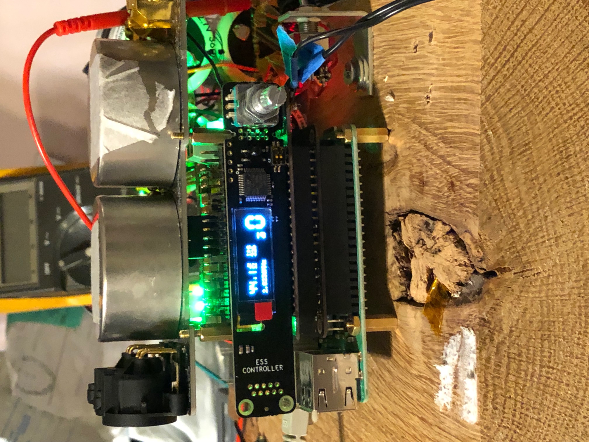

My sistem work in true sync mode with dsd64 and NS 11.2896 clock. My problem is with Ian's 9039q2mdm, sometimes the dac loose the signal when i switch mqa to pcm or after pause i play and no work. I try 9038pro, is 3 weeks eun with no problem. No bump no loose signal nothing os all perfect. I don't now why. Ian i send the neutrino clock sorry but i try some things. This week i send you.
I feed my raspberry with linear supply with ultra low noise regulator, it's a big improvment!!
