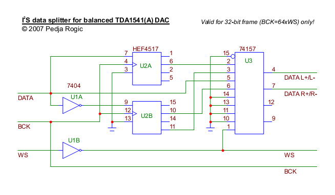

One further thought occurred to me - what about splitting the I2S signal & going differential to two DACs i.e one DAC process R+/- & the other processing L+/-.
Would this achieve the same result as galvanic isolation in that it would remove common noise? I don't suppose the simpler version of one DAC processing R+/L+ & the other processing R-/L- would remove common noise (as effectively or at all?).
Can it be done effectively at 24/192 speeds?
Has anybody got any experience in using i2S balanced?

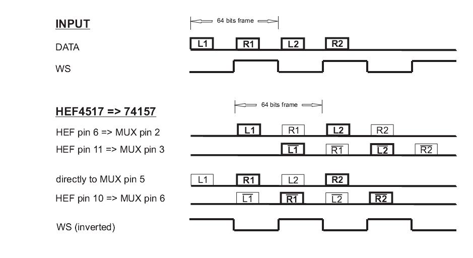

There is a Pedja Rogic PDF attached which shows how to split I2S for R+/- & L+/- use but it uses a discontinued chip (4517) & it is directed towards 16/44 operation
  • I2Sbal_split.pdf
Thanks for sharing that schematic, its helping me with a design I'm currently thinking about:D
The HEF4517 is still in full production according to NXP, however from the datasheet that circuit isn't guaranteed to work, though typically it will. It could never be made to work at 192kHz since that requires a bit clock frequency over 10MHz. Increasing the supply to the 4517 to 15V might do the trick though, then level shifters will be needed...
In any case I don't at the moment see how this circuit might take the place of galvanic isolation. If you've got ground currents, once they've been translated into noise at the bit-clock receiver, there's no way to undo the damage. That's because the generated error from the jitter is data-related - a jitter error when you've got digital silence is a different matter from a jitter error at full scale.
