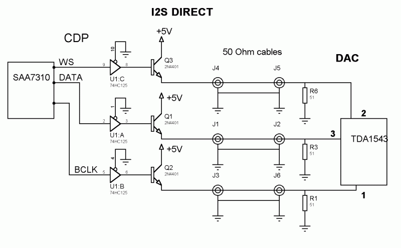

I'm referring to an old thread on this forum..tapping I2S from a cd..exactly it was a Cd 940..
I would like to do the same with something like a CD304 MK II..or similars with CDM1..
What do i need to pull out I2S signals..?

Watch out, there aren't many players that are similar to the Philips CD304 Mk2. Most of the players that used a CDM-1 also used the SAA70x0 chipset. If you want to get I2S from a CDM-1 CD player, make sure to get one with the SAA72x0 chipset. The following players that I know fit this criteria are:
- Philips CD304 Mk2
- Philips CD960
- Marantz CD-94
- Studer A727
There are probably a few more, but the combination of the CDM-1 laser mechanism and the SAA72x0 chipset was a rare one.
If you get hold of one of the above players, tapping the I2S is easy. Use either the DAAB, CLAB and WSAB pins on the SAA7210 if you want to go the NOS route, or the DABD, CLBD and WSBD pins on the SAA7220 if you prefer oversampling.

Every single player using a SAA7220 uses I2S, as that is the only input or output format that IC accepts / provides. Not all players using a TDA1541 use I2S, but most do.

From one late post..i got a scheme from Elso Kwak about I2S tapping..i post it..is it needed after the decoder..?
It is better to reclock the decoder..? Or upgrade the existing one with a new one from Tent..Kwak..or..others?
