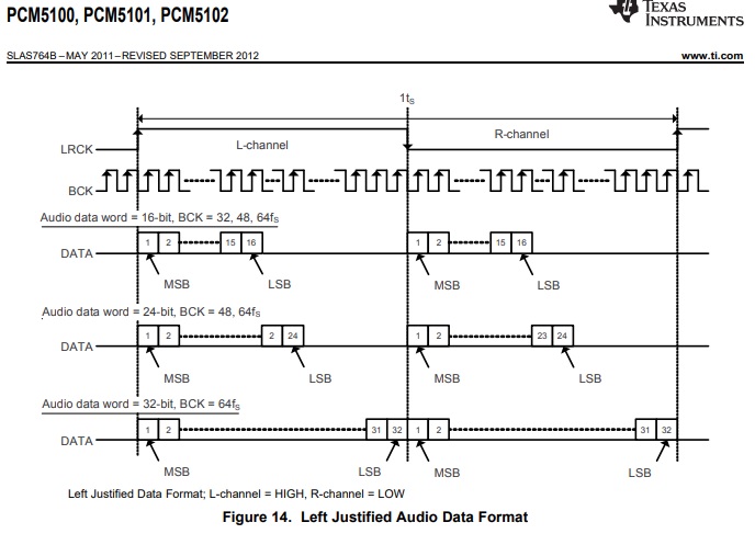

ok one again.
source device have to setup left justified and i do not change it (for test and for end install to target dac).
For test i have two dac do not support left justified.
I need convert left to right to allow test audio path.
Second issue, i like to connect for target device other player (source) but this also has no possible to setup left justified (i need convert also).
So converter will be great for test audio path and connect second device to target.

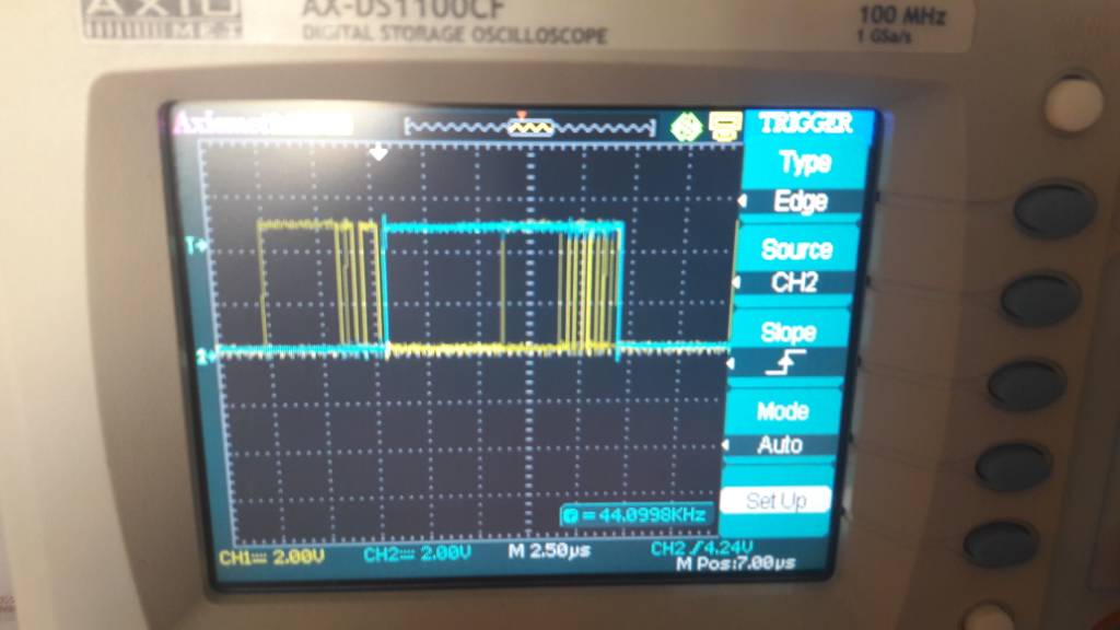

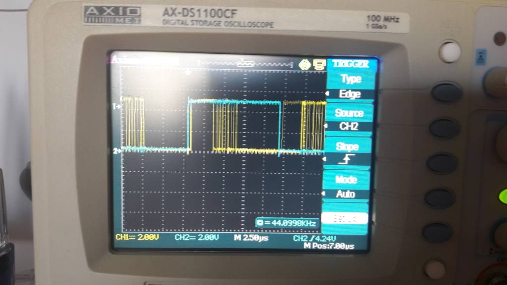

Ws blue,data yellow.
406 and 407 setup source signal.
