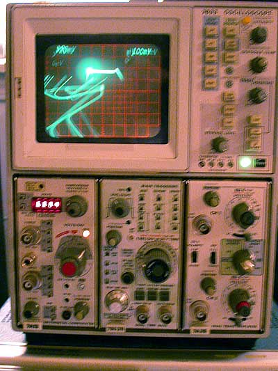

Terry I just got a faulty Tek off ebay too, Dont mean to hijack your thread but wanted to know if some expert knows whats going on with my 7633... it displays squiggly lines that flicker with no input ...
Any ideas?

Terry,
There is really no way to test the CRT on one of these scopes externally. Some of the older scopes had a beam finder button. Pressing it put a dot on the CRT so the horizontal and vertical controls could be adjusted easily. I don't recall if the 455 had that button. If it does just press it and look for the dot. You may have to adjust vertical and horizontal positioning a bit. If there is no beam finder button, make sure that the trigger MODE is set to AUTO and the SOURCE to Channel 1, LEVEL to about 50%, TIME/DIV to 1 millisecond and the VOLTS/DIV to 1 volt. There should be a trace on the screen at this time if the scope is working. Oh, don't forget the intensity button and the horizontal and vertical controls to position the beam.
