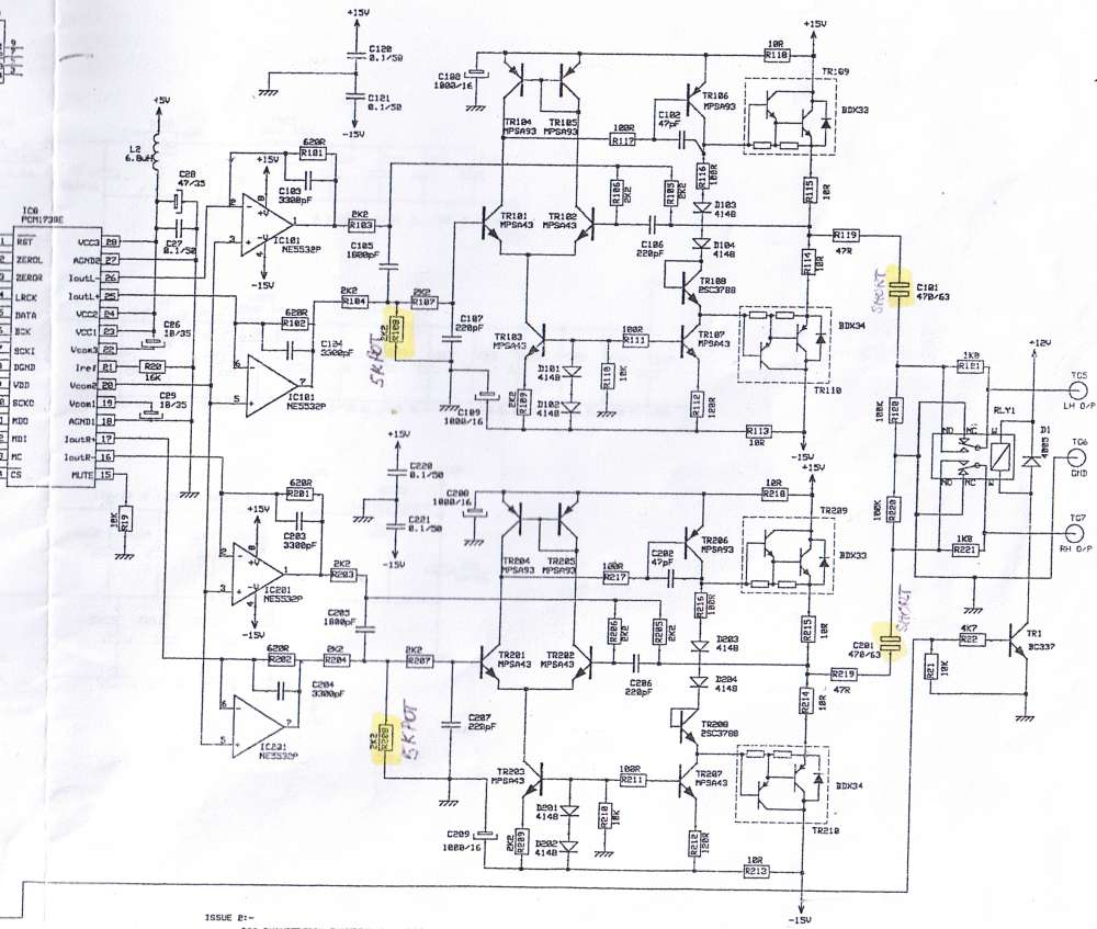

Anyone have any experience with this for I/V and output stage substitution, will it work in my dac (attached) ? Is it any good?
I can't work out the inputs to the Borbely circuit for the dual dif output of my dac.
http://www.borbelyaudio.com/eb604417.asp
Cheers George

Anyway can anyone give me an answer to, if the output of my dac (+- Left and +- right) can be wired up to this Borbely board, no matter how many times I read the (General Design Information) I can't make sense of it, there is from what I can see a - input through R12, but no + input, they talk about the +input (R2 grounded) but I cannot see what their talking about, I do need sleep, maybe that's my problem.

rfbrw thanks but I was hoping that was not the answer, as to two of them is out of the question at 380euros, is there somthing else that's good pre-made like this that would suit my dac?
I've seen the LC Audio Zap filter MkII but that is dearer here in Australia, and I've heard too many problems with this, and do'nt feel confident in it. And looking at their instal options below it may not be suitable either.
