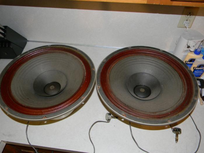

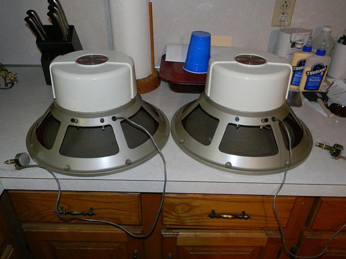

Thank's Freddi, Yep they're those you have pictured in the middle with the big white magnet covers and that L-pad adjustable knob thingy . Mine have just a little 1/4 tear in one of the cloth surrounds the other cone is fine but the surround isn't setting perfectly flat, it's got some wave in it. other than that they look great. Here they are sitting on my kitchen cupboard.

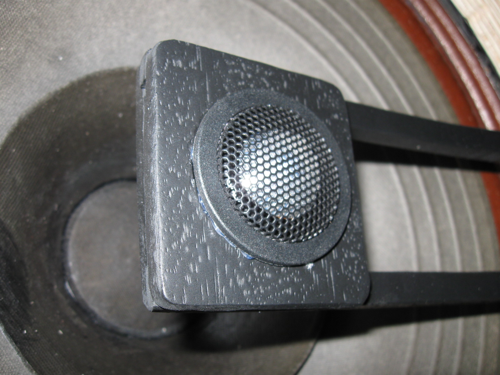

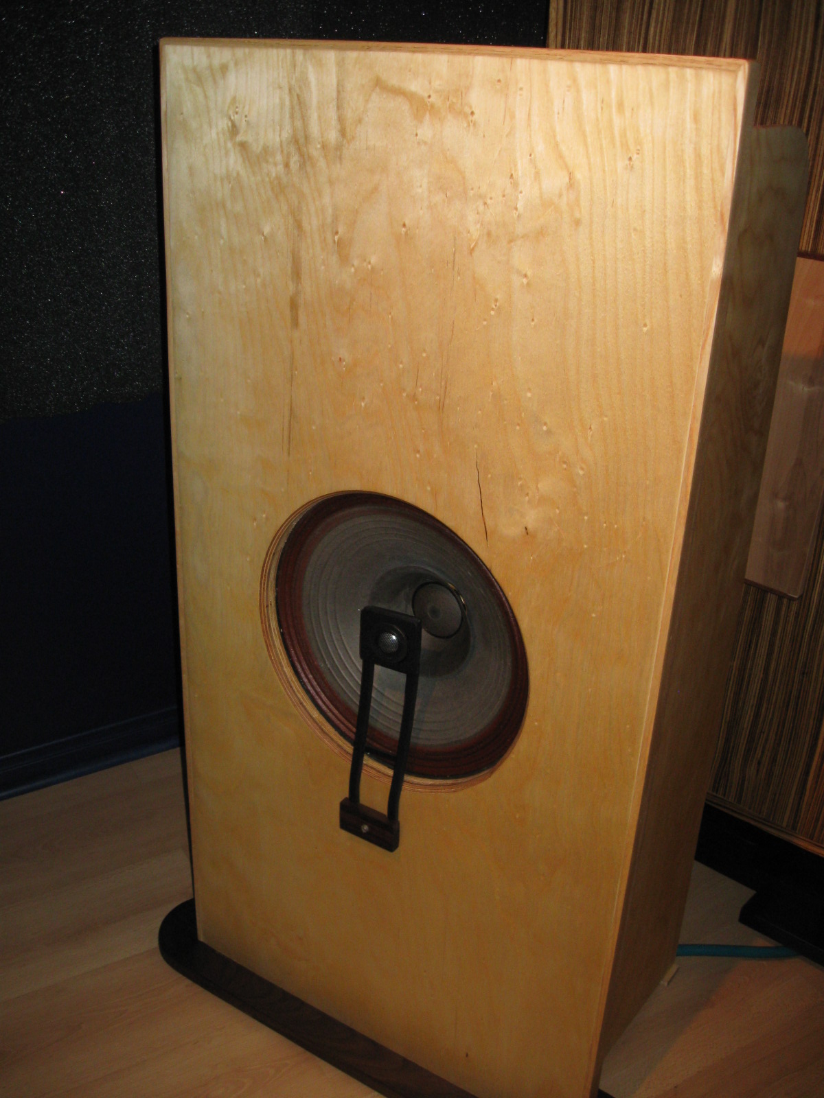

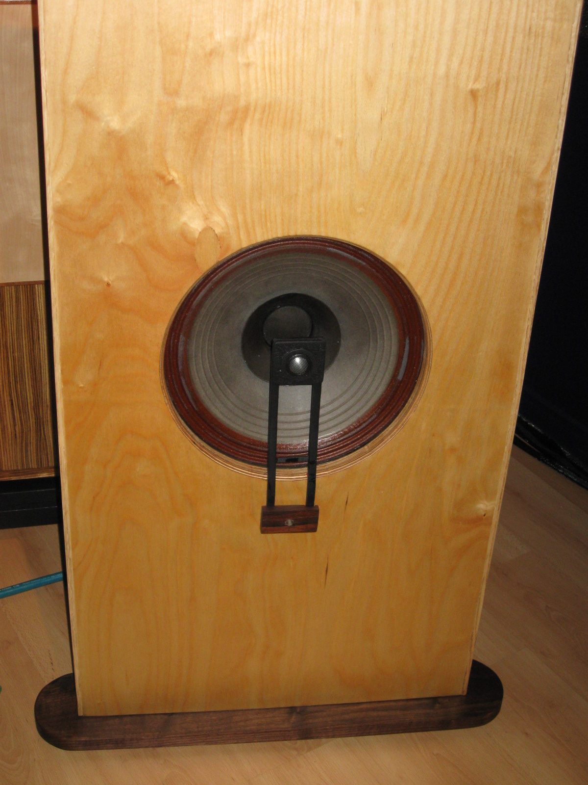

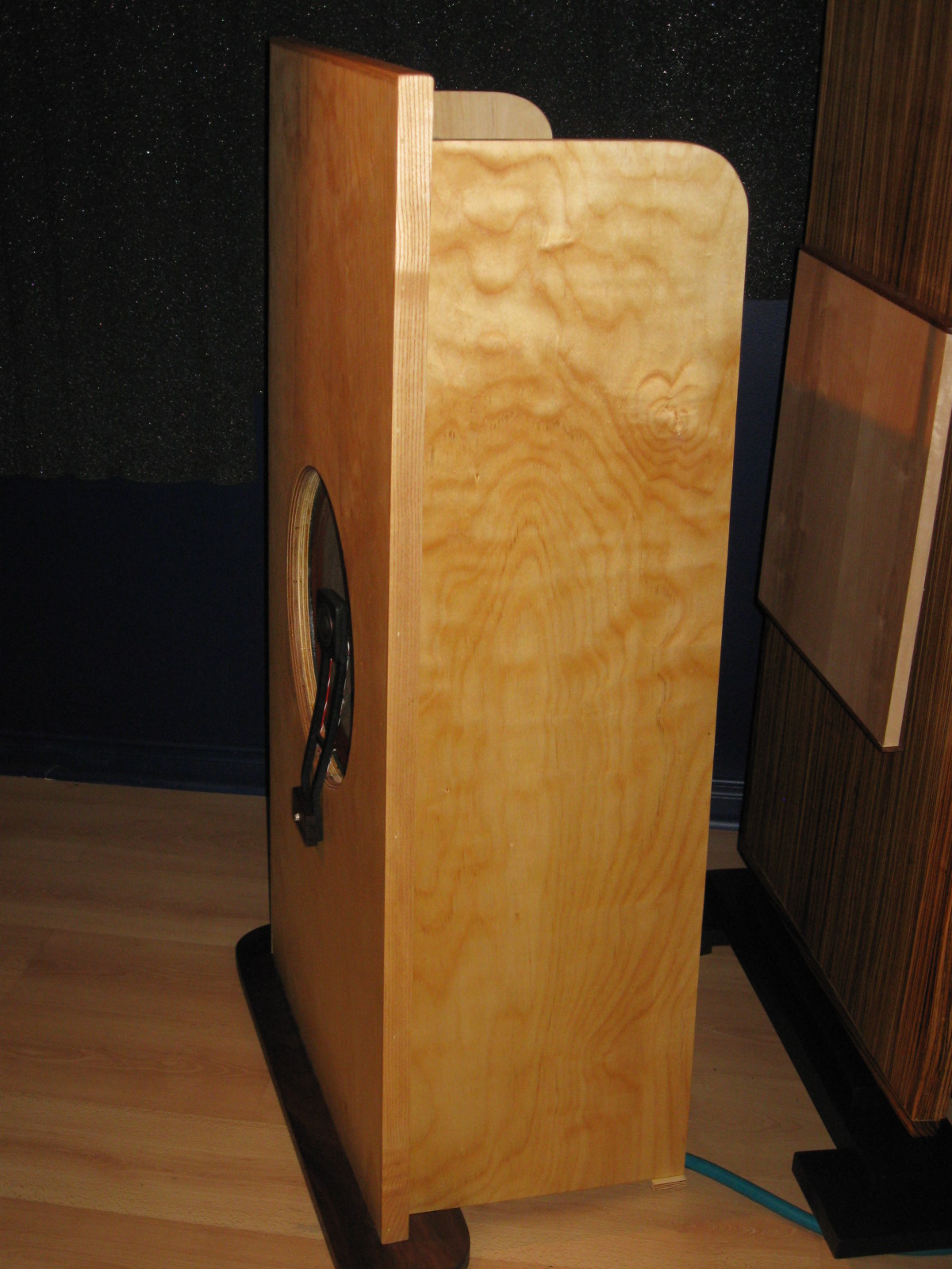

Hello, i did an open baffle with my SP15. I did bypass the resonant circuit inside for raising the HF response-i did not need it im adding a tweeter anyway-
sound wise it is surprisingly great. Midrange is so live and OB makes them have great sound.
Extreme LF of course is not there, but todays subs are plenty available to add if you want it.

Hello Freddi, nice to read your post again here......
first i removed the brillance circuit that is 0,20mH and a 2,4uF those are in series with the wipper of the brillance pot connected to one side of the 2,4uF
The pot is 100ohms 5 watts.both sides of the pot are on the plus and minus of the SP15.
That done i knew i used the SP15 as a two way design.
My tweeter is a LPG 26N neodium magnet 92 dB/w/m eff.
Since the SP15 really shoouted stronger, i did use a series resistance with the SP15.
That plays two things, changes the QTS actually raises it, it's an Ok thing for open baffle and trim down efficiency to match my tweeter.
I know that the other way reversed, you trim or pad a tweeter/midrange to match an inefficient woofer, but here it proved to be the solution.
Ididn't wanted to have a 10cu.ft. boxes-i had Altec's 18's in the past- but use a very good driver in OB.
Franly it's great and a fraction of the cost of my PHY-HP.......
Crossovers had to be 6db/oct. for minimum phase error, so i did spread the filter points a bit.
SP15 low cut at 1KHz, and tweeter is 4KHz.
Yeah i see people read this and have questions, in fact the SP15 with the wizzer even so responded quite well to 2KHz:rolleyes:.....That make some experimenting with inductors and caps a challenged.
With 845 SET's amps on 8 ohms taps it's so magical! This amp is sensitive to complex impedances curves.
Updated Dynaco ST70 really sings.
I also uses a Sonic Frontiers power2 at 130 watts per channel, only to have more control.
Low freq, responses go low about 45Hz.
With a good matched sub you have a great system.
